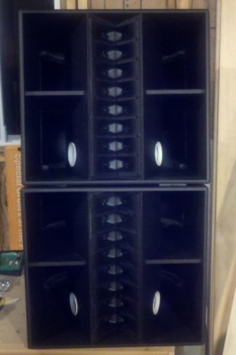

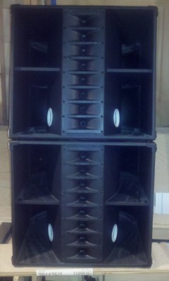

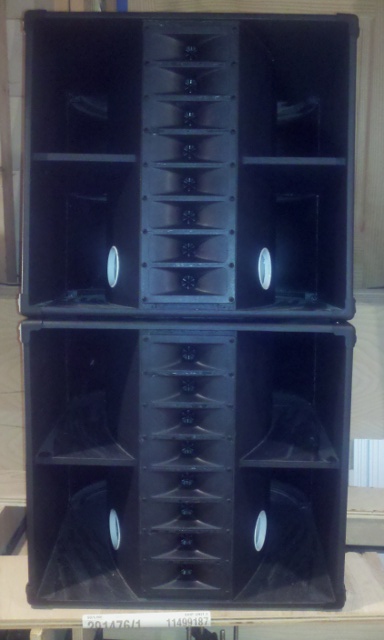

Here are some pictures of the almost finished cabs. Sorry about the low quality cell phone pics but I left my camera at work last night. As you can see I still have a few finishing touches to do. Corner protectors, clean up the flat array with acetone, clean the dust off (you can see lots of dust in the pics), route a 3 degree circle and install tophats in the flat arrays (for now they have flat covers and no tophats), and add diffusers. I finished to late last night so tonight will be the blasting session
Next up will be 4 T39's. I have a pair of Lab12's and a pair of BP102's. I am thinking of making 24" cabs for the Labs and 13" cabs for the BP's. As I add more cabs in the future they will be done in pairs of Lab12's. I have a need for 1 slim pair and that is the reason for the BP's.
The third pair of DR200's are ready for the finishing stages but I still have to make melded arrays for them. I will hold off on these until the T39's are done. They can all be Duratexed at the same time. I also have to evaluate the B&C 8PS21 woofers that I used in the DR200's to determine if I should get 2 more for the last pair of DR's or if I will need the DeltaPros's. To evaluate I will compare them with Beta8's. I have 4 of them for wedgehorns.
