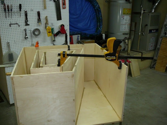

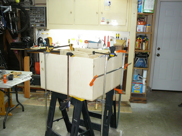

Its mostly the screws that are holding it together and clamping it tight. The clamps are mostly there to try and help deal with the warping of the wood. I only put all of them on at the end of the night when I know its going to sit for a while. I think you might still want to invest in a few. The orange ones I just bought at Home Depot. They were $15 for a 36" clamp. Turned out to be cheaper than buying a pipe clamp in the same length. The rest I've accumulated over the years. You can never have too many clamps!

Oh, I know about clamps. I have quite a few. All of them too short, too long, too big, too small or what have you. :cussing:
So far I've used quite a bit of screws, but I'm looking forward to the brad nail exercise. I've used it once now for building a quick piano stool for my daughter. Quite the tool, I'd say, and well spent money.

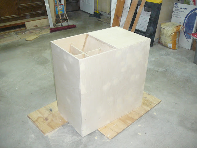

Last couple of panels done. Just need to cut and install the last brace then its time to close her up and see what she can do.
Using the spreader to keep the last panel square. I like this clamp a lot. You can switch it around to be a spreader real easy. It's come in handy.

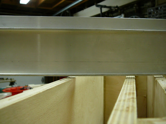

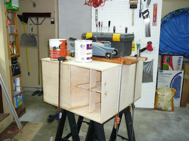

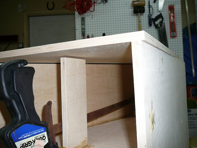

"All right! Last brace is in place, time to put the other side on! Hmmmm maybe I should check to see if all my panels turned out the same width."
Ruh roh.
Shiiiiiiiiiiiiiiiiiiiiiiiiiiiiiiit.
Son of a....
At first I got out the belt sander but after about 5 minutes of that I started getting worried that I would do more harm than good. I decided to trust in the screws to pull it tight in the middle and the PL to do its wonderous expanding trick.

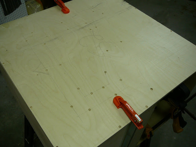

Added a few extra pilot holes and countersinks.
Read a good tip in myn's thread to use a couple of dowels as guide pins to hold the side while it gets screwed down. Worked really well.
All clamped up. Little extra weight for good luck.
Tomorrow I'll put the driver in and we'll see if it needs to get painted or it needs to be converted into firewood. That gap in the mouth was the worst and it had a good amount of squeeze out after all was said and done. So I'm thinking happy thoughts.

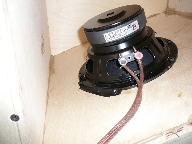

Holy crap it works! Can't wait to get it inside and set up on the real system.
I found a leak around the driver that was easily taken care of. Astonishing what an immediate difference it made.
Used some electrical tape to fix a leak because I'm pretty sure I'll take the driver out so I can clean up in there a bit when I'm finishing it.
Cross brace is crooked and main brace is off center. :lol: I don't care, it'll be facing the wall and I plan on putting a grill over it too.

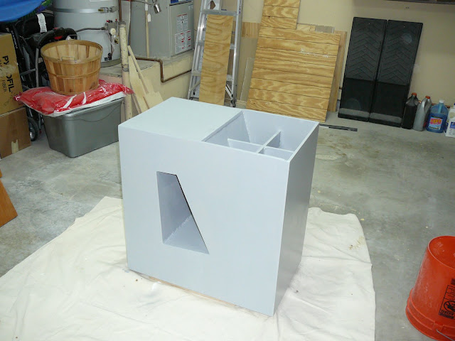

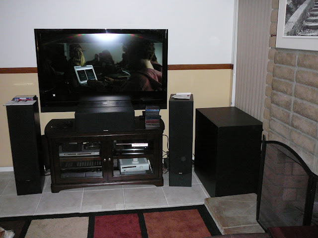

It was nice and warm this weekend. Paint dried fast so I was able to finish and get it back inside and hooked up. All I can say is thank goodness for the flush cut bit and flat black paint. Hides A LOT of my mistakes. :-)
Holes patched and sanded
2 coats of primer
2 coats of paint. Didn't turn out as smooth as I would have liked. Should have used a foam roller.
In its final resting place.
I've still got to build a box for the amp and some grills. I've got an idea to use some shoe molding to keep the grills nice and low profile.
