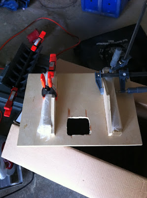

Ok, more pictures and more work done. The aforementioned crossover:
The melded array and diffuser, glued and clamped, and the back panel, trimmed, jack plate cutout, and braces glued and clamped:
And lastly, a half-inch square frame for a petscreen grille:
The front inside of the cab has also been primed. Then I realized I still needed to round corners and so left that off for now.
After the diffuser is firmly attached, the array can be painted, and then i can wire up the piezos. The end is in sight.
