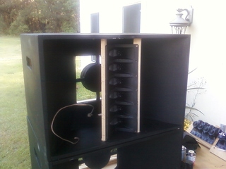

Well the first coat of paint went on my OT12's today...finally. This build has really been spread out over several months.
http://www.flickr.com/photos/monoheadph ... 626473602/
I put them up on stands...it's gonna take some getting used to looking at these little things after having my old tops that are about double the weight and size. Two stacked together looks alot more like what I'm used to.
This is what's left:
Cut, assemble, wire and install piezos
Install and wire crossover
Install batting
Install back panel gasket
Break in and install woofer
Wire and install jack
Install top hat
Install chevrons

Looks great.....coming to the finish line.
Do the duratex....turns DIY into "What brand are those?"

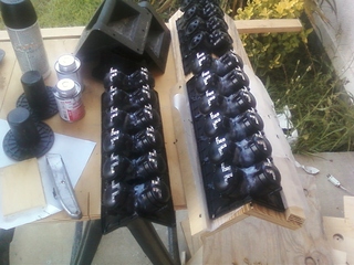

Here's what I did last night.

Thanks Mike. Tomorrow should be mounting everything and the batting and wiring the piezos, possibly installing them too. I'm so excited to hear these things. Been a very long time coming.

If you haven't heard the piezo arrays before, I think you'll get a smile. Just apply a little eq to tone done the top end on them and the cymbals and high hats will truly shimmer. Of course, the 120 degrees of dispersion doesn't hurt either :wink:
