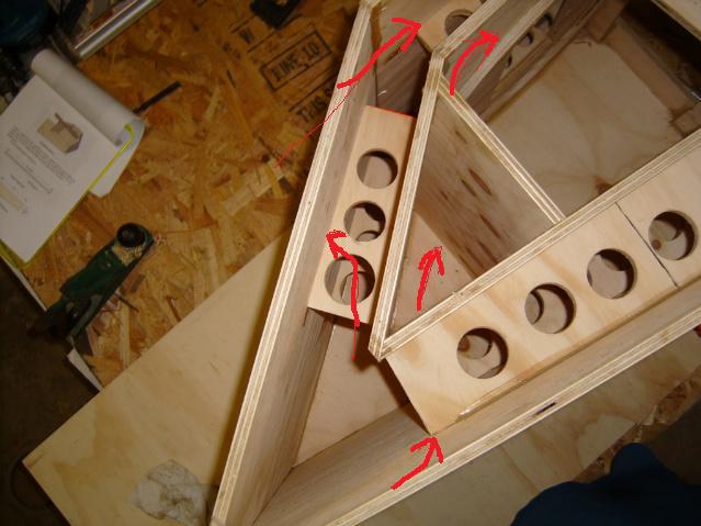

I'm not sure what you are seeing, but it looks like there is plenty of PL squeeze out to me????djtrumptight wrote:Back to the topic,dude,if i was you,i would go back and add PL to all those braces,all around the driver spacer ring,everywhere where u have joined 2 pieces of wood because from what i see you are gonna get some rattling.

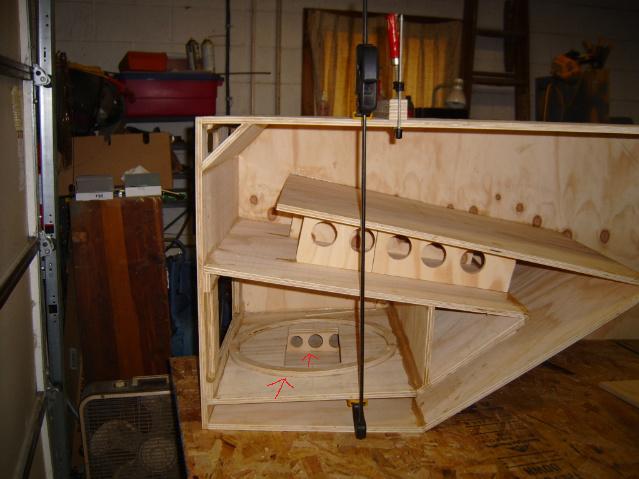

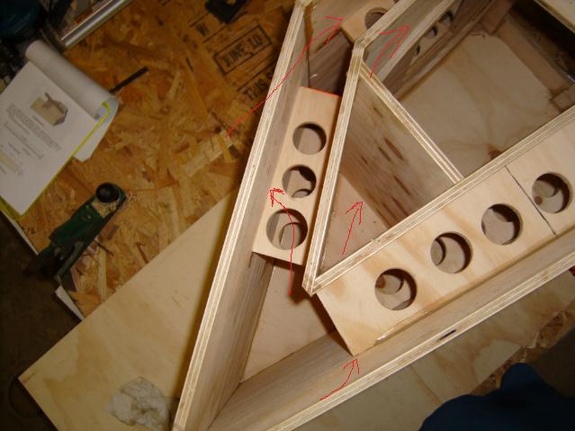

im talking about the spots i pointed out where the PL appears to be thin as well as on that brace where the PL doesnt go all the way to the end,they could cause a rattle:
Also on my T48's,i put PL all around the outside and inside edge of the baffle spacer ring and look at that brace thats right in front of the driver baffle,thats a major rattle.I had to remove my driver after assembly to add more PL to those braces because my T48 was sounding nasty,instead of boom boom boom it was twang twang twang:
Its best to glue the cab up in a manner that leaves you confident that its air tight as opposed to having to run all around the cab trying to locate an air leak.I just took my own advise with my 2nd autotuba,finished it,no air leaks,makes the building process much more fun.

I can't see well enough in those pictures to be able to tell how much squeeze out there is. You must have better eyes than I do.

thanks for the advice on adding more pl i see the point better safe than sorry. i am going to have a hard time getting to the lower braces, maybe i will enlist my buddy with little arms for that. good thing you guys caught it now my next step is run the power wires and then it is seal up time. i am very anxious to see how this thing sounds. in my little ass garage it should be crazy loud with just one. once they are both painted up i am going to clean out the garage and have a party in there. will be a super late b-day/the-subs-are-done celebration. definitely going to invite the guy who runs the local venue too "grin face"

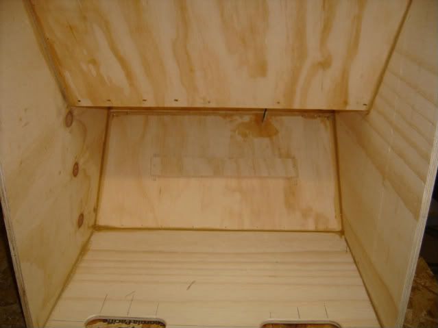

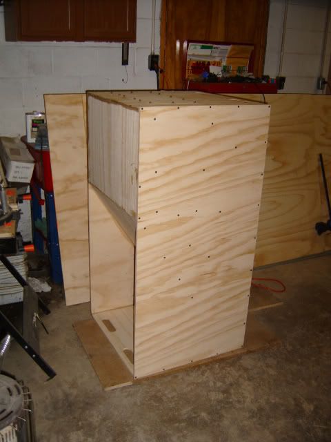

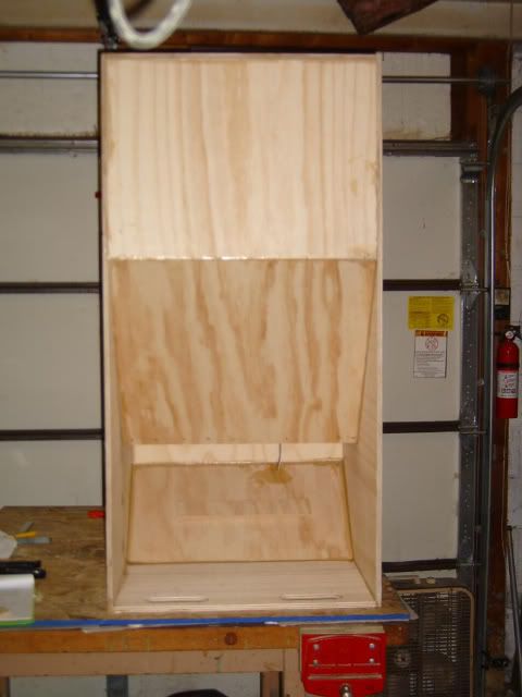

i have some more updated photos for you all
all i have to do is round over the corners add the front bracing which i will do after i paint the horn mouth paint the cab and add the corners and it is done. i plan to do the painting when i am finished with the other so i can clean up the shop and have a good environment for painting.
i did start the 2nd cab i am as far as having panel 2 glued in and panel 3 and 4 cut and ready to glue in.
