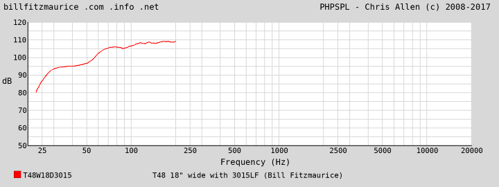

Here is a graph of an 18" 3015 T48. Nice output up to 50 hz, but hang onto your hats because then it starts to take off and then hold fairly steady from 70 to 100hz!
