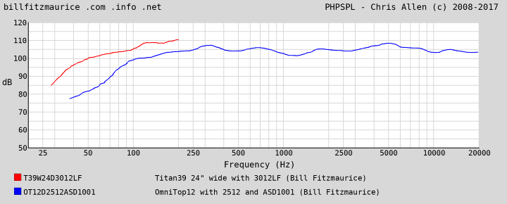

After 2 cold ones :idea: (in my case light bulb) So what you guys are saying is that you take the max wattage of the driver convert it into volts and then db and this is what you add to the chart when comparing max output?
Srx + 30db
2 T39's vplated 9 + 26=35db
sine143 wrote:85 volts is 30 db, 50 volts is just shy of 26. speaks for itself right there. If the jbl is percieved as louder its because of the inherent percieved higher volume due to harmonic distortion?
Text book wise is this correct?
What converter are you using, this one does not equate to 85v = 30db
http://www.sengpielaudio.com/calculator-volt.htm
Posts: 28955
Re: Introducing SPL Chart
#272 Post by Bill Fitzmaurice »
pumpsfast wrote: What converter are you using, this one does not equate to 85v = 30db
There is no direct relation ship between volts and dB. You have to convert to power. 2xPe=3dB, 10xPe=10dB, 100xPe=20dB, 1000xPe=30dB.
Maximum thermal power is moot, it's displacement limited voltage that counts.
So, what's next on the agenda, how many angels can dance on the head of a pin? :horse:

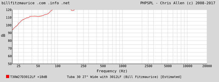

Would it be possible to get the T30W27D3012LF with multiple cabs of 2, 4, and 8? Thanks in advance.
Cheers.
2 x 21" T30's with Lab12's
2 x 28" T30's with Lab12's
chrisj360
Posts: 114
Joined: Fri Sep 20, 2013 1:37 pm
Location: Bellingham, WA
#277 Post by chrisj360 »
If I was to try to approximate the output of multiple T30's (I have the Lab12 loaded and I think the 3012LF is the closest match), I would just add +3 for each cab added like so?
And if I found myself in an ideal setting to corner load and v-plate, it would be +3 for extra cab and the v-plate and +12 for the corner load that would make it look like for a pair (+3 for the extra cab, +3 for the v-plate, and +12 for the corner load):
Four T30's v-plated (+9 for the cabs and +3 for the v-plate) and corner loaded (+12) would look something like:
Is this correct or did I miss something?
