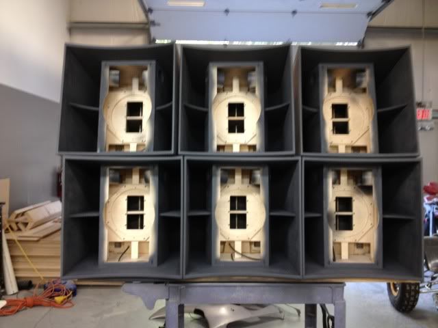

Here's a pic of them stacked the way they are going to hang in the club. I'm not quite sure how I'm going to do that just yet but I got an idea.. I might fabricate a steel tubular frame to hold them and actually mount it to the top of the stage..

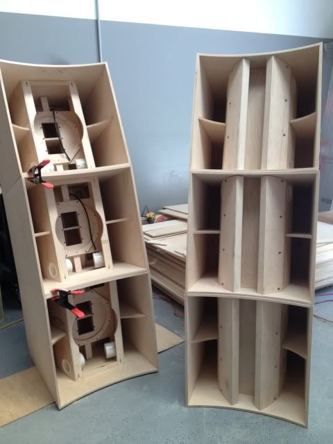

The curve looks great! But, doesn't it take away a little horn area. We're always very concerned with the smallest of leaks and I was thinking that taking away several square inches of horn area might affect performance. I've also wondered that about the handles on some of the subs (at least in older T39 plans that I have).

The inverted curve actually adds 2 inches to the side panels so the horn is a little longer. The center of the curve however is the same measurement the plans call for.

Holly sh!t I sanded my butt off today! 1/4 rounded all the edges and pushed them into the paint booth! Monday will be a fun day :hyper:
Also this pic shows I added a 1/4" top and bottom panels to hide the back halves.. I figured the extra weight wasn't going to kill me since these will be permanently installed..
