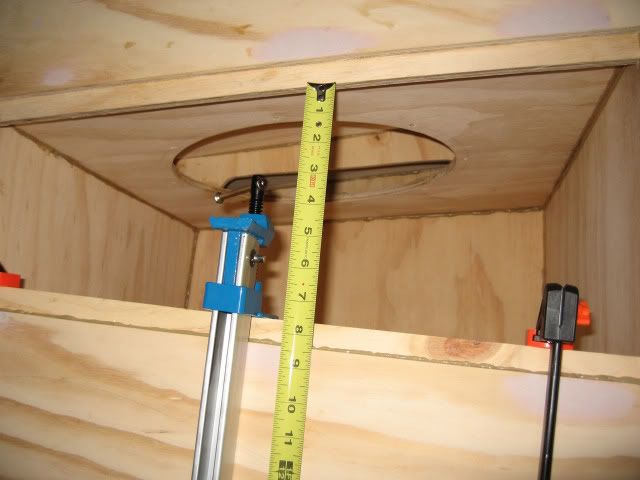

A couple of observations...first of all, did you flush cut the access hole before trying to glue in the flanges? The driver may have a tough time fitting in if you didn't do this first, as you will have to go a little wider on the flanges to have the desired flange ovelap.
If your driver fits in with the flanges the way you have them, then do not worry about this. when all of the flanges are in, secure the access cover on temporarily and sand the access cover down flush. That would be the easiest way out of this mess. Auraco is flexible and thick enough, and with gasket tape you probably will not have leaks (use two lines of tape, one iside the fasteners, and another outside just to be sure). trying to sand down just the flange will be difficult.
If you do not feel comfortable sanding down the access cover, then flush cut the flange and do it over....just my 2c

Dado the lip of the cover. I do that all the time to allow for the gasket. Not quite as much as your pic shows, but it will work. Usually less than 1/8th.

I didn't flush trim but the access panel hole/cutout but they were less than 2mm from the edge of the cutout.

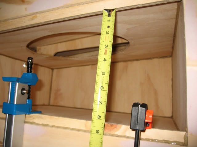

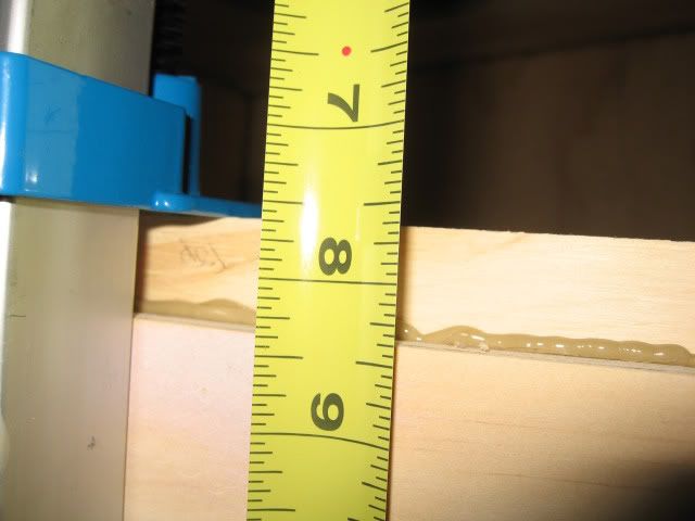

Parts Express says the mounting depth of the DVC 15 is 7-3/8". I measured about 7 1/2" towards the middle and > 8" towards the back.

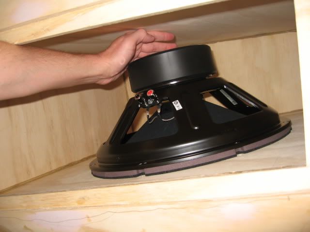

It is a tight fit for mine... the surround gets compressed about 50% and rubs when getting it in past the flanges...that's with me sliding the driver back (to the wider side of the access hole) so that it has clearance.
Get your DVC and try fitting it past the flanges you already have before you decide what to do. You may be fine...but's it's good to be sure.

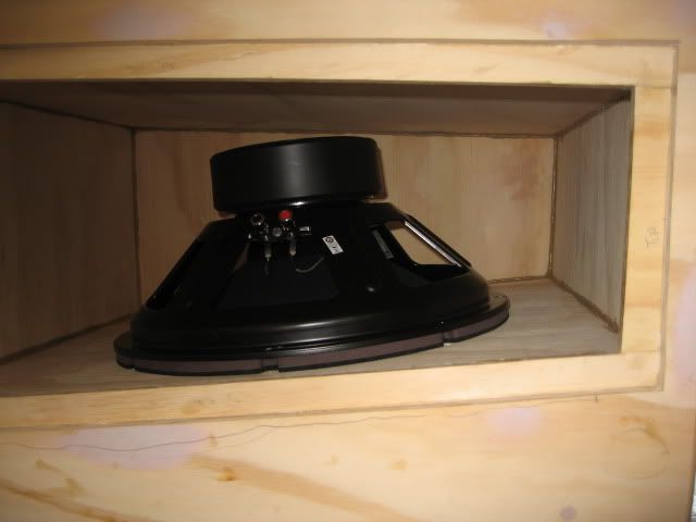

I took MaxMercy's advice and test fit the driver. I had no problems what so ever getting it in and out. Very very minimal rubbing. Definitely looked like it belonged in there, thats for sure.
I ended up adding the additional access panel flanges last night. I'm thinking about sanding down the middle portion of the one flange that is high in the middle and I was also thinking about sanding the ajoining access panel lip where it sits on the flange. My hopes are that elivates the raised portion of access panel. Sound okay?

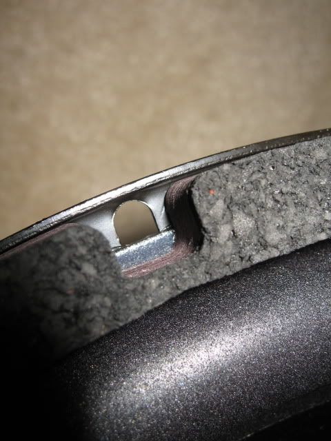

Regarding the drivers (Dayton DVC) gasket. I noticed that around where the driver holes are, it gets rather thin. Will this be suffice using the standard gasket?

Wow, the Reference HF has a lot less room in there...that gasket looks beefy, I wouldn't bother with gasket tape unless you get leaks....The reference HF's gasket had more to be desired, so I used gasket tape...
as far as evening out the flanges, you know what I'd recommend. If you think you can sand the flange down to even easily, try it...

maxmercy wrote:as far as evening out the flanges, you know what I'd recommend. If you think you can sand the flange down to even easily, try it...
JSS
You think I shouldn't sand down the flanges and instead just sand down the access cover?
Wait, I forgot you got your router back...
I would actually router with a straight bit (and guide) or templating bit and shave down the high spot on the flange, carefully. You will end up with a much more level flange than with sanding...and it will take MUCH less time.
JSS
JSS
I second that opinion.maxmercy wrote:I would actually router with a straight bit (and guide) or templating bit and shave down the high spot on the flange, carefully. You will end up with a much more level flange than with sanding...and it will take MUCH less time.

The way I read the photo, the flange is above the side panel height.
He could use a pair of 1/2" flats that straddle the opening to keep the router base from lifting when it hits the flange.
Hrm... Since the middle of the flange is higher, how would I orientate the router to trim down the 3/4" surface area of the flange?

The router rides on the cabinet face, the depth of cut of the bit is constant. I'd use a collar on the router so the bit can't hit the side. That will leave a slight ridge at the flange edge, but since the cover has a bit of clearance it shouldn't hit that.myn wrote:Hrm... Since the middle of the flange is higher, how would I orientate the router to trim down the 3/4" surface area of the flange?
pay special attention to the screw areas when you do your leak testing. If you detect even the SLIGHTEST leak, get some speaker gasket tape (or te nice weatherstripping some people use) and run a strip all the way around the driver cutout so that the driver gasket sits on top of it when you screw it into place.
not doing exactly that is what caused me to blow my first AT driver.

Instead of a collar, use a templating bit. It looks like a flush-cutting bit, but with the bearing on the other side of the bit, it'll cut right to the panel wall. The router base is half on the side, half overhanging the access hole during the cut. You set the router bit depth even to the lowest part of the flange, and cut away the rest, starting from the 'inside' (inner portion of the flange) 'out' (to the panel wall).
Hope that makes sense...I can make a diagram...

For these drivers with narrow gaskets, you can get away with cutting a smaller diameter cutout hole in the baffle.
Even those half-round surrounds do not flex close to their mount point.
Adding even a miniscule 1/8" more surface area helps insure no leaks.
