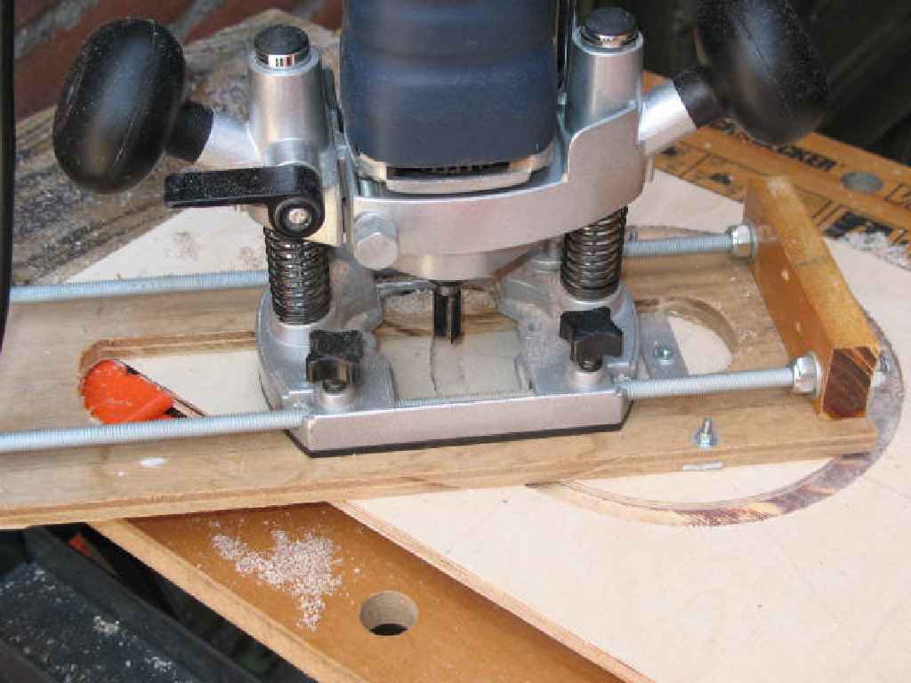

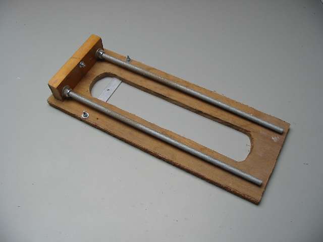

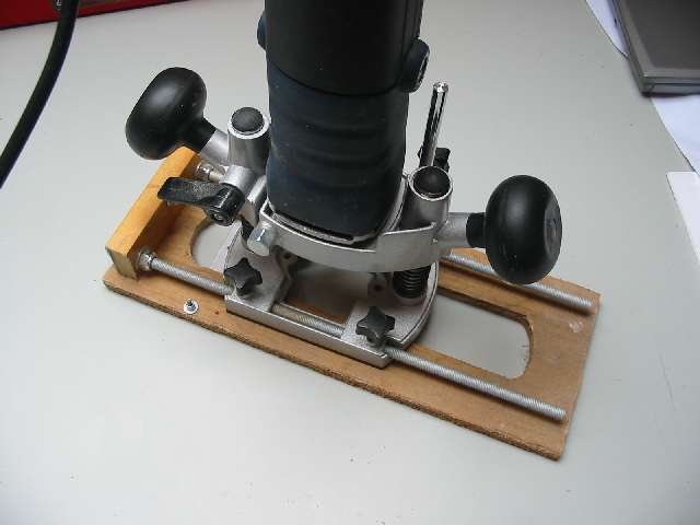

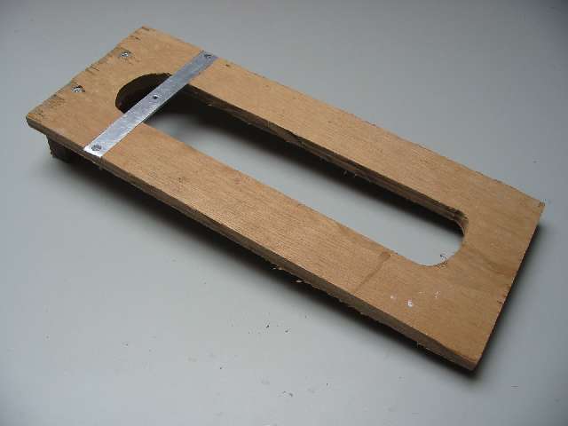

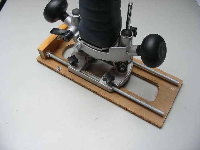

It's too bad all the hosts are dropping like flies. It looks to me like photobucket is on it's way out too.
I had to search for the old pictures, turns out I still got them, tucked away in some digital corner. Here you go.

#254 Post by ketoet »
I have something very similar to that for my old router

#255 Post by Bruce Weldy »
That's really fancy. My DIY circle jig was just a piece of old paneling I had laying around. Cut a hole for the router bit and the screws to fasten it, then measure out from there to where I wanted a pivot and drilled a hole for a dowel.
Cut a bunch of baffles that way.
