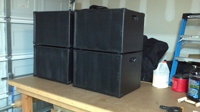

Thanks for the kind words. They came out OK...I chose the angles for my pictures carefully, to hide the flaws. :wink: I am capable of building these better than they turned out...The angled horn panels are what threw me, but hey, I'm smarter on that now. They're not BAD, but all the extra trimming/sanding I had to do just ticked me off. The end result is what matters though. They're air-tight and sound great. They will look 10x better w/grills and corners. I'll order from Reliable on Tues and should have them early the following week.

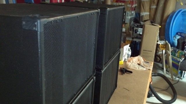

Quick question[ on the blacked-out grills. I bought the foam AC filters; they are the perfect size. As I understand it, I'm supposed to spray the glue on the GRILL, then lay the foam on and trim foam to size after the glue dries. Does that sound right? I don't want a whole lot of dried glue visible through the grill. Thanks.
67baja
Posts: 931
Location: Las Vegas, NV
Re: OTop12 Build Thread
#230 Post by 67baja »
I sprayed glue on the foam and still ended up with it on the front of the grills when I pressed the foam down onto the mesh. Sorry, I can't give any help.
Posts: 29054
#231 Post by Bill Fitzmaurice »
miked wrote:I'm supposed to spray the glue on the GRILL, then lay the foam on and trim foam to size after the glue dries. Does that sound right?
+1. If you spray the glue on the foam you'll fill the pores and you don't want that. Initially place the grills atop waxed paper, spray them, then move them to a fresh clean piece of waxed paper, also so no glue gets on the foam where it shouldn't.

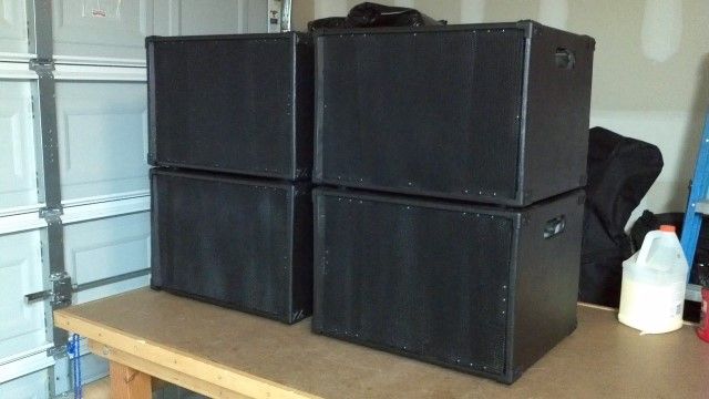

And they are DONE.
#235 Post by miked »

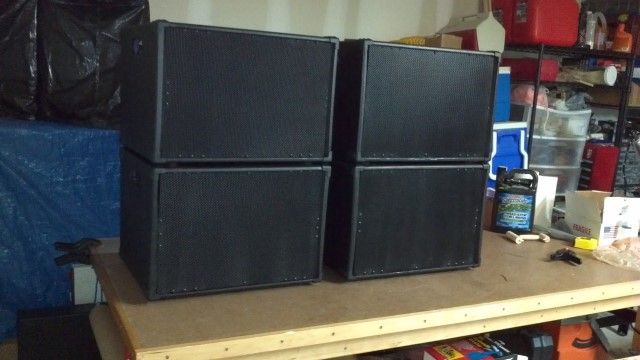

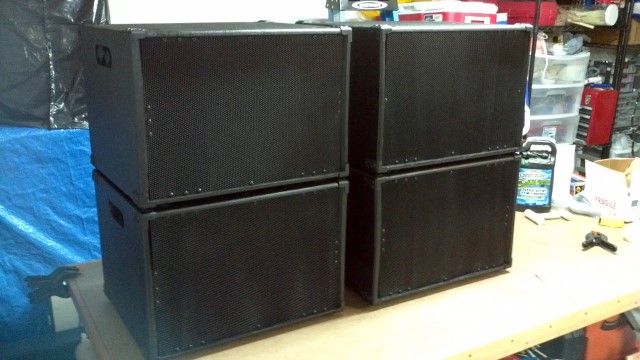

My Otops are FINALLY finished. As in, FINISHED, finished. Complete. Fini.
Timing is everything. Today, my grills were finally delivered (Reliable does great work, but they are slow) AND, it was the first day I've had time to drag everything from my garage, around the side of the house, through the uneven terrain, to my back yard, set it up and let it blast. But the grills got delivered at dinnertime and I set the rig up late morning. So, the "setup pics" have no grills. :wall: But first, here's what they look like done. Excuse the cell phone pics...they look better in person. Oh, I weighed them on my digital postal scale. They are all 52-freaking-pounds and a few ounces. Yeah, they are beasts.

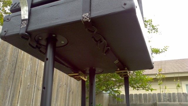

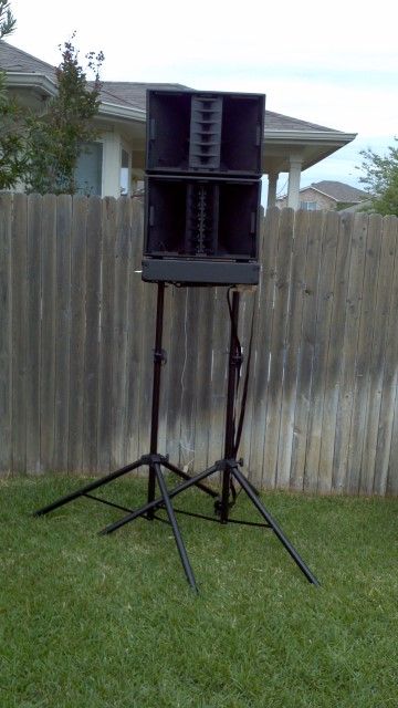

And here's the setup from earlier. Not in the picture is the American DJ SDJ-2, SD Card MP3 player that I use to provide source material. Yeah, I know: SUBS. :lol: I'm building two T48 very soon. Those subs in the pics have 18" Neo drivers in them and are built from 1/2" BB. They weigh 60 pounds each. Not heavy at all. They are no T48s. With my old tops, these subs USED TO get the job done, but they can't keep up with 4 OTops.
Note the black cargo straps. A nice touch, IMHO.
RTA/Auto EQ REALLY smoothed things out.
I'm VERY pleased to report that my mounting platforms performed very admirably today. Winds were hitting 19mph here in San Antonio today and the stacks didn't sway not even a bit. :clap: Seems my design is a solid one. Every once in awhile, I hit a homer. Doesn't happen too often, but hey, I done good. :mrgreen:
I tell you, I'm impressed. Ran the tops highpassed at 100Hz/24db (DriveRack PA+), thru a QSC GX5 (700w per side @ 4 ohms). Had the amp gains at about two o'clock. I haven't properly set up my gain structure yet, but just from what I heard today...just WOW. Sound was crystal clear anywhere in my roughly 25 x 50' backyard. Vocals, in particular, had a presence to them...very "live sounding" vs. my old tops. These four OTops just completely destroy the pair of Peavey PR12's I've been using. They were good "starter tops" but OTops are a whole other level above them. I played a bunch of different styles of music through them, but what impressed me most was the Beatles' "Here Comes The Sun." I have a 320KB/s mp3 rip of it and it sounds as good as the CD. My backyard is about 50 long/wide, but I'm on the corner, so there's a good 75 feet beyond my fence, before there's any other "reflective/boxy" walls. I had the volume cranked as loud as I dared w/o having proper limiters in place and at the end of my backyard, I could feel the pressure waves from the OTops. My ears were "pressurized" to the point that I had to turn it down. This was OUTSIDE!!! My PR12s only did that within about 15 feet away from them...indoors. Can't wait to pair these up with a pair of 24" T48s!
Again, thank you for all the advice, encouragement and the sharing of your ideas and experiences. Couldn't have done this without you guys. :hyper:
