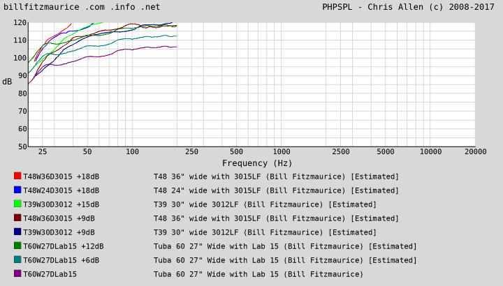

Rich4349
Posts: 900
Location: Kankakee, IL
T39 and T48 comparison spls
#222 Post by Rich4349 »
Just comparing some Titan variations.
( red) SIX 36" wide T48s vplated
( royal ) SIX 24" wide T48s vplated
(kelly green) FOUR 30" wide T39s vplated
( maroon ) TWO 36" wide T48s vplated
(navy blue) TWO 30" wide T39s vplated
(forest grn) FOUR 27" wide T60
(turqoise ) TWO 27" wide T60s
( purple) ONE 27" wide T60s
Also shown are associated high pass points for 2 or 4 (OR MORE) Titans. Performance below these lines FOR TITANS should be disregarded. Here the T60 reigns supreme.
And, yes, I can see that this chart is close to a cluster feck, visually. :ugeek:
