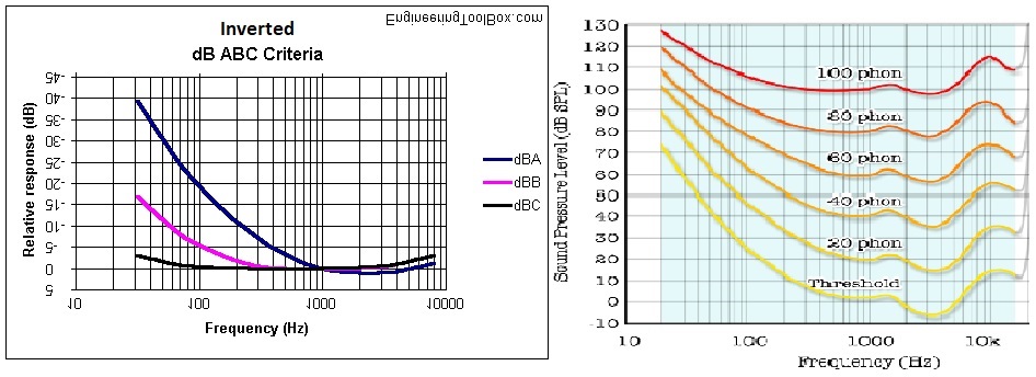

Going back to the point about equal loudness curves...
Tom Smit wrote: Sat Dec 21, 2019 12:48 am
SethRocksYou wrote: Fri Dec 20, 2019 6:57 pm.. perhaps this could go towards explaining why EQ'd flat with pink noise is still a little thin on the bottom end.
Yup, that's the why because.
I inverted the dBA weighted curve and compared it to the equal loudness curves.
Seems like it could be worth a try and a listen to EQ flat, but to a A weighted curve.
