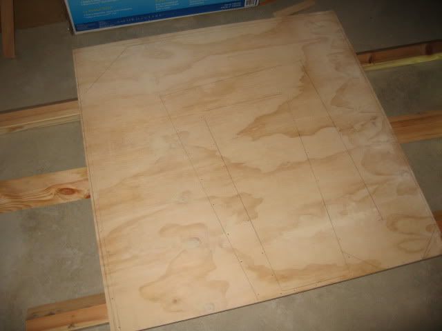

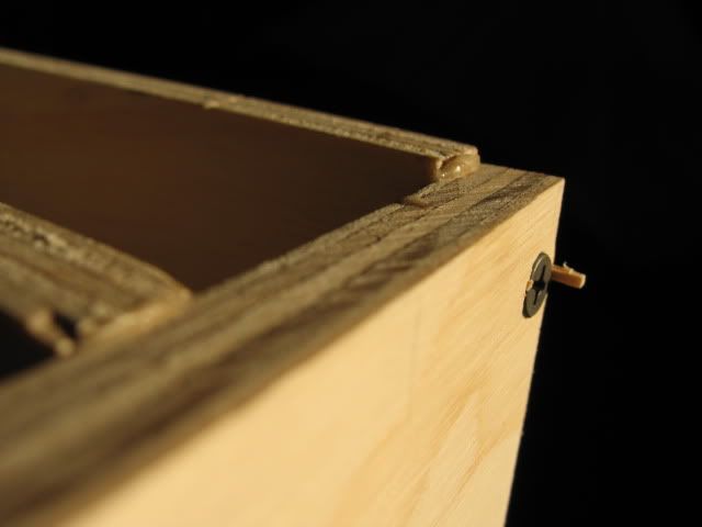

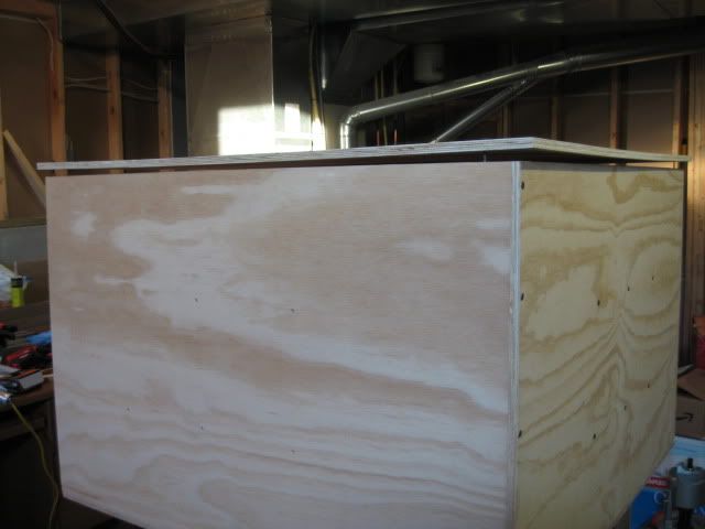

Tonight I drilled more holes than I care to count, 4 or so inches apart. I also prefit the side panel and tested the screw registration points confirming the panel could float above the panel edges once PL is on them. As you can see by the pics this method worked out well. Now all I need is balls to do the securing with PL..

As I am planning on unscrewing all of the external screws once the top panel is on and fill it with something (Bondo or Wood Filler). I was wondering, when I route the edges with a roundover bit and its close or ontop of the filler, will the router chew the filler up? (example below)

WB wrote:No, because the bit spins inside a bearing, the outer race of the bearing is stationary against the contact surface.myn wrote: I was wondering, when I route the edges with a roundover bit and its close or ontop of the filler, will the router chew the filler up?
Sorry I didn't convey this right.
In the picture below, if I was to put a roundover on the vertical surface where the screw is, wouldn't the router bit chew up the filled hole and create a crator? Like you said, I think I'd be fine if I was doing the horizontal surface as the bearing would ride along the edge smoothly.
if you use good filler that is fully cured/dried, the router bit will turn it to dust, leaving you with a nice roundover...it works very well.

I've used Bondo to fill the screw holes on all my BFM builds, and I've never had any problem with my roundover bits messing up the filler. Just make sure you let it dry well first.myn wrote:Would 2 part Bondo constitute as "good filer"?

Yes. It is very good, and cures very fast. You can sand in around a half hour, but for the router I'd give it a little longer. It's essentially polyester resin and silicon microspheres. So wear a respirator when you sand/rout the stuff (you should always anyway).myn wrote:Would 2 part Bondo constitute as "good filer"?
