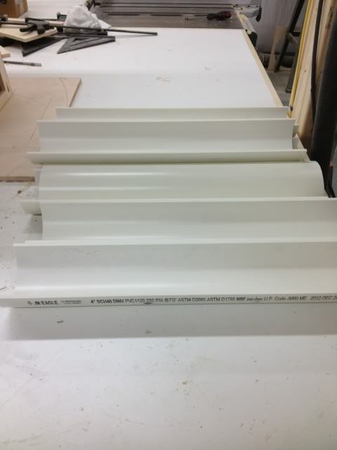

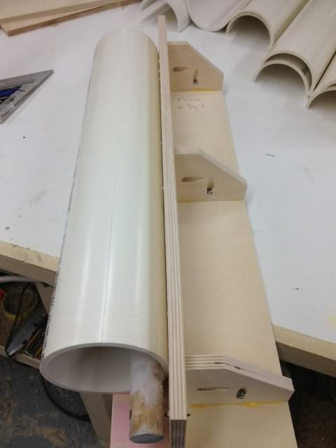

Today I got a haalf a day in and got some stuff done that I've been anxious to tackle. I got all the PVC cut up today using this simple jig.
went pretty quick after that.
and they fit like a glove.

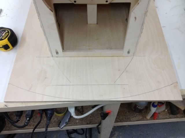

I want to get your opinions. I cut the top and bottoms slightly longer because I knew I want to put a curve in it instead of straight. Unless Bill objects to this what do you guys think? Should I curve it this way or the opposite way?
I figured Id cure a mesh grill over the tweeters to match it?
Rick Lee
Posts: 1237
#185 Post by Rick Lee »
http://billfitzmaurice.info/forum/viewt ... 26&t=14987 This will give you an idea of the finished look (DR200s). I've never seen one with a reverse curve- it would probably look pretty mean IMO. Acoustically not a big deal.

#186 Post by hifibob »
Rick Lee wrote:http://billfitzmaurice.info/forum/viewt ... 26&t=14987 This will give you an idea of the finished look (DR200s). I've never seen one with a reverse curve- it would probably look pretty mean IMO. Acoustically not a big deal.
Oooh I like that! Thanks Rick! Maybe I'll reverse the curve since he already did it the other way. That def looks sweet tho, thanks for the link.

not trying to derail this even more, but any interest in making a new thread to include pics of all your amazing jigs? I'm sure many of us would LOVE to emulate your build tyl, esp those of us looking to build large numbers of cabs (I might be building 6 T60s by mid august), and also might be upgrading from ot12s to dr280s lol.

sine143 wrote:not trying to derail this even more, but any interest in making a new thread to include pics of all your amazing jigs? I'm sure many of us would LOVE to emulate your build tyl, esp those of us looking to build large numbers of cabs (I might be building 6 T60s by mid august), and also might be upgrading from ot12s to dr280s lol.
Hey sine I could make a new thread strictly for jigs.. I can also email them to you as well if you'd like? I'll be back in the shop tmrw and I'll snap some pics of them.

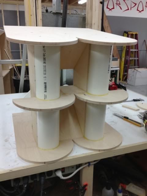

Sorry for slower progress.. Been kind of busy. Tmrw I'll be back at it! Meanwhile I got all the sides and PVC installed last night. Sanded and filled all the screw holes as well.
