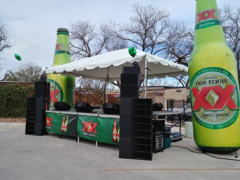

I try to follow the sub placement rules when I can, but sometimes you have to weigh the power alleys against all of the other factors. Two years ago, I did an outdoor event and put the subs in front of the stage, but with the windy conditions, we had to lash the speaker tripods to the tent poles over the stage... sounded great, but was concerned.
Last year, same place - we went with our normal "big show" outdoor setup even though we couldn't get it very far apart. Yeah, there were power alleys, but the crowd was all on their feet milling around so it really wasn't that noticeable and I felt a lot better about the setup this way.
Life is a trade-off sometimes.....

Bruce Weldy wrote: Thu Feb 06, 2020 11:32 am Life is a trade-off sometimes.....
Looks like a single stack may have been an option too. Envisioning a four stack of O-tops on 6 V-plated Titans get's me giggling a little inside.
Posts: 8688
Re: Titan 39 Build
#172 Post by Bruce Weldy »
SethRocksYou wrote: Thu Feb 06, 2020 11:56 am
Unfortunately, I can't stack OTops on my v-plate......I've done a mono stack before indoors with a single T39 and two OTops.
Oh, and I need a pretty tall ladder to get the last OTops up there!
That stack you see is right at 8 feet to the top.....

You'll also notice that both stacks are angled toward where I'm taking the pic at FOH. Time issues? Probably, but I went for better coverage of where the people were going to be as opposed to the stage orientation - which was off by quite a bit.

Bruce Weldy wrote: Thu Feb 06, 2020 11:32 am I try to follow the sub placement rules when I can, but sometimes you have to weigh the power alleys against all of the other factors. Two years ago, I did an outdoor event and put the subs in front of the stage, but with the windy conditions, we had to lash the speaker tripods to the tent poles over the stage... sounded great, but was concerned.
Nice setup, Bruce. And it makes sense what you're saying. I'd love to have my cake and eat it, too. But I guess that isn't always the case.

Bruce Weldy wrote: Thu Feb 06, 2020 12:37 pm You'll also notice that both stacks are angled toward where I'm taking the pic at FOH. Time issues? Probably, but I went for better coverage of where the people were going to be as opposed to the stage orientation - which was off by quite a bit.
I'm willing to bet the average patron would never notice it.
Yeah, I noticed that. I think that's what had me thinking about a single stack on the left to get the coverage, limit cancellations, power alley, and other timing issues, and also open a clear(er) line of sight to the stage area. I wasn't there and I have nowhere near your experience. I'm sure you made the right call given the available conditions and circumstances.
I guess, in the end, every gig is it's own unique situation and it's your/my/whoever's call on what the appropriate balance of trade-off's and compromises are to achieve the primary objective. Apparently, sound quality isn't always at the top of the priorities list. Sometimes it's even at the bottom of the list. Guess we just do what we gotta do. Put forth reasonable effort to get it as right as possible, throw a hand in the air, and ride it out. Right? :cowboy: Yee Haw!
Ideal and perfect are two different things altogether and rarely occur at the same time.
