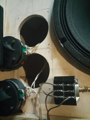

I received the l-pad from qcomponents.ca today, fast shipping, soldered it and it works like a charm, can't be more happy :)
Now i can finish it as soon as i receive the jack plate.
I'm glad i did the model with tweeters, without them it would be too dark for me... with that l-pad just reducing a bit it's perfect like 1/10 turn attenuation and it's good, might change when the cab is fully donne with damping and such but that leaves a lot of possibilities :)

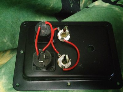

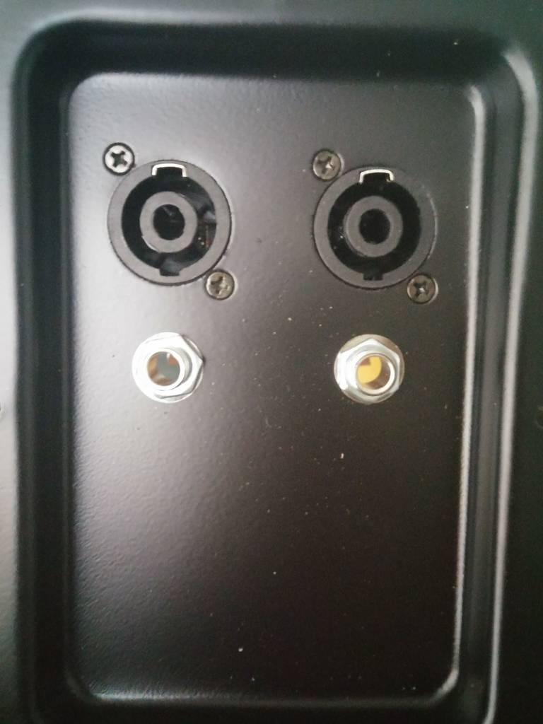

Received the jack plates today, there's even space for the L-pad, is'nt that awesome :D

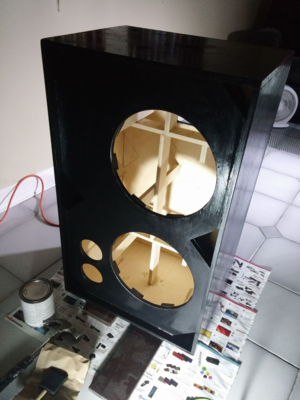

Painted and urethane finish :)

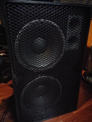

#179 Post by Electric Wisdom »
omg omg almost finished!!!! :hyper: :hyper: :hyper: :hyper: :hyper: :hyper: :hyper: :hyper: :fruit: :fruit: :fruit: :fruit: :fruit: :fruit:
