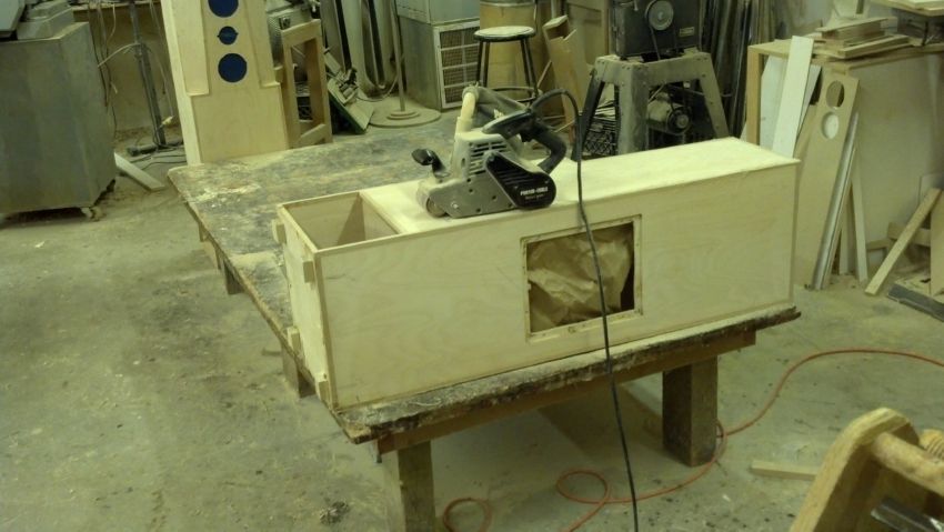

Forgot my crappy old camera today so we have to settle for cell phone camera that I am still figuring out how to use.
First order of the day was breakfast, a big hardy one that led to the second order of the day, a nap.
Eventually it was time to head to the shop. After taking off the clamps it was on to the belt sander to get at that pesky PL Premium.
I cannot believe that stuff. I have never had anything stick on to my hands like that stuff. Even stains and dyes come out faster than this stuff. Amazing. Might have to clean my aquarium filters - that always seems to take everything off my hands and they are past due anyway...
Want a good belt sander? We swear by our 3 X 24 Porter Cable.

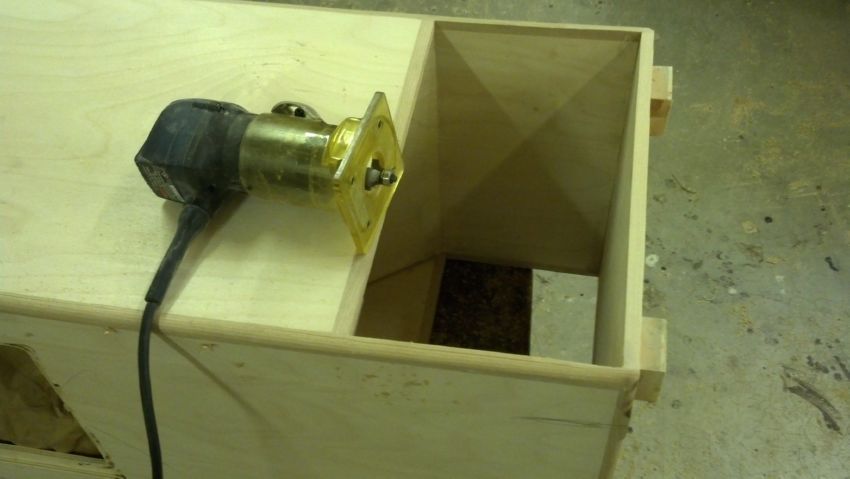

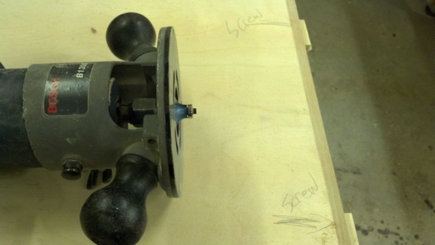

After, getting the edges leveled out and any excess adhesive removed, it was time to round over the edges. I went with a 3/8" round over, but kind of wished I would have gone to the full 1/2", but...
I glued my foot blocks over the pocket screw holes so I could not remove them. I made sure to mark their approximate locations so I would not hit them with the round over bit. If you want to wreck your tools, run them into hardened steal screws. Hit a drywall screw with a jigsaw blade or drill bit, kiss them goodbye, a carbide router bit is going to need sharpening if it survives.

Notice on the photo above that the round over bit is not down all the way to make the full round over edge. For this size bit and the material I was cutting, it might not be necessary, but it is a good idea to make a couple passes and not take too much material at one time. All you need after going through this much effort is to have the bit rip out a big chunk of wood and ruin the edge.
The edges that stick down lower on the front and back are just about at the limit for where the guide bearing will run. Either finish the rest with the sander or run the router the other way so that the base is on the thin edge - but this is a dicey move.

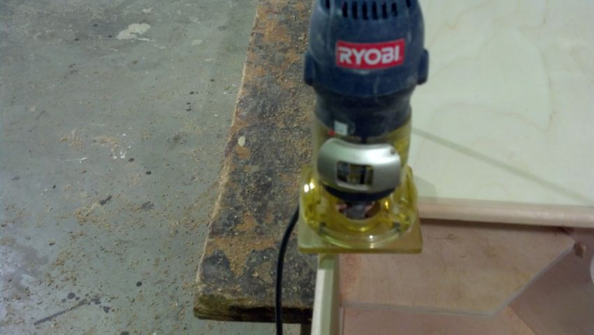

For the bottom of the sides and the base piece, I went with a 1/4 round bit. Got to use the little router for this. It is a cheap Ryobi, but we kind of like them. I think there are three of these flush trim routers floating around the shop.

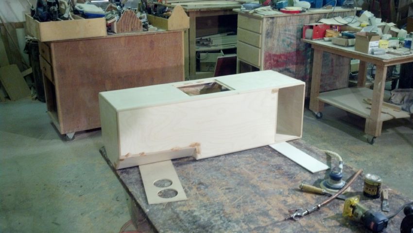

After the rounding was done, it was time for the finish sanding.
First thing to do is turn on the lights. It took us a while, but we have finally come to the realization that we were not seeing our work well enough with the standard overhead shop lights to do the best job finish sanding that we could. We now turn on some bright halogen work lights and position them so that they are behind what we are sanding and can get so reflection off the wood to help see any imperfections. If you are sanding in the garage, you can get the same results by taking your work close to the edge of the garage but stay inside so that the bright outside light can reflect off of your piece. And your neighbors don't sneak up on you to see what all that racket is about.
Notice that there are a couple of pieces of smooth material under the speakers. Our assembly table table is not smooth, so there is a good chance that as you rotate the cabinet around, you will ding the side that is down on the table.

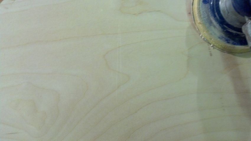

I noticed a good example of this on the front of one of the cabinets. I took a picture after I had already sanded on it for a while. I hope it shows up. But scratches like this make a guy use bad words.

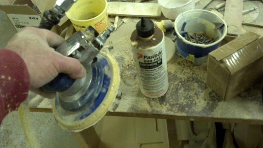

Oh, saw another picture I shot and wanted to comment on it. Be very careful when coming to inside edges when routing if the edge you are coming up to does not get that router profile.
Same with using a sander with the raw edge spinning around like our air sander - that disk is pretty stiff and will sand a notch where you don't want it real fast.
