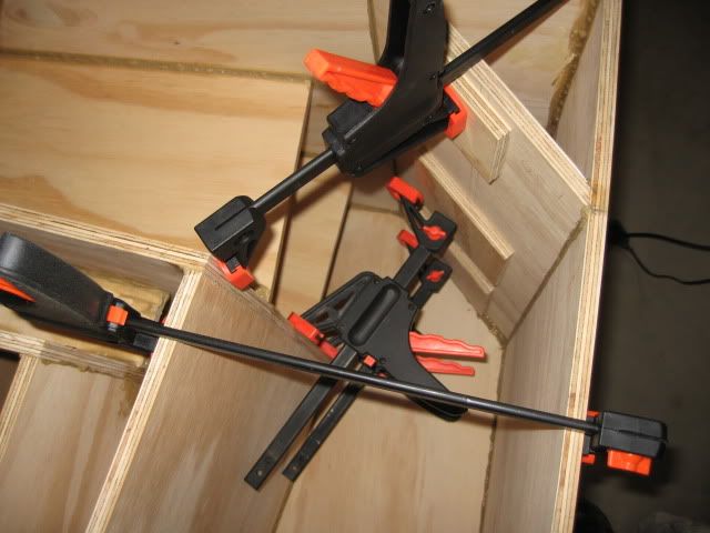

Out of curiosity I placed the pre-cut side panel (36"x36") on the top to see how it would fit. I clamped it as best I could using 2 pipe clamps to squish in the side panels and some other bar clamps but still the side panel seemed to small with it being not able to cover some of the vertical panel edges causing a lip. I think the root cause of this is the warping as it fits fine in some places.
On my Varathane quest today I stopped by Harbor Freight and bought 2 48" bar clamps thinking maybe I can get it perfect with more clamping of the panels. I'll give it a try tomorrow. Even so, I'm wondering how I am going to be able to manage to clamp the panels in enough to get the side panel on while the sticky PL overflow is ouzing all over the clamps.
I've got 2 more sheets of 4x8 AraucoPly that I was planning on using on either a TableTuba or some SLA's. I'm wondering if it wouldn't just be easier recutting out the side panels a bit bigger, even with overhang and let the router with a straight flush bit do it's job making it perfect?
Thoughts?
Thoughts?

I do this.myn wrote:I'm wondering if it wouldn't just be easier recutting out the side panels a bit bigger, even with overhang and let the router with a straight flush bit do it's job making it perfect?
Thoughts?
Tim laughs at me, but I do it anyway.
Wood ain't perfect, and trimming flush with the router hides a LOT of sin.

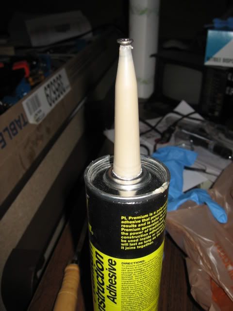

Oh yeah! I tried using a drywall screw instead of an old latex glove to secure the PL for use later. I actually think the screw does a better job as many have said it draws out the hardened PL at the top of the piece.
