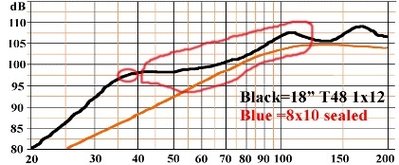

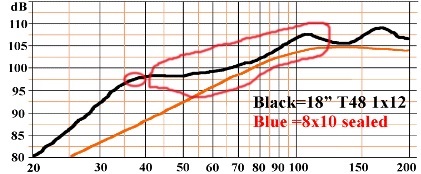

Grant Bunter wrote: Fri Dec 06, 2019 3:24 pm ...So why would you want to cruel response below 40Hz by decreasing sensitivity in that region?...
To be honest, that was my initial thought too. This helped.
Little loss in the little circle for a little gain in the big circle. As it is, according to this particular graph (not 24" wide) the Sensitivity only falls off 2dB between 35 and 40Hz. Even with a slight reduction in that spot, I think I'd be alright with EQing flat down to 50Hz and leave the slope below that alone.
Also, I'm not sure how you guys look at an SPL chart. I initially looked at them as the higher the sensitivity at any point, the louder it is. However, assuming we've planned the system to have ample headroom, run below the limiter... after everything's all EQ'd to whatever your/my pleasure is, a single Db of sensitivity increase equates to a reduction of power needed to produce whatever level the music is being played at, whatever the arbitrary volume you or I deem as an appropriate level is. 1dB increase in sensitivity will require 89% of the voltage (or 79% of the watts) it would otherwise take to make the same SPL without the increase. 31.15V will make the same SPL as compared to 35Volts without the 1dB boost in sensitivity. 121 watts instead of 153. So, while we might not notice 1 or 2 dB with our ears, it isn't nothing. It puts us that much further away from a popped breaker. It could help with power compression losses. Avoid thermal buildup. Or, simply just add to the system headroom.
While some, most, or all of that may or may not be of valid concern in real world practice, it's where my mind is partially at in this project. I would love to be able to boast that I have the cleanest and loudest system on a single 15 amp circuit around my parts. The thought kinda tickles me a bit.
