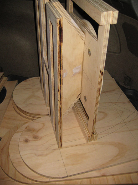

New snag. My throat construction is too big. I got some help making the curves on the top and bottom panels, and laid out the inside curve and access panel. The throat is about 3/4 inch past the access door line. What should I do?

#21 Post by David Carter »
You've done it exactly right. That's how it's supposed to be. The overhang is part of the access cover flange.

Gauss wrote:Thank you. That brings joy to my heart. :D
Glad to help. I had the same concern when I built my DR250's, but the sketchup model confirms that this is how it's supposed to be.
