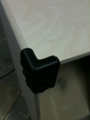

I just meant the plastic corners
The cab construction is complete!
I'm just a little confused as to what to do with the arrangement of the corners, possibly due to me selecting recessed casters on a slim cab.
Picture one shows the horizontal configuration. Obviously a bad selection, less than half of the corner would remain.
Picture two shows vertical alignment. Can use the router to trim it flush and three screws would be used.
However, to match it on the opposite end (the bottom of the horn mouth) the majority of the corner would be cut off, leaving screws only on one side of the corner.

Re: Jig for trimming plastic stackable corners?
Oh friggin duh.
After looking at the pictures, I just need to turn the corners so they are lengthwise along the bottom and top.
Need a brain fart smiley. Sorry ya'll.

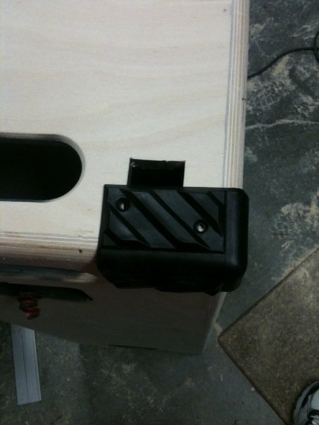

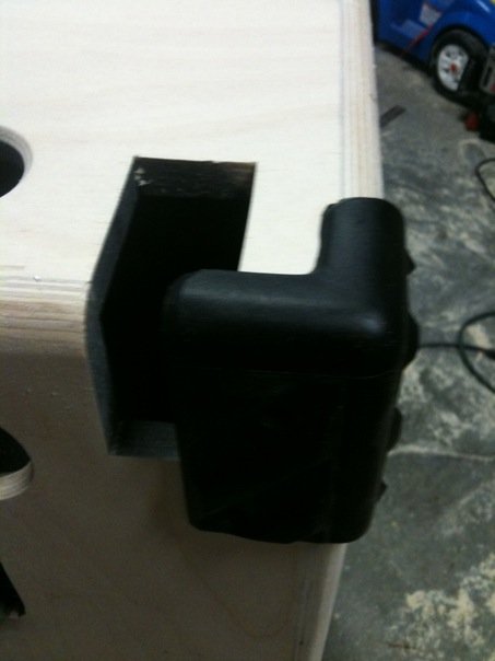

Here's my little jig. I clamp it to the work bench, install a corner, then one carefull pass with router and top bearing router bit.
And here's a cut down corner, perfect fit on 12mm (1/2") ply and allows the access panel to be opened.
It's pretty easy and straight forward. Yet, if Leland were on my continent I'd get the smaller chevron corners from him.
