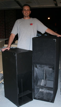

#22 Post by Sydney »
I didn't want to cut cardboard; so I pushed pixels instead to get a Q&D "general" idea of what a T48 skinny would look like; comparatively speaking
( until someone takes a pic. of the real thing )

Re: Planning on expanding. Opinions wanted.
#23 Post by bgavin »
Nice job indeed.
Can you do that with $20 bills?
:mrgreen:
The T48 skinny is an oft-overlooked box.

Sydney wrote:I didn't want to cut cardboard; so I pushed pixels instead to get a Q&D "general" idea of what a T48 skinny would look like; comparatively speaking
Oh my, another alternative :noob: . What is the upside of a T48Slim? I haven't read anything about them on these forums yet, but I assume they rock anyway.
BTW that's a hell of an editing job on that pictures. It looks so real. What program did you use to do that? If I may ask.

Dusneed wrote:The T48 does look so much larger, but pack space isn't my biggest concern. I like how you can carry the T39 with one hand although.
You put a strap handle on the back. In my case, the handles are recessed.
http://billfitzmaurice.net/phpBB3/viewt ... =14&t=6903
Dusneed wrote:You're the reason the T39Slim is still a viable alternative to me because you are in the same business that I am in and they work well for you, from what I have read. I am under the assumption, that I can attain a more even sound by spacing out smaller stacks in a larger room instead of having 1 larger stack center clustered or corner-loaded. Also, that I don't have to push the smaller stacks as hard a larger stack because the relative distance from separated stacks will be lower (as long as I obey spacing rules). Am I correct in that assumption?
That is correct. I tend to run tops in stacks of two - then I bring enough to split the width of the venue into 20-30ft sections.
As long as you can split the subs by more than 56ft, you are OK. My favorite trick with a 150+ ft wide room is to take eight subs: two in a V in one corner, four in the middle of the wall in a V or W, and two more in a V in the other corner. With boundary loading, each stack is producing roughly the same SPL. It looks funny...but the effect is a very even bass field.
