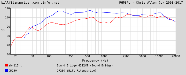

Could you add in the Soundbridge 4112? The plot is at http://www.soundbridge.com/pdfs/4000pdf/4112ht.pdf.
Thanks
Re: Introducing SPL Chart
#23 Post by Chris_Allen »
Here you go:
Code: Select all
[spl]sb4112ht,DR250&dbmin=60&dbmax=110[/spl]

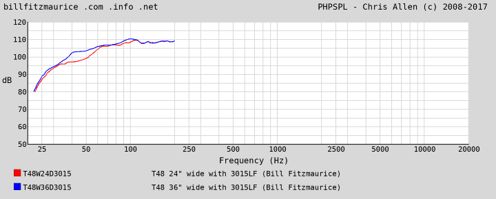

This compares a T48-24 with a T48-36 3015LF Loaded

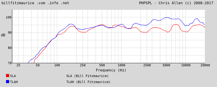

SLA and TLAH
Code: Select all
[spl]SLA,TLAH&dbmin=70&dbmax=105[/spl]

In that chart, I couldn't help but notice that, in a 24" T48, it shows a 3012LF beats a 3015LF.
Albert Einstein
Posts: 7635
#30 Post by Tom Smit »
Mikey wrote:In that chart, I couldn't help but notice that, in a 24" T48, it shows a 3012LF beats a 3015LF.
Yes, but only from 48-55hz and 93-100hz
