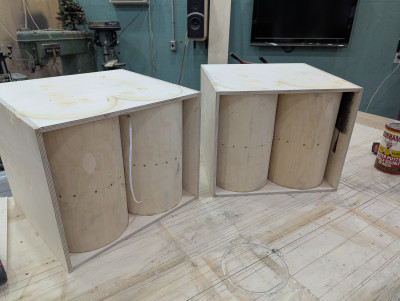

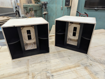

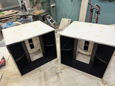

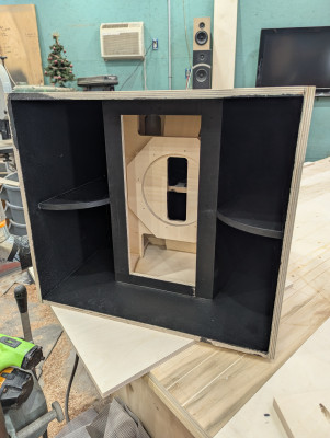

Finally got everything on the inside pre-painted and the sides are on. You can see that I went with the option to use the cutouts from the top and bottom "boob" half round pieces for a lack of better term. I was honestly quite surprised as to how well they came out. I fully expected a large hump where everything meets up, but was pleasantly surprised.

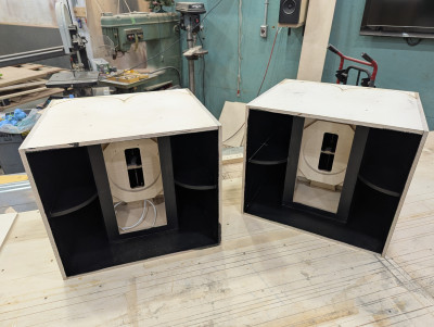

The pair of them all wired up through the back side and durhams wood putty filler

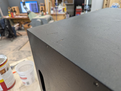

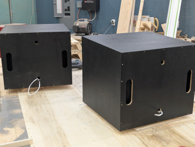

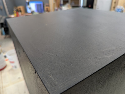

Back was prepped with hand holds and speakon holes, installed, trimmed, glued and screwed on the back panel. One thing I regret was not taking the time to figure out how to recess those speakons quickly and easily. After I mucked it up, I found out how to do it . Oh well, there's always next time.

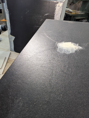

I didn't get many pictures from this point on. I was rushing to the end, but I did still manage to get some final shots. For the throat pieces, I was able to do everything right on my miter saw. Made quick work of things
Decided to spray the throat plate black instead of brushing things on. It's not the best method. So hard to sand those pieces after they are in place. Also, started getting my soldering equipment out, as the crossover is the next step.
