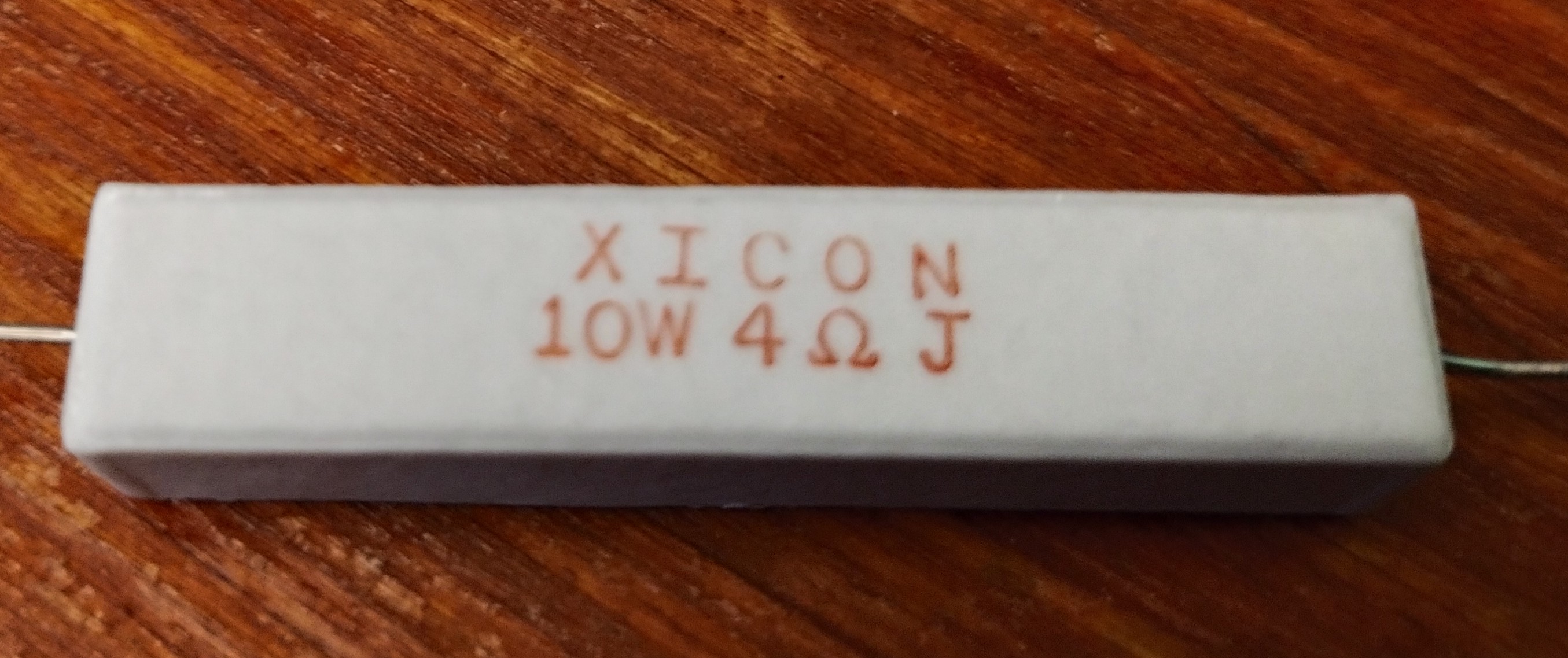

I was able to find 1/4" felt locally, but it was expensive and I've already spent a lot of money of this project. Instead, I found a shop willing to sell me a large cutoff of 1/2" carpet padding. I know it's not ideal, but it'll have to do. I also stopped at an audio repair shop to pick up the 10W/4 ohm resistors (Parts Express is backordered for a month), and this is what they had:
I can't find anything online about them being audio quality, but I'm only out a few bucks if they won't work.

Are you able to provide any input on the resistors I asked about a couple posts ago? I'm pretty convinced now that they're not the right type, but I'm hoping for confirmation from someone more knowledgeable than me.

Those resistors are fine.
Re: Jack 10s and Tuba 24s?
That's good to hear. Thanks.
