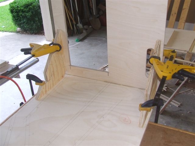

No need for wax paper. Cut the corner off the 90 degree jig so that it doesn't get into the corner.
Like this....if you zoom in, you can see the cut on the corner.

I stopped using wax paper a couple builds ago, in favor of regular blue painters tape. PL doesn't stick to it and it's way easier to apply where you want it.
