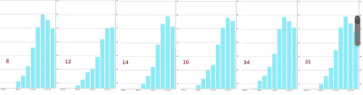

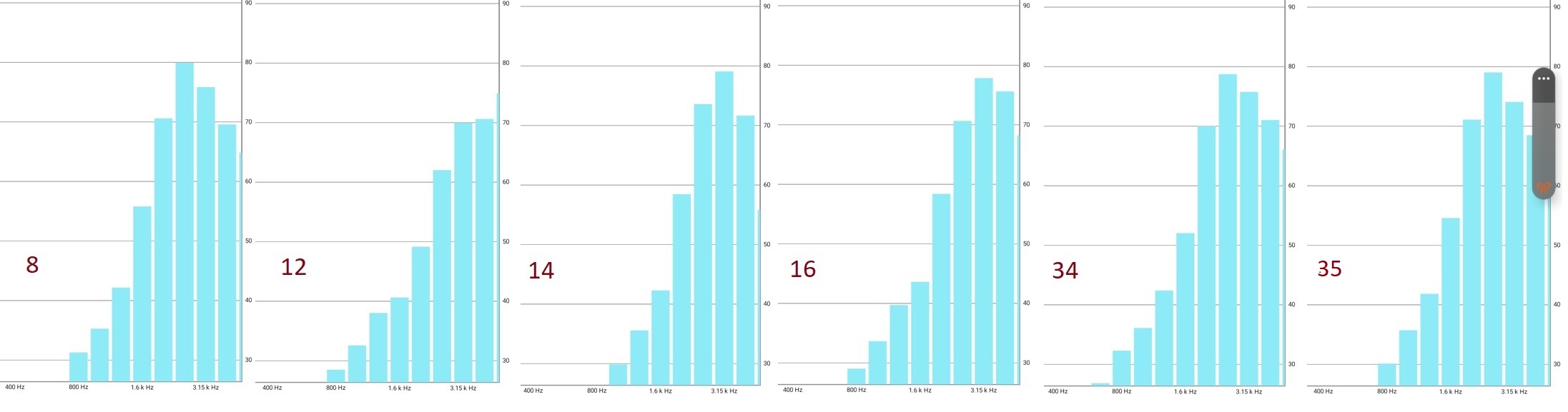

I retested the questionable tweeters and included the graphs. #8 is typical (I'd call it good). 12 is blown, 14 and 16 are highly questionable (seem to lack production between 1.6-3KHz and I don't think they sound good), 34 and 35 were a bit softer but i'm guessing they would be fine. This has been fun (first time running this type of test)! Thanks in advance for any advice!
Posts: 29125
Re: Cheap TLAH drivers
14 and 16 are probably close enough, being in an array. 12 is NFG.
