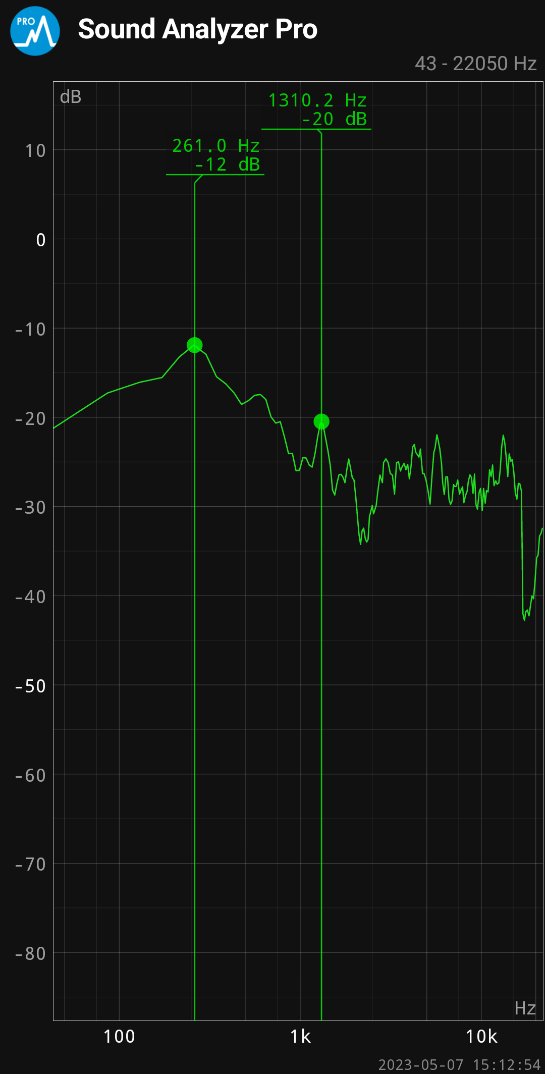

These are the results from the app using phone mic. There's a small drop at 2.2 kHz and then a very steep drop at around 16.5khz. Is it safe to assume the steep drop is due to limitations of phone mic?

Nice. It very well could be the phone mic. I wouldn't worry about the response up there at all. 95% of the people listening can't hear over 16kHz anyway, unless they're teenagers.
Does that app offer 1/3 octave resolution? Makes the data a quite a bit more manageable/useable.

1/6 octave is the best you can hear, so there's no point in using any more resolution than that. The 2.2kHz drop could be polarity, so you need to switch it on the tweeters and see what happens.

Bill Fitzmaurice wrote: Sat May 06, 2023 7:21 am 1/6 octave is the best you can hear, so there's no point in using any more resolution than that. The 2.2kHz drop could be polarity, so you need to switch it on the tweeters and see what happens.
By switch it do you mean the polarity of the entire array?
I'll also try and get the app figured out and send a better screen shot tommorow. Is the gradual decline between 1khz and 10khz anything to worry about?
Posts: 29056
Re: Improving piezo sound
#26 Post by Bill Fitzmaurice »
The entire array. From the plans: The HF section must be polarity matched to the woofer. Connect the woofer to the LP filter output. Using a tone generator or test CD play a test tone at the crossover frequency. Place a sound meter a few feet in front of the cab, or have another person stand there. Play the signal with the woofer only. Touch the leads going to the HF section to the HP filter output. Then reverse wire the HF leads. Which ever way measures or sounds louder to your assistant is the correct polarity.
A gradual decline from 1kHz is normal.

I've tested the polarity, it seems that the way they were wired originally was correct. I had my brother be my ears and he said that the original was louder. However using the app on my phone, it claims that both wiring variants are equal in response which is odd. It may just be the inaccuracy of my phone I'm assuming. Which could also be responsible for the dip present at 2.2 kHz. Here's the final response with a different app...

Polarity isn't necessarily a problem, but it can be, so that's why it should be confirmed.
