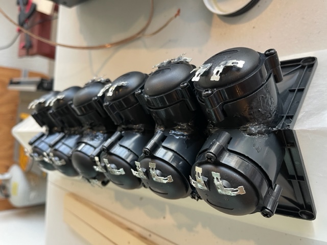

Moving along, got the tweeter array together and am planning on glopping on more acetone + plastic over the next couple of days. Starting to think about how to power these things....I have a couple of home amplifiers sitting around and a bluetooth adaptor. I'm thinking....some kind of eq or dsp thing (?) in between the bluetooth and the amp and I'm set. It's for the garage and judging by the spl charts I won't even be running 1 watt into the Otops (like maybe ever?) The dream would be to have a driveway party and some music...but again, the efficiency is so ridiculously high it won't take much power. And I live in a retirement community so blasting super high volume might get me kicked out of the neighborhood.
On the other hand, if there is an easy, effective solution for my garage needs, I'm not opposed to spending some money. I'm into "easy"!

OK so if this is in there apologies but what is the best way to attach the tweeter array to the array mounts? 4 screws in the corners or PL maybe? Is there any benefit to making the array removable?
Also...that acetone and cutoffs makes a weird glop that is pretty amazing. Dollop it on, come back in awhile and it's solid plastic. Crazy stuff!

- Posts: 29056
Re: OmniTop 12 build
Screws, at every other joint, otherwise they'll rattle.

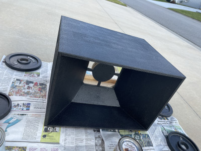

I. Love. Duratex.
Looks nice and covers up so much stuff that needs covering up!
Look'n good

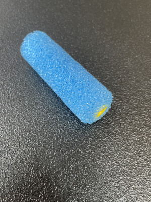

Water cleanup!!! The roller looks new with just rinsing in the sink.
(I mean….I know you guys know this but I used truck liner on some sla’s a long time ago and was expecting something similar. This is way way way better)
- Posts: 8647
Yep, it's amazing stuff.

I was amazed as you are. Totally worth the expense and if the cab is in black primer first the Duratex goes A LONG way.
1 gallon is gonna cover MANY cabs.
