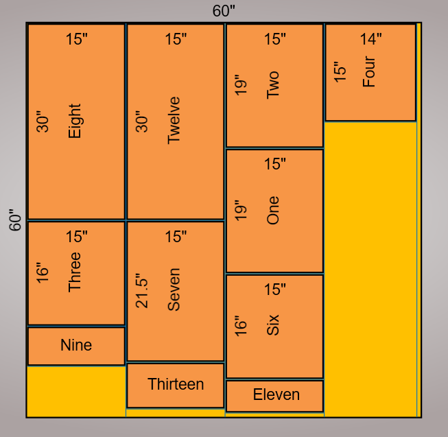

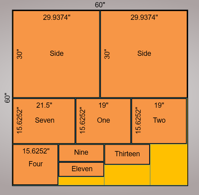

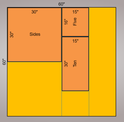

Fastskiguy wrote: Fri Dec 16, 2022 6:27 pm Ok, if we're gonna do this I guess baltic birch it is! Now it looks like if we get true, square 60"X60" sheets and we don't include the kerf in our calculations that you can get a 16" T30 out of 1 1/2 sheets with close to zero waste. Does anybody know offhand if that sounds right?
Accounting for and including a 1/8" kerf, it will take 3 sheets if you stay 100% dimensionally true to the plans.
However, if you make your sides 30 by 29 and 15/16" (instead of 30x30), you can get it done on 2 sheets and still have material left for bracing.
Dimensionally true to the plans cut sheets...

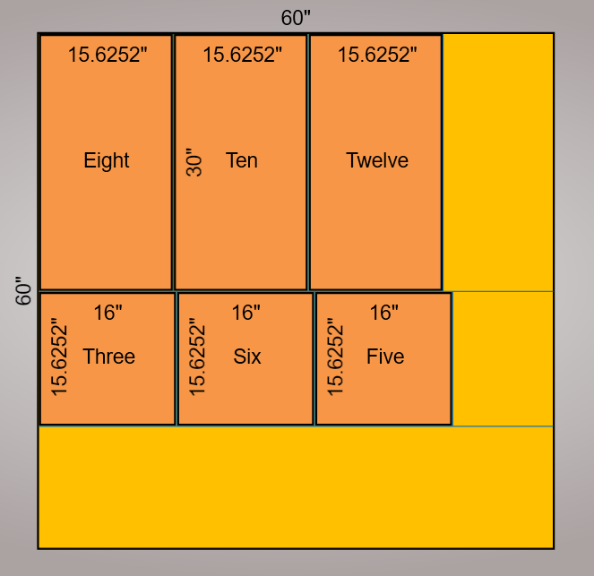

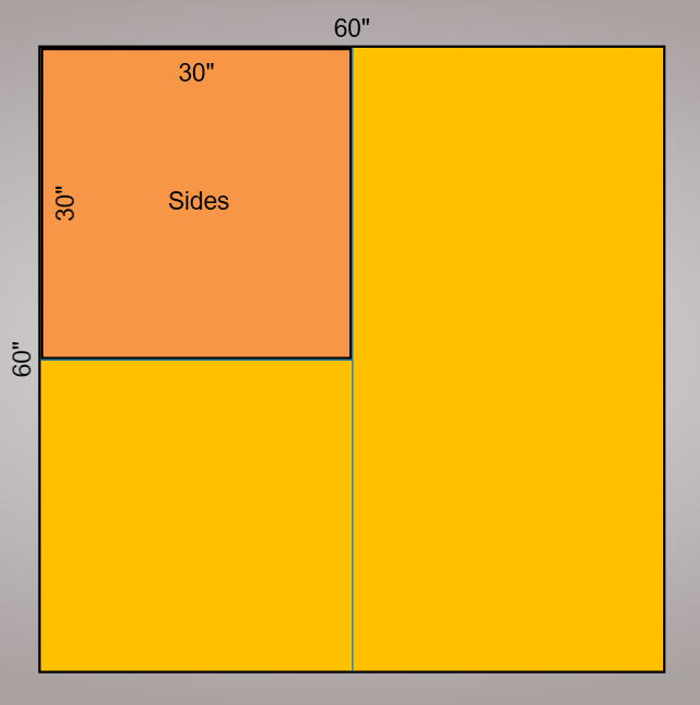

If you did the sides 30x29.9375 (15/16), you could go as wide as 16 and 5/8 inches total cab width and still keep it on two sheets. It looks like there's still plenty left over for bracing too.
Adding just one more eighth inch to the total cab width, bringing it to 16 and 3/4 inches wide, makes it a 3 sheet cab. So, 16 and 5/8 inches is just about the maximum total cab width to keep it down to a two sheet build with the modified side dimensions.
I used the free version of MaxCut to produce these cut sheets. There seems to be a slight glitch in the decimal translation of eighths and sixteenths, putting a 2 or 4 on the end where there should be a 0 or 5... but, whatever. Not like you're going to be able to get accurate cuts down to the ten thousandth anyway. :roll:
