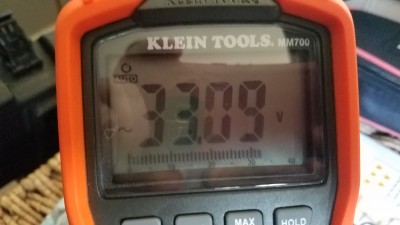

#28 Post by howiez »
Ok, we have voltage now. I'm getting intermittent readings of over 70v with a 60Hz sine wave.
I have the amp gain set to 11.
I have all EQ and AFS turned off. I have level of tops and subs set to 0.0dB in the crossover.
I'm getting yellow clip lights on the sub/low channels on the Driverack.
The focusrite Scarlet set my windows volume to 100%. I'm using it's volume to control the level into the Driverack.
But at like 1/3 volume i'm getting clipping, before i even get to -20 on the Driveracks display, that doesn't seem right.
Is it possible my test tone is crapola?
I dragged the limiter threshold down until I hold near 48v, when I try 49, it jumps occasionally to 50/51?

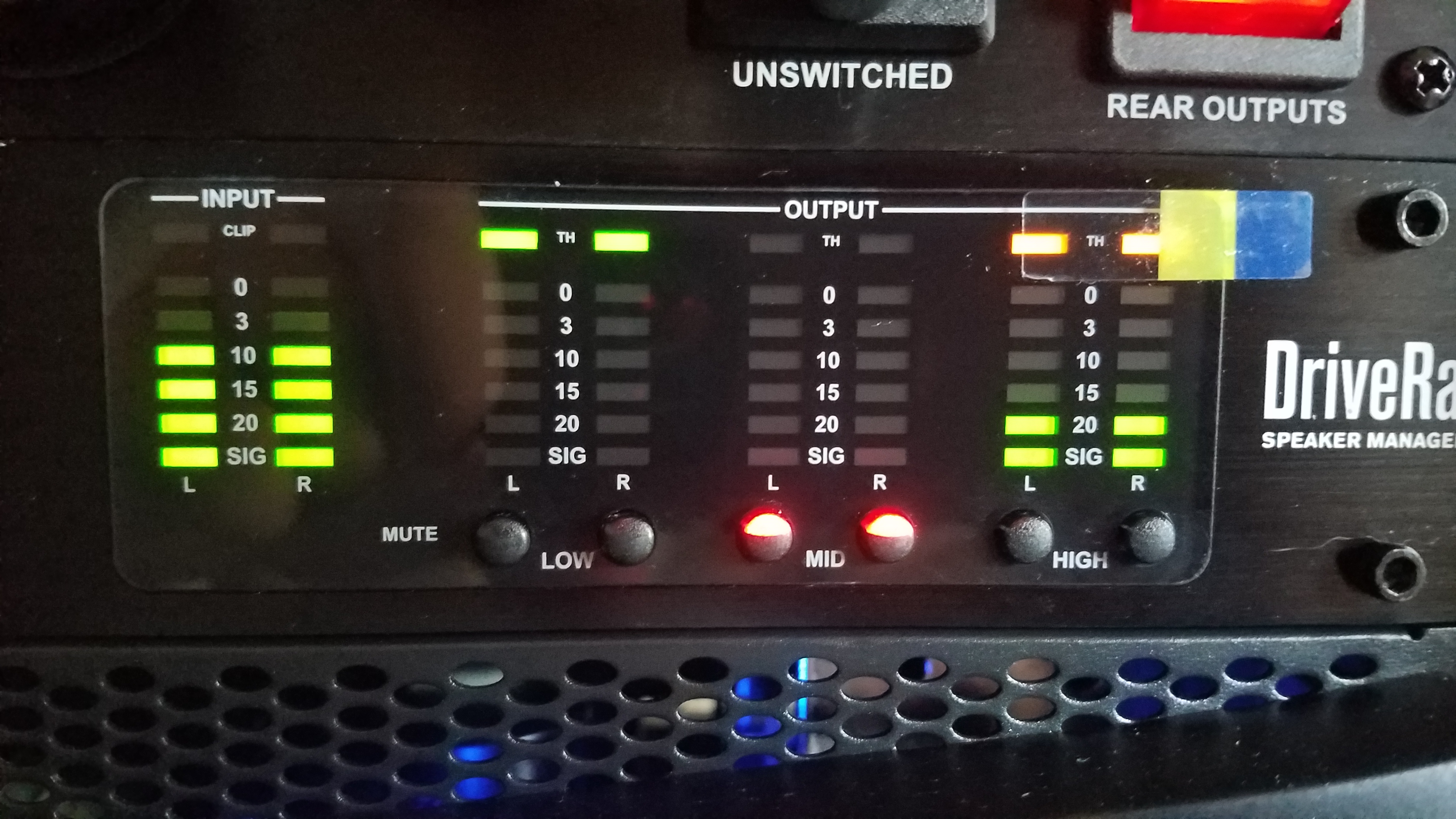

#29 Post by howiez »
I think I have my problem, file i downloaded was 0dBfs, I think i need -10dBfs to be 0dB?
So the file itself is set to clip levels?
Or am I misunderstanding?
howiez
Posts: 382
Re: Laptop to Driverack PA2 setup help (levels)
#30 Post by howiez »
Ok, maybe i'm not clipping, I thought the orange light for each channel was clip, but it's green, then orange for Threshold. I guess that means my overeasy limiter is working.
I also just realized, now that I have a pre-amp/line out, I never turned the DBX back to 1.4v, which would explain how I get high levels so quick. I'll change it and try again.
But I'm still curious about what level of test tone I'm putting through, maybe my 0dBfs was fine, I'm just coming out of the USB box too hot now.
That can't be the case though, since it's RCA L/R, that would be consumer level or -10dB correct?
DBX levels at wide open throttle
Crown XLS 1502 voltage with limiter on
