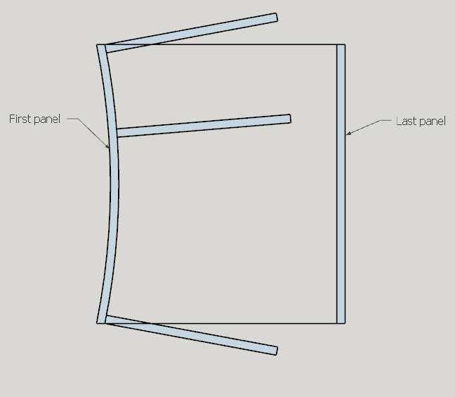

The curved back-panel is starting to fuck with me now, as illustraded in the attachment.
I think the solution will be to fasten a panel on the outside of the box, and remove it when the whole thing is done. I guess this is the perfect use of the little triangular spot that's not used in this horn. I will be able to remove the screw inside the mouth, and the other screw in this triangle on the outside.

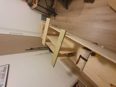

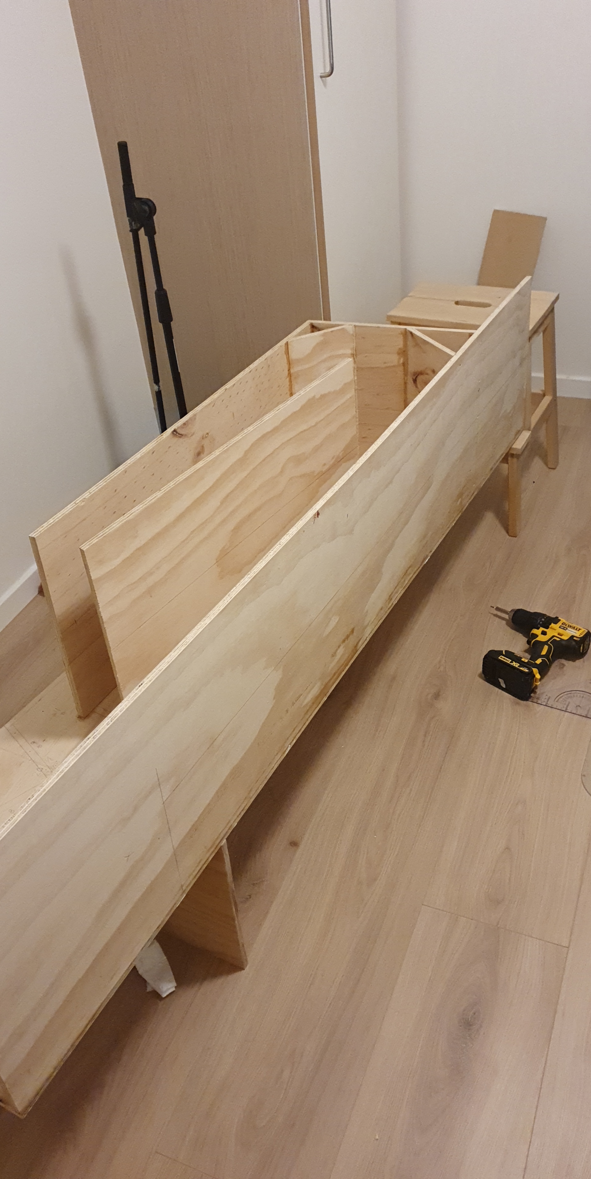

Well. It worked! There's still some bending at the MDF i put on top to measure it - but i has helped tremendously. It will be quite annoying to work with though.

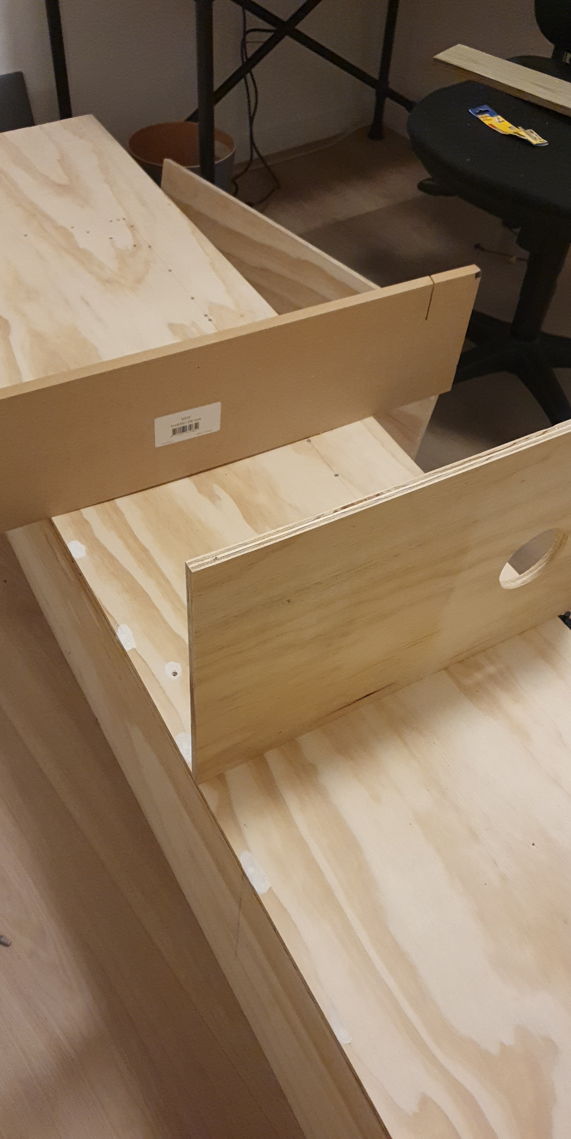

I'll have to eat my words. It actually ended up helping me. It creats a fine stand, so i can screw the panels from underneath.
I've cheated a bit, and attached panel 7 before 6. I couldn't see any reason i should be able to do this.

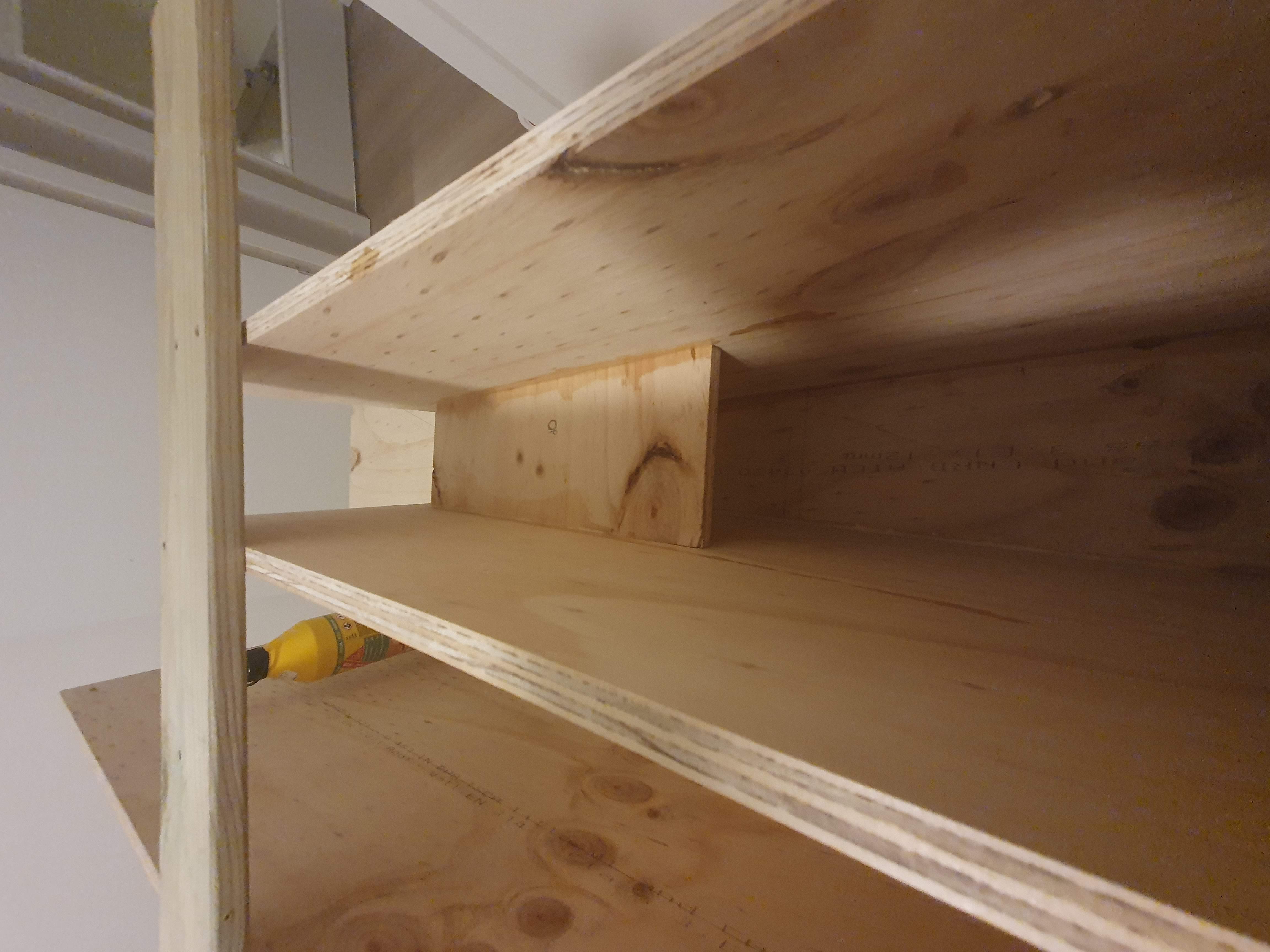

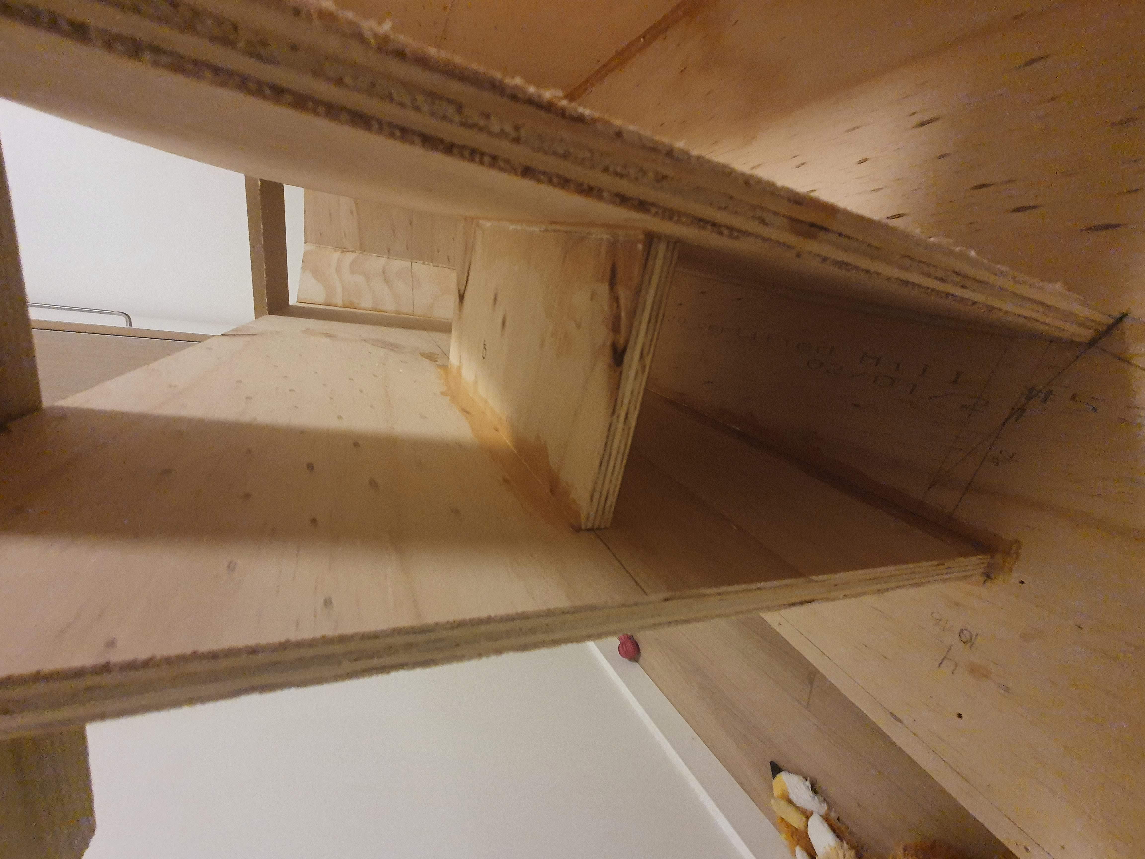

That's it for tonight.
I'm really happy with the centerlines i drew for the braces. I measured the brace, and marked where it's supposed to fit. I then used the brace to unwarp the panel.

On my first build I made the mistake of cutting my braces to the plan's dimensions then forcing them in like a wedge. Caused the mouth to bulge out. Nobody noticed it, but lesson learned.JensToft91 wrote: ↑Wed Jan 19, 2022 3:44 pm That's it for tonight.
