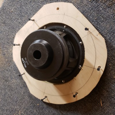

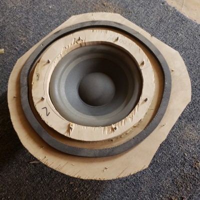

by Strange Kevin
Hey ACUA,
Wanna say I fully support your experiment here!
Good Luck!
There was mention of building reducer plates to test an MCM in a cab your already have.
I did just that for my TTLS, I got lucky and found a deal on a NOS Eminence HL10c, so of course I'm gonna use it!
But still wanted to test a spare MCM driver to compare.
so I took 5 minutes and threw one together.
Here's some pictures,
Obviously, You can take 5 more minutes and put together something much more presentable, but I wasn't too concerned with how it looked at the time...
In the unlikely event you're not satisfied with 8" drivers in your new T45s, you may consider cutting the baffles for a 10" driver and using a similar reducer to keep the option open for a BP102 or something else in the future.
Just my 2 cents.
Good luck man!
I'm keeping an eye on this one!
