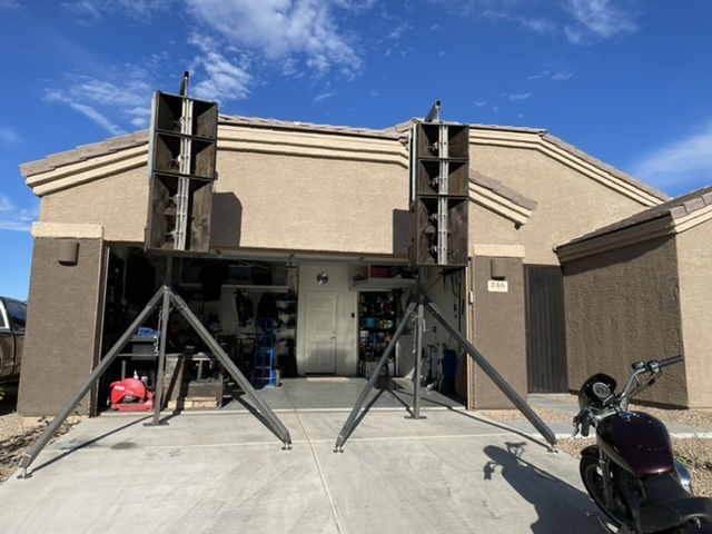

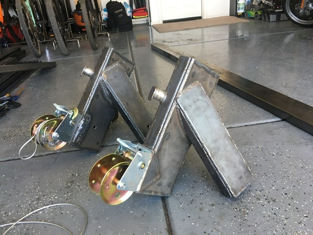

I built the stands myself. The one picture shows me flying both stacks in front of my house the other picture is the middle part of the stand. I built it out of L- channel and flat stock all 1/8in thick. The legs and neck insert and pin into the middle part. The winch mechanism is not as robust as it may aught to be so I put a loop in the cable so that once the speakers are at full lift I hook the loop to an arm I built onto the stand so that I can unload the winch while in use. The cable and winch are rated for 1200lb and my array is under 250lb. The top of the stand is 12ft. It’s some work but flying the rig is awesome. The rear leg and neck is 2x6 and the front legs are 2x4. Not sure what gauge but the wall thickness is roughly 1/16in. I have hung and or swing from the top trying the integrity. The legs span 7 ft wide and the rear leg is 8 ft from the front two legs. The center is plumb bob verified ti be just rear of center the triangle by 3 inches. The front legs have some adjustment about 3in for leveling.
I will build one cab to start if it goes well we can discuss what comes next. I would value a meet up someday, bring it on.

They are awesome. Looking at it, it looks like the legs could be made to fold down and the top fold back (if the winch wasn't there) for transport without disassembly. Something like that in aluminum would be sweet. I completely dig your design :thumbsup:

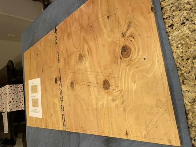

I cut the two sides out and laid out the one side. I shall dado this one but not the other side.

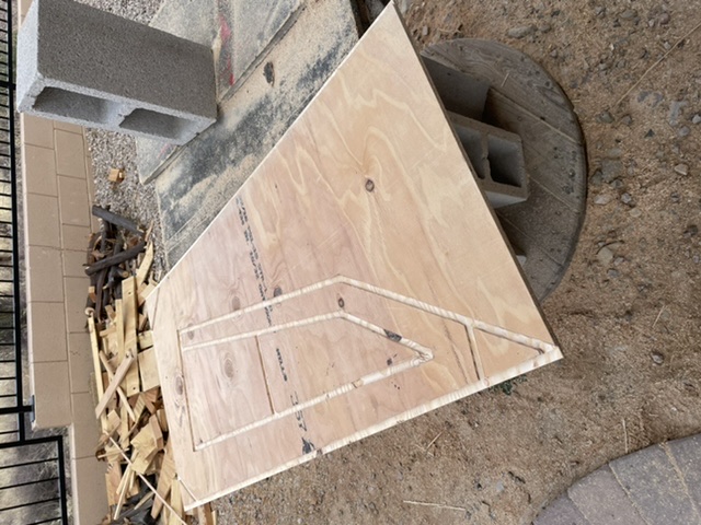

#26 Post by ACUA »
A week, no, a few weeks yeah sure I will have one build to fit the little 8” driver that could.
Headed to the lumber yard for a sheet of 5ply. I dado routed the base side today. Pretty straight forward.

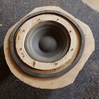

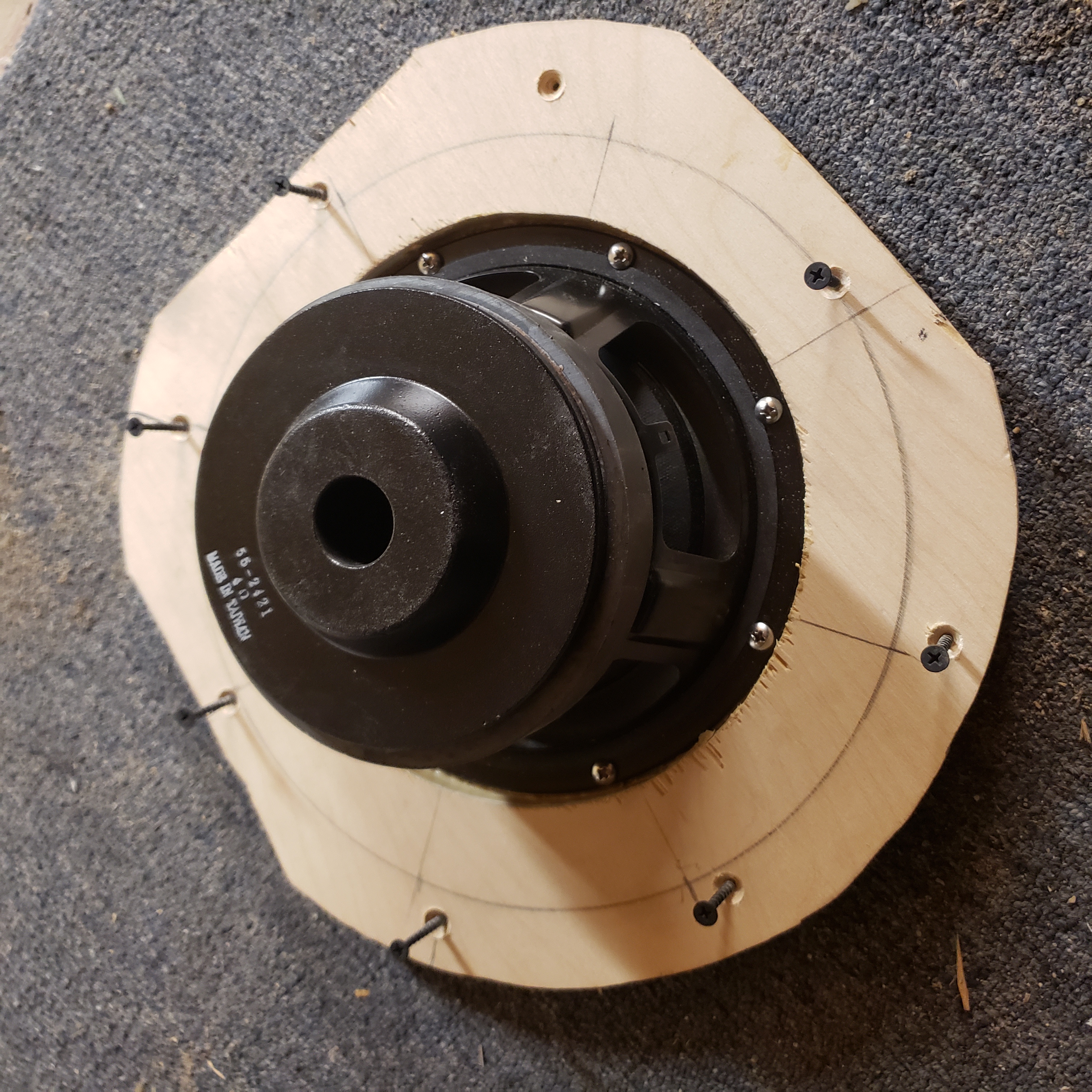

There was mention of building reducer plates to test an MCM in a cab your already have.
I did just that for my TTLS, I got lucky and found a deal on a NOS Eminence HL10c, so of course I'm gonna use it!
But still wanted to test a spare MCM driver to compare.
so I took 5 minutes and threw one together.
Here's some pictures,
Obviously, You can take 5 more minutes and put together something much more presentable, but I wasn't too concerned with how it looked at the time...
In the unlikely event you're not satisfied with 8" drivers in your new T45s, you may consider cutting the baffles for a 10" driver and using a similar reducer to keep the option open for a BP102 or something else in the future.
Just my 2 cents.
Good luck man!
I'm keeping an eye on this one!
