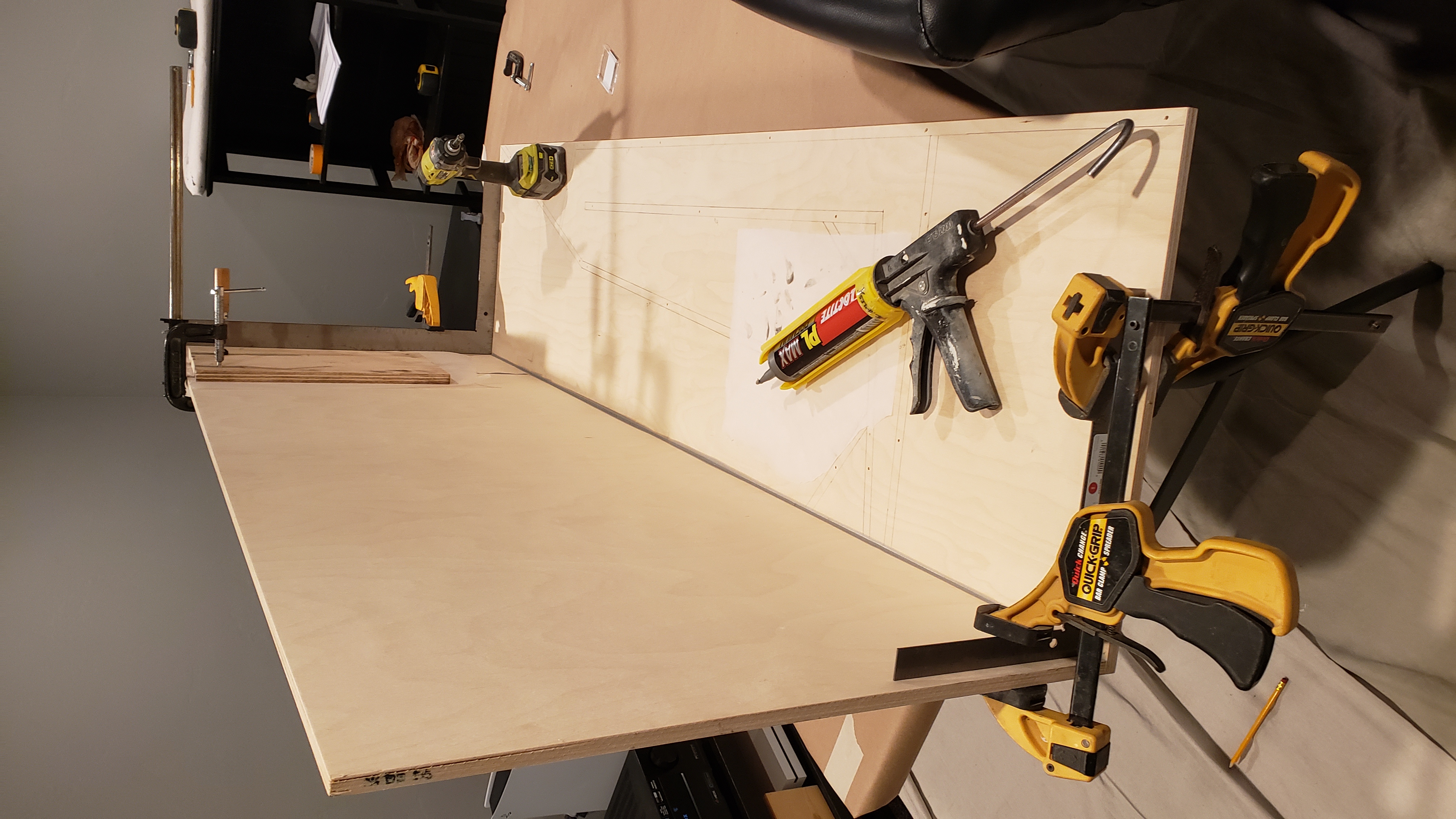

I think the "x8" and the "max" are different. The tube on the right is what I picked up. Is this what you have used?

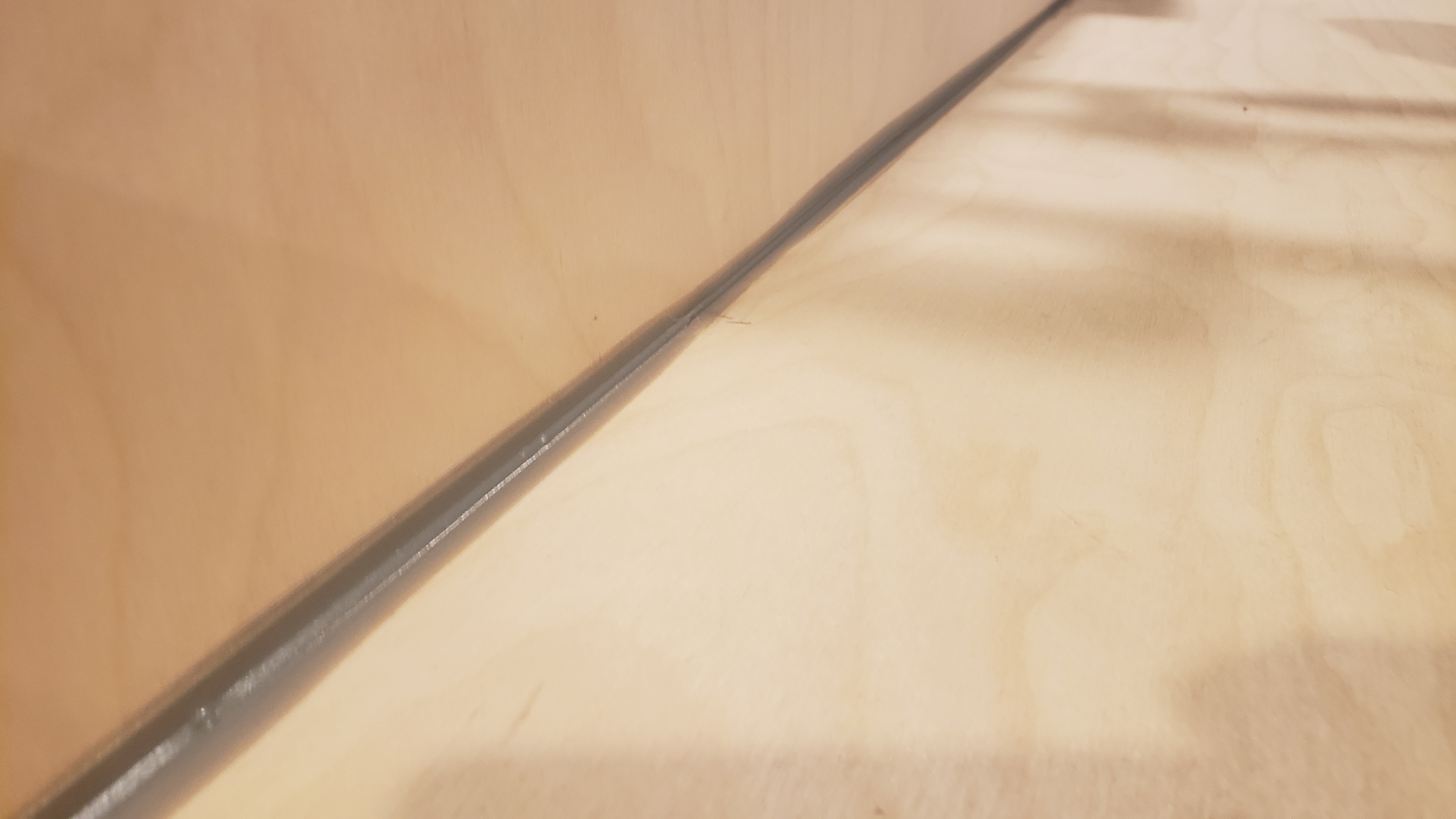

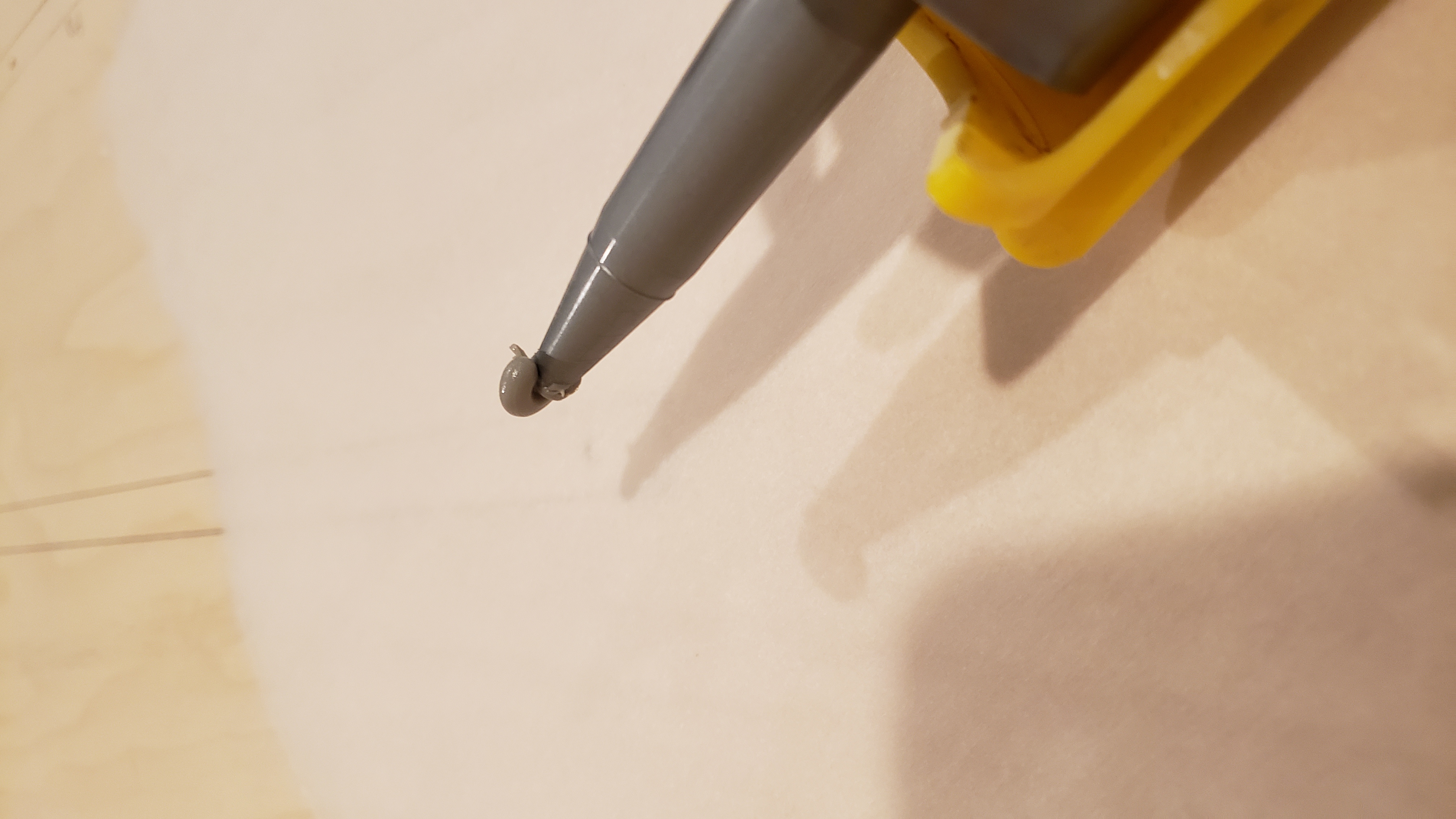

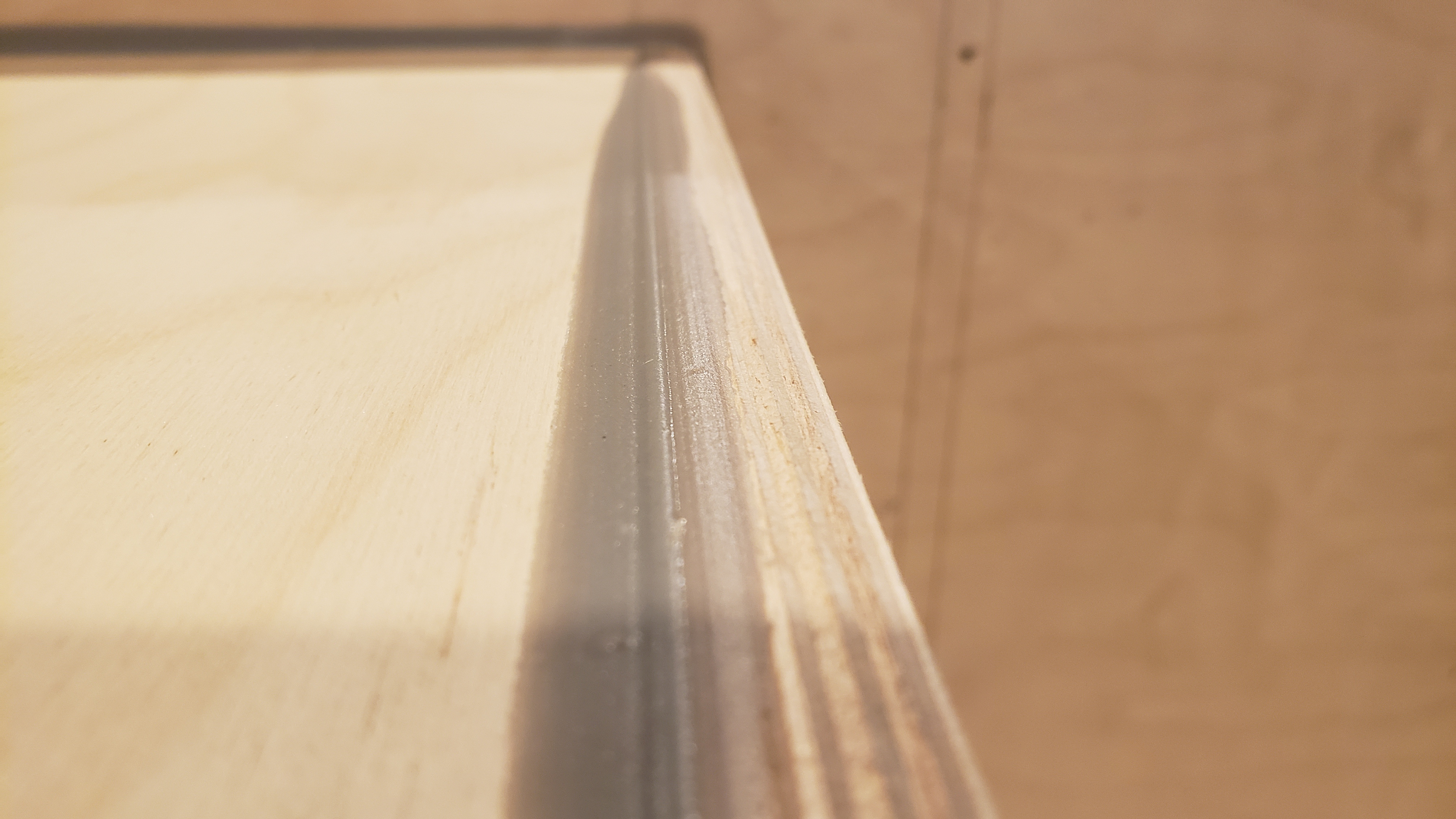

I got started last night and made some progress tonight. Panel one is done! The PL Premium Max is interesting. It seems much thicker than the standard PL Premium. It dresses like silicone and is slick like silicone. Almost no ooze from the tube (it comes in a plastic tube like caulk or silicone). The picture of the tube is after sitting for about 5 minutes. I'm seeing about as much ooze as latex caulk.

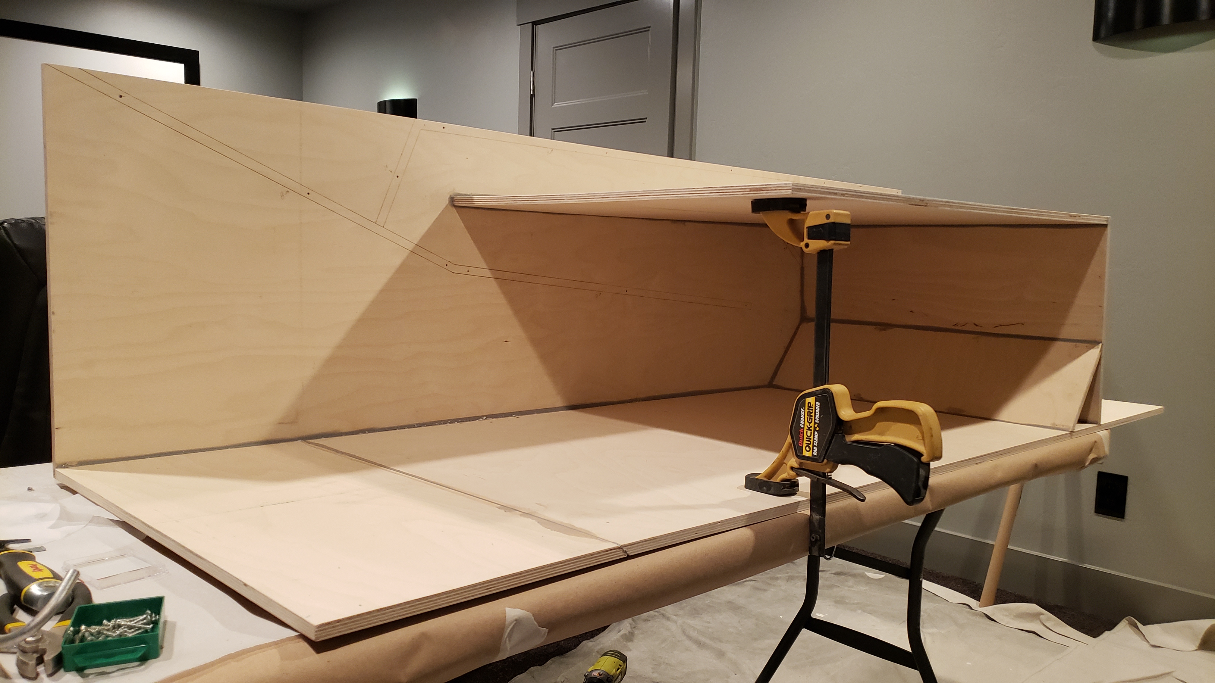

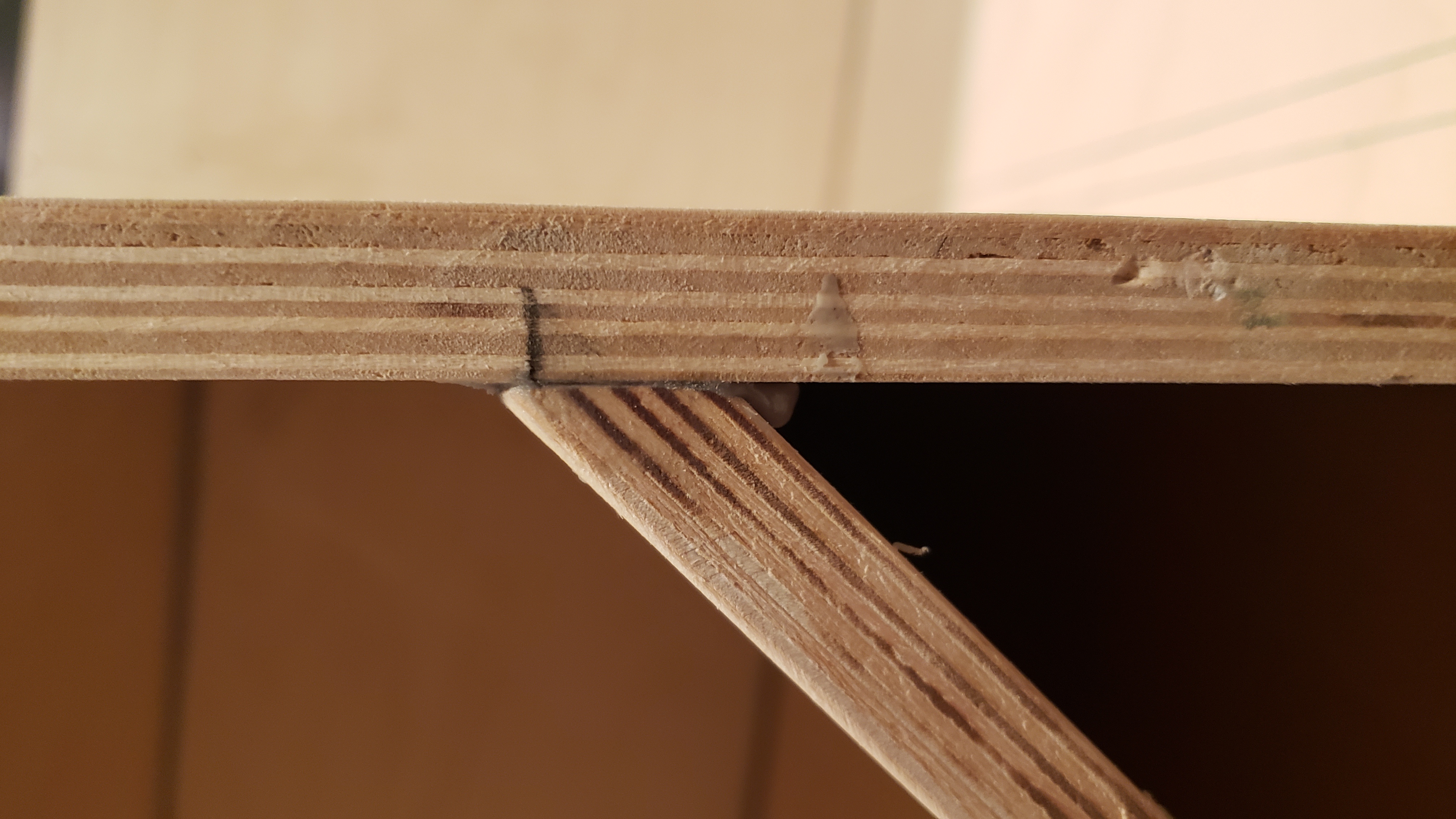

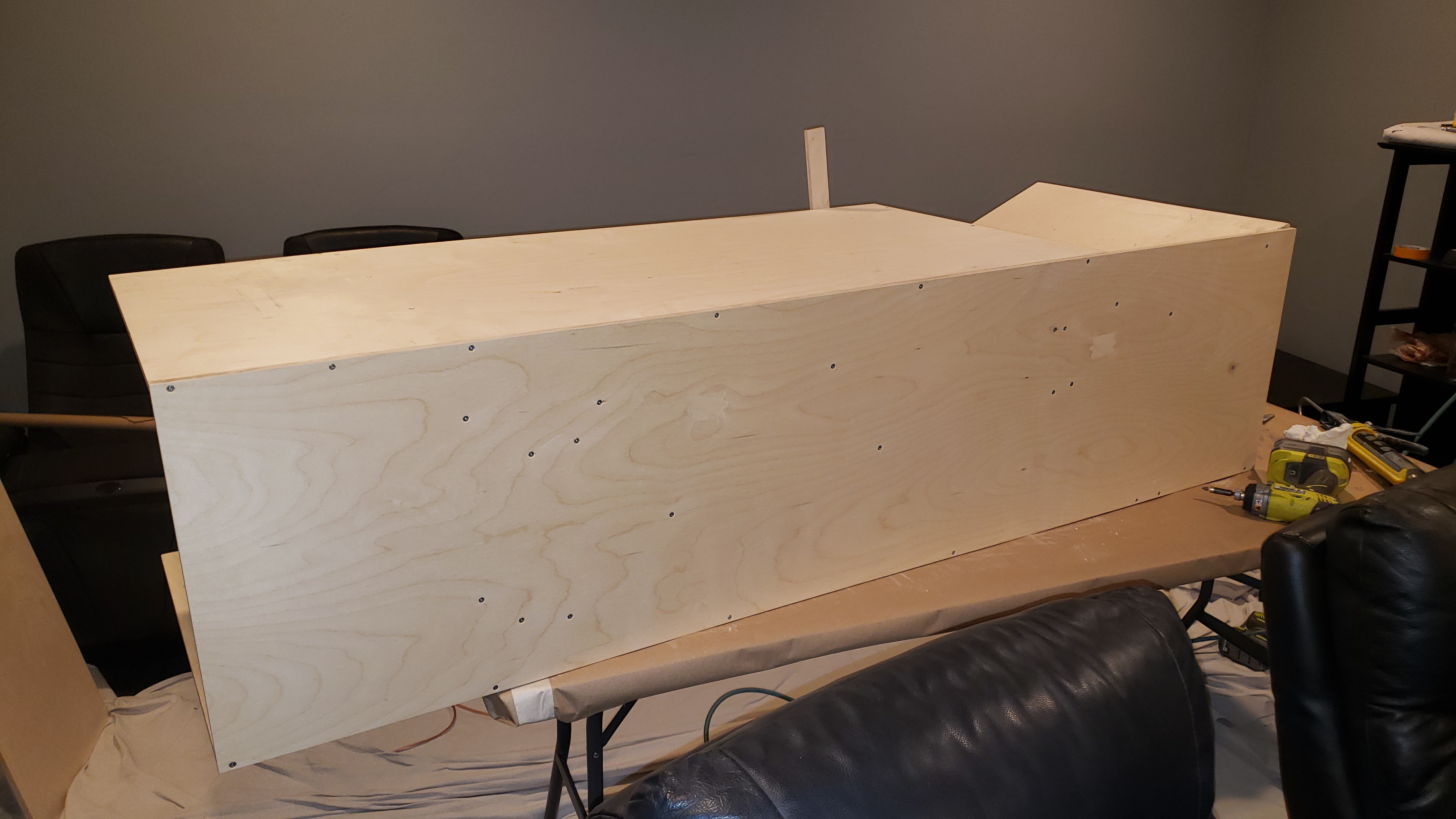

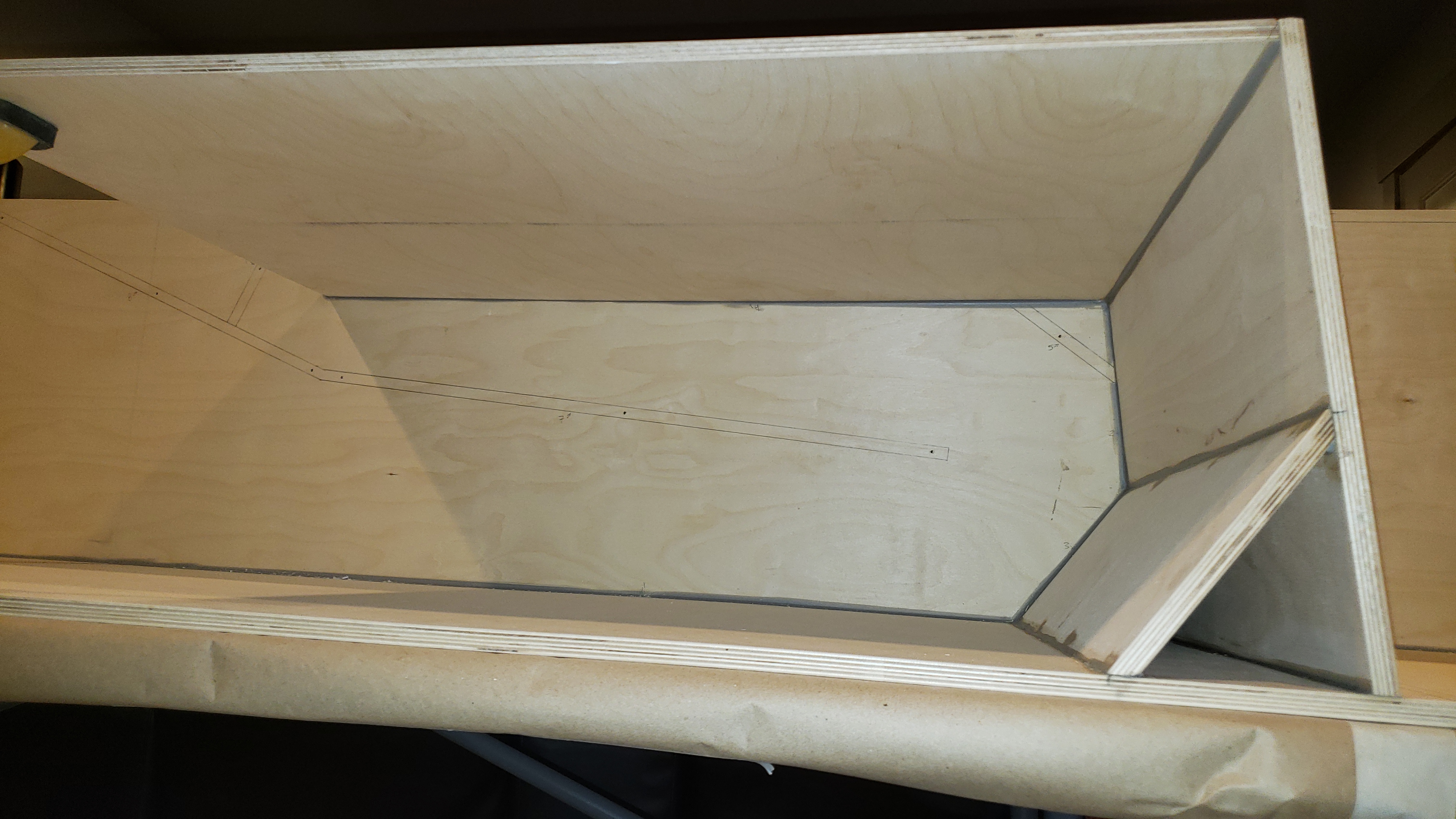

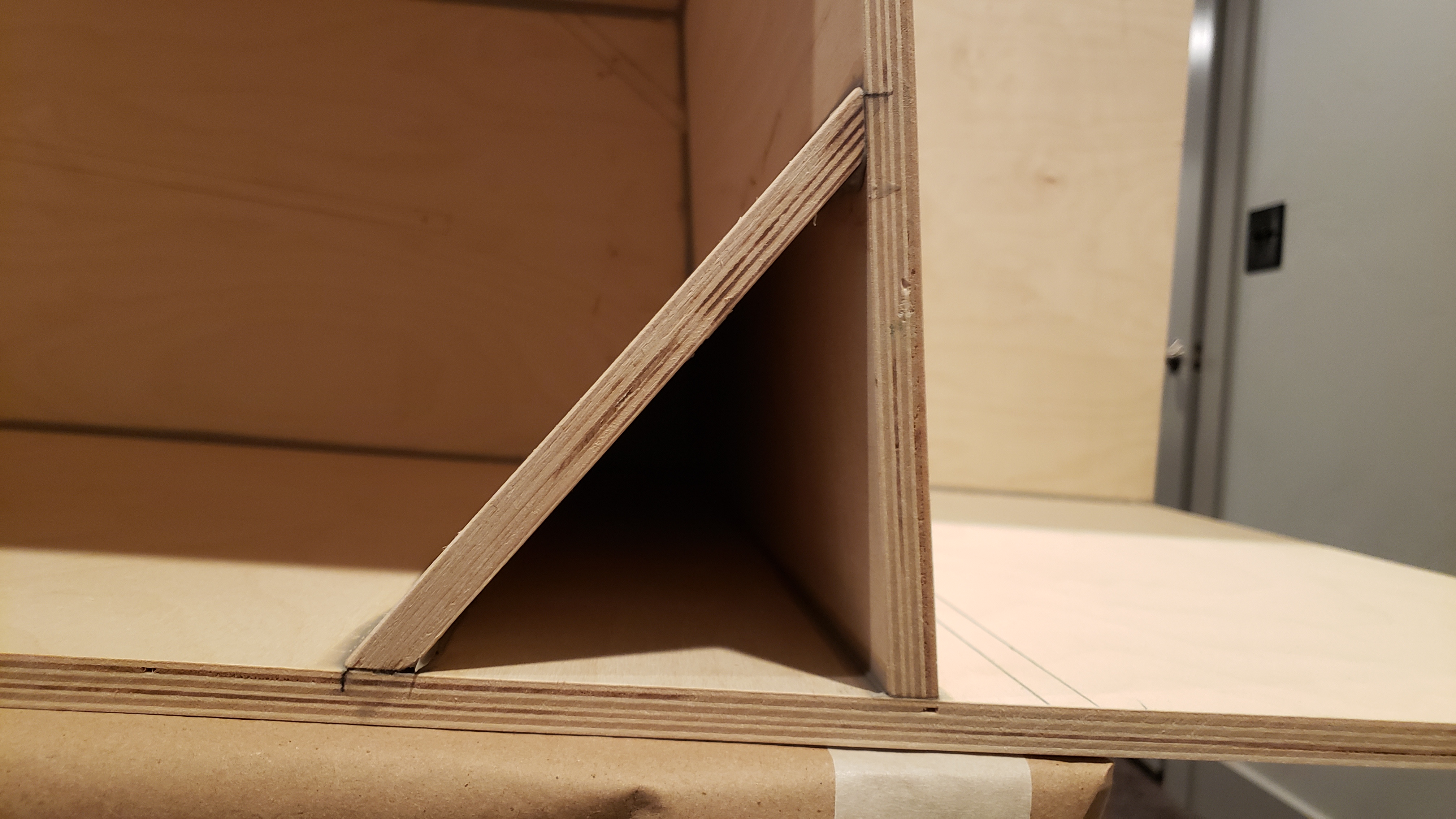

More progress last night. Panel three was tricky. I clamped a carpenters square in the woofer area behind panel six. Then I temporarily screwed a square scrap piece in the place of panel four. That squared everything up to install panel three. I fastened it with a screw through the side and one inch brads into panel one and panel two. I'm not a huge fan of the jigs... I dry fit everything with screws first before I glue. You can see in the pics that panel three was about 1/8 inch off from the line on panel two. It would have probably really thrown me out of square if I had followed the lines. I'm glad Bill makes a note of this in the plans... I probably would have just followed the lines and been out of square. I like the PL Premium Max. I don't think it expands quite as much as the original PL but I'm seeing expansion.

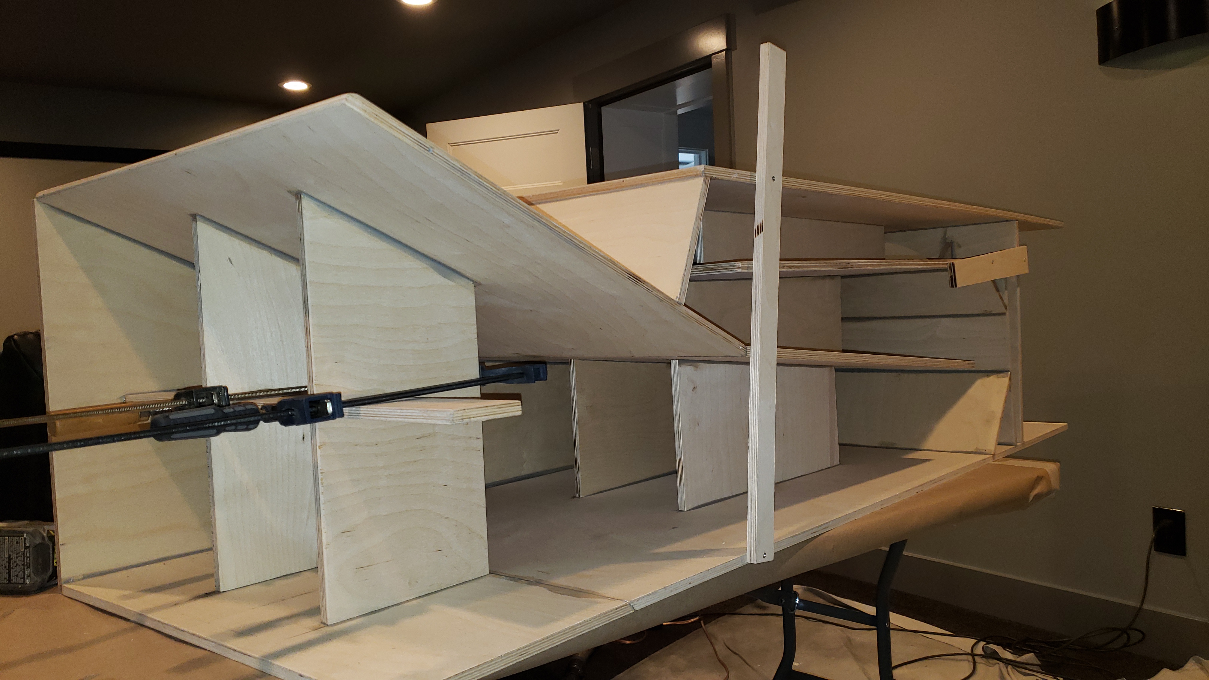

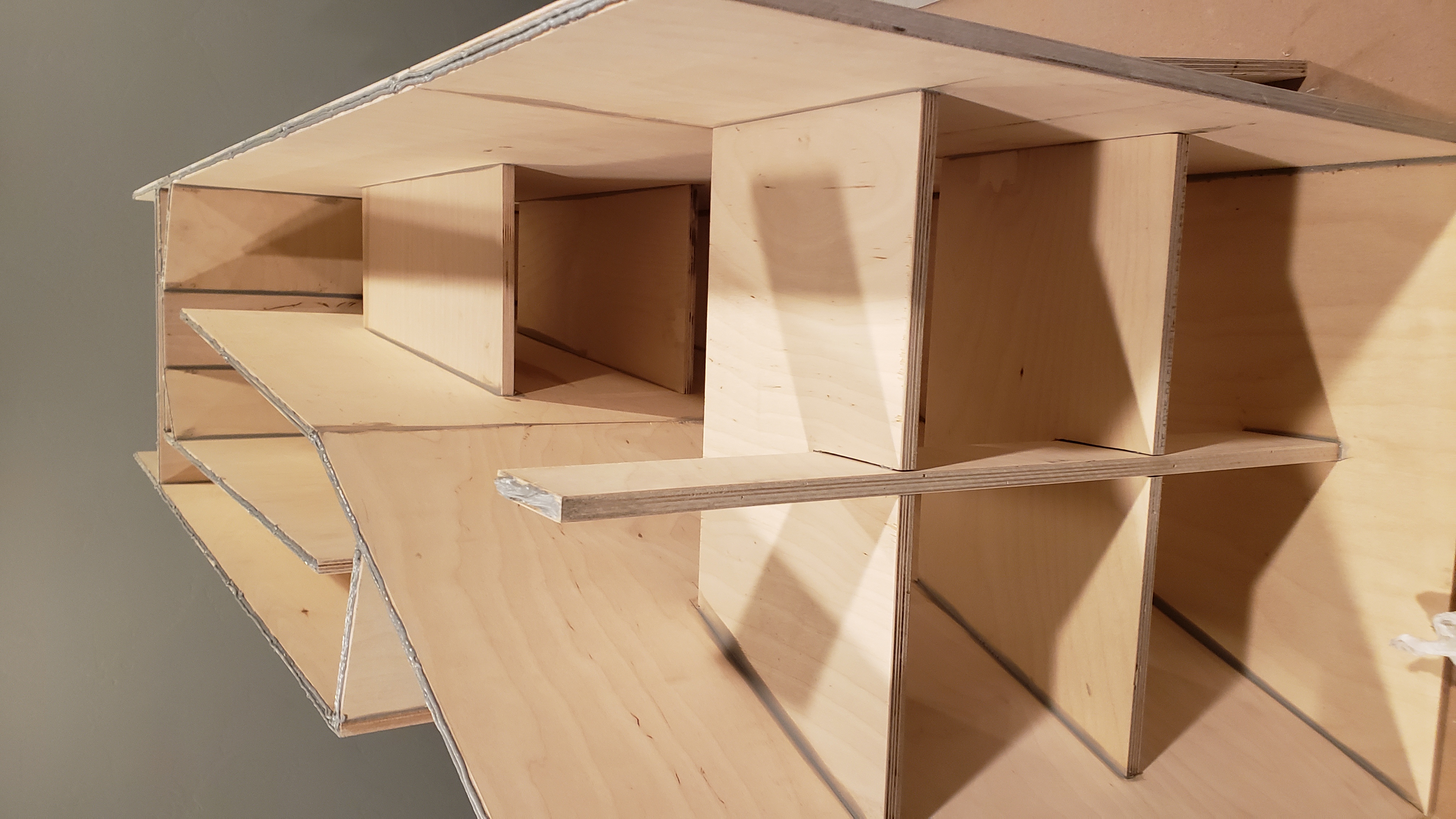

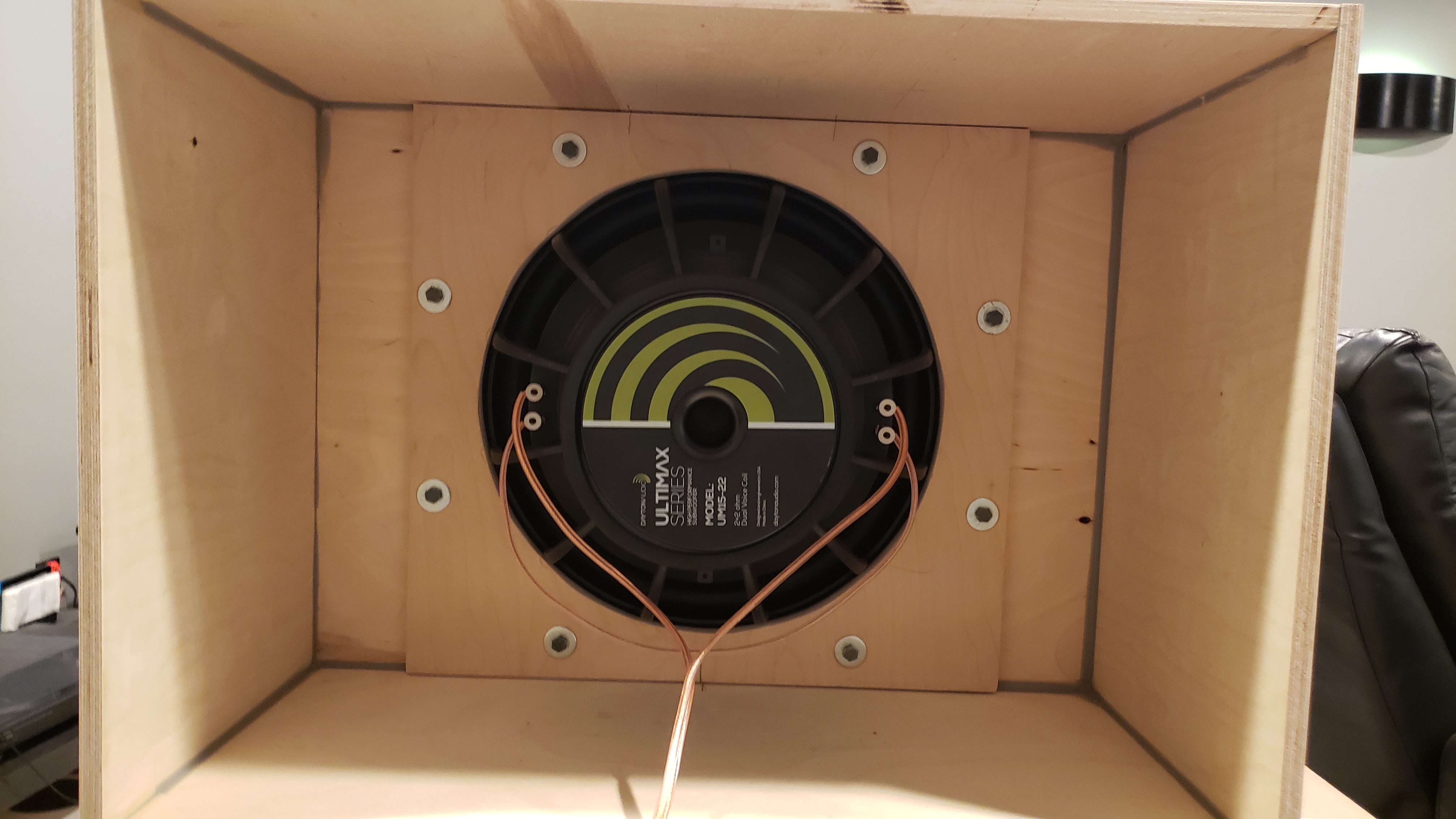

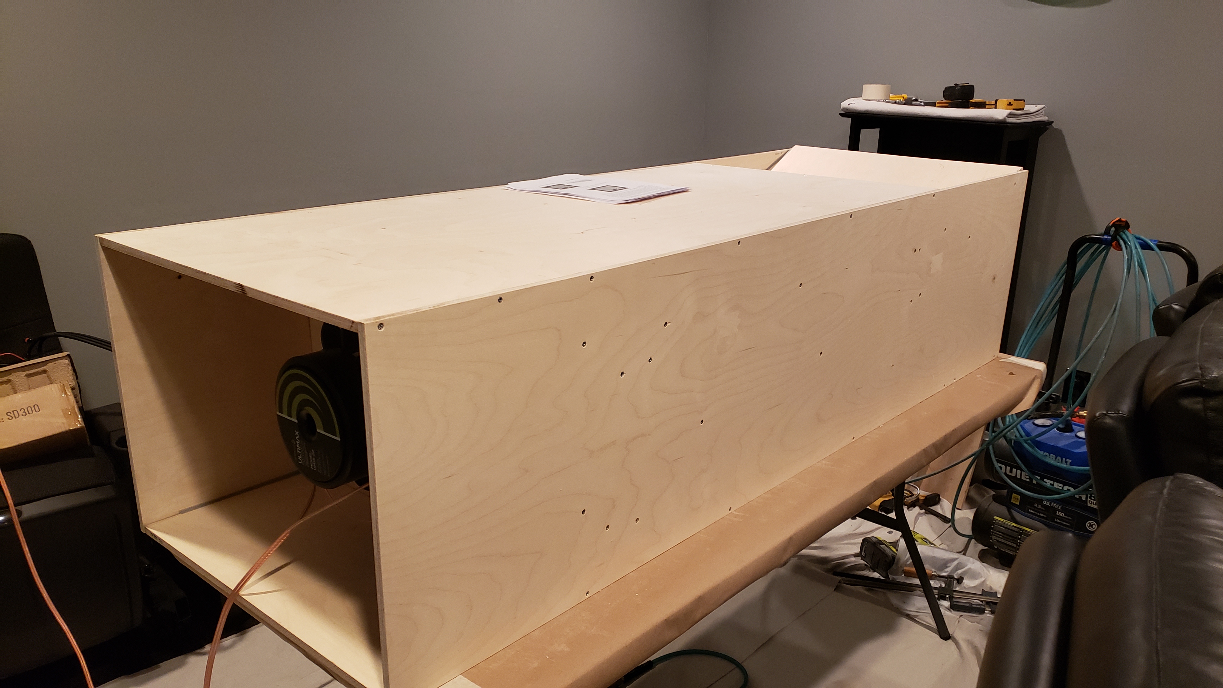

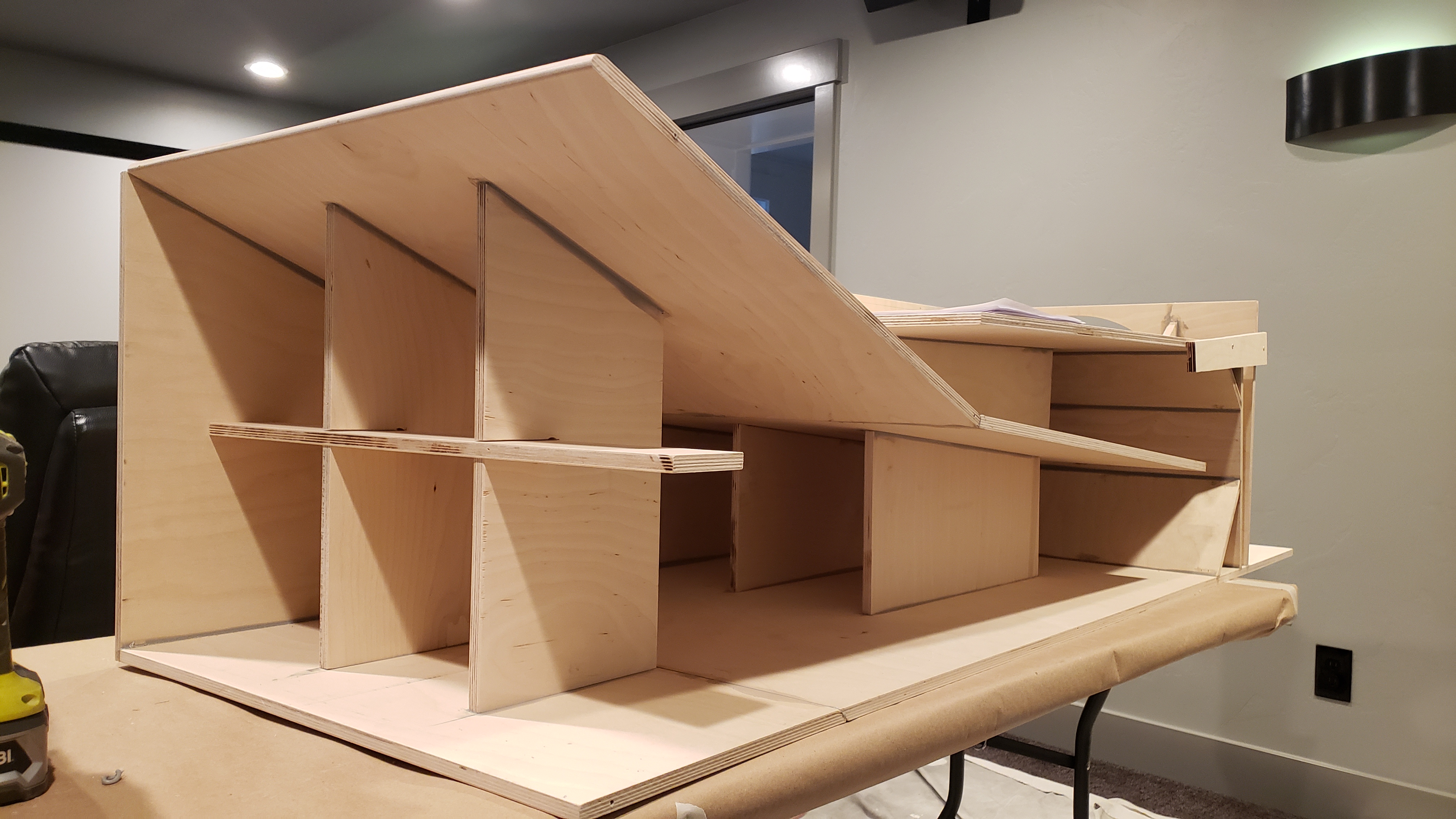

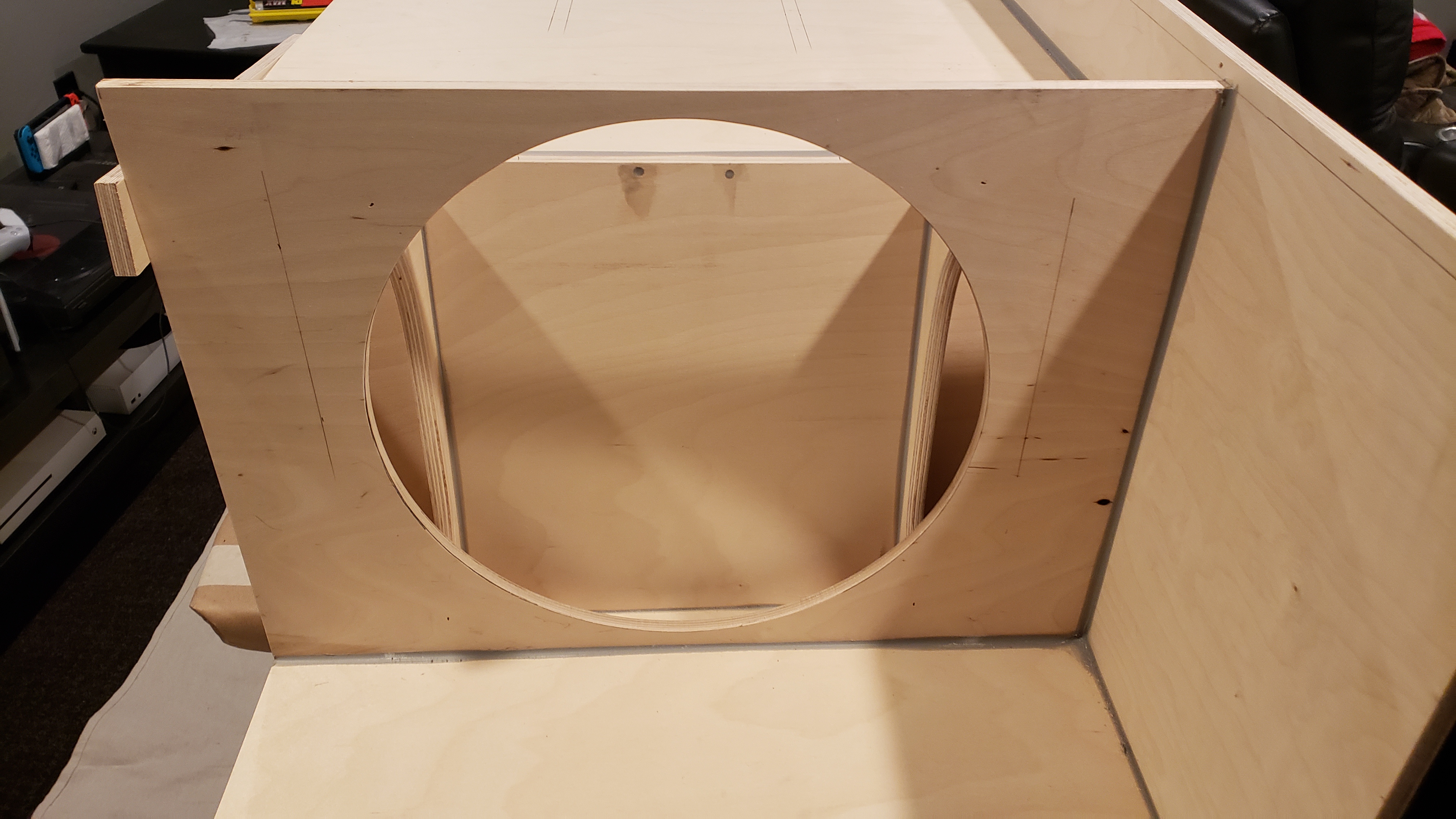

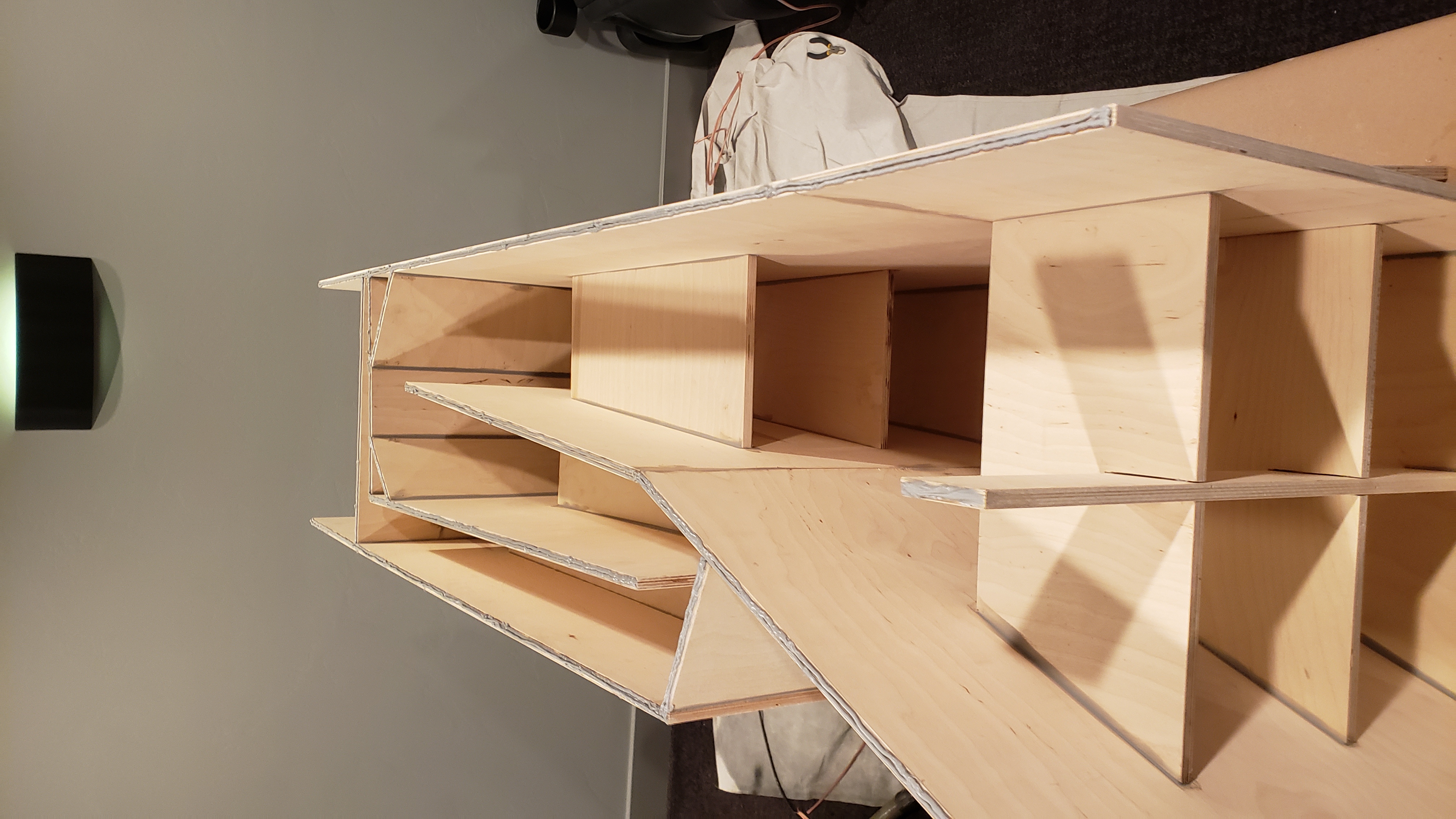

I have the majority of it together. I still have all the work to do on the chamber braces, cover, etc. I had to space my 2/6 braces pretty far apart. The rubber surround on that dayton ultimax is no joke! Even with them spaced apart I still had to notch them pretty deep and taper them with my sander. I decided to use t-nuts to attach the driver plate to panel 6. I like the idea of being able to torque bolts down and not worry about screws stripping the wood out. I also made the driver plate larger than what the plans called for because my panel 6 hole ended up fairly large after adding 1/4" to the speaker cage size. I'll have some tricky work with the chamber braces but I think it'll be okay. I ran it very briefly last night. Very impressive! (even without the chamber sealed) Here's some pics... sorry, they don't really end up in any order.

more photos...
