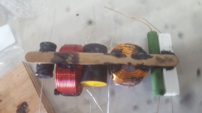

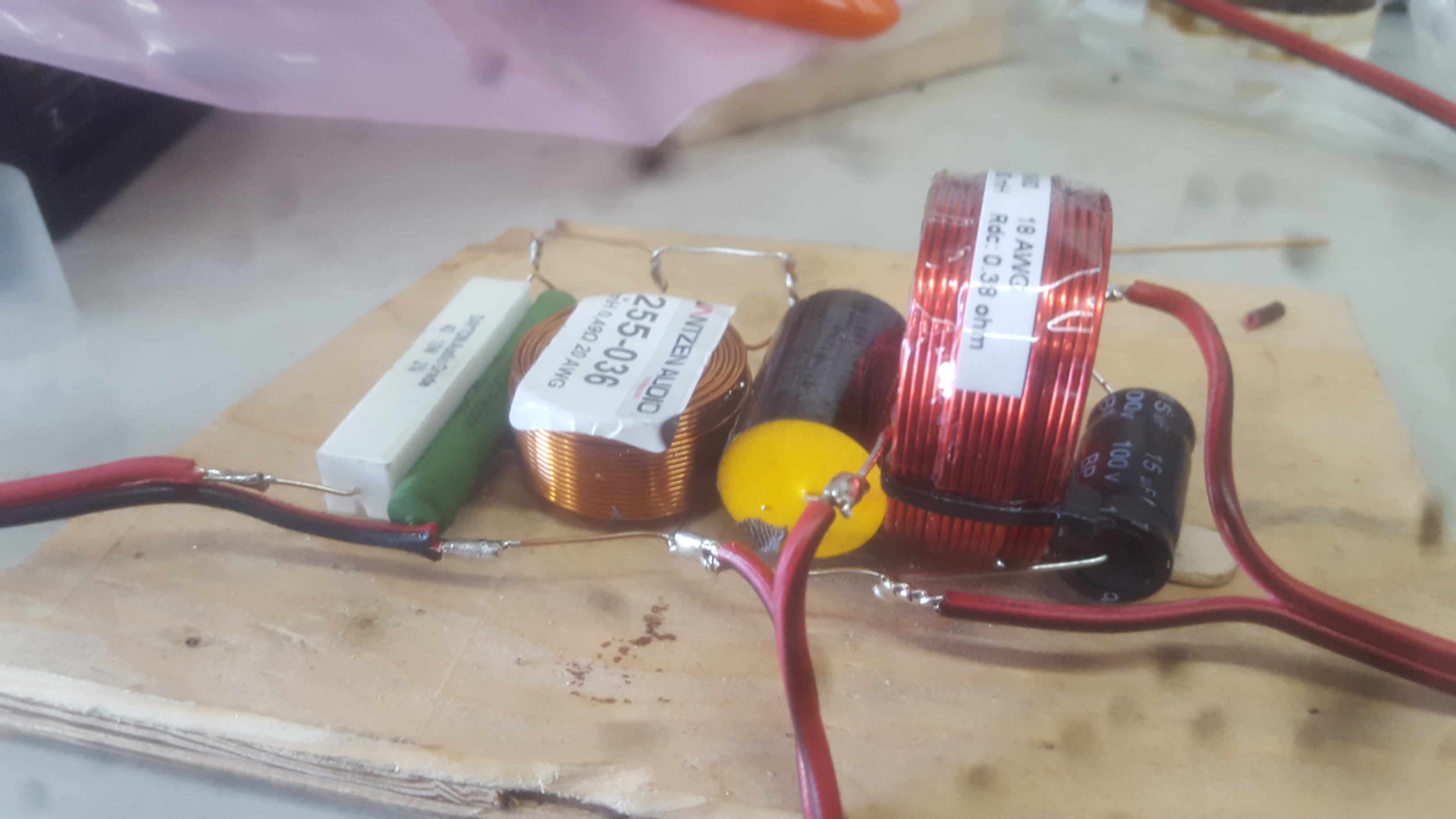

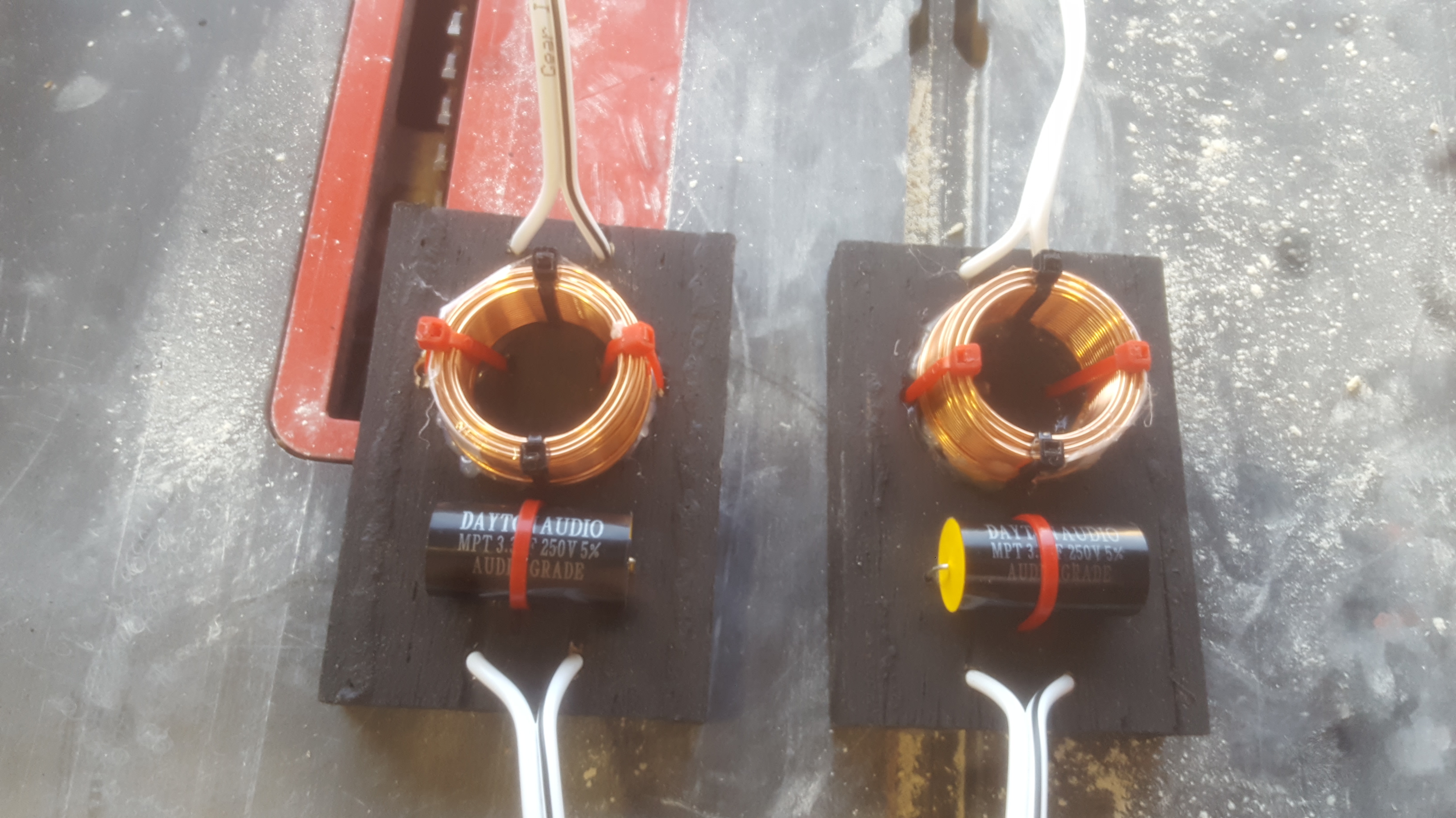

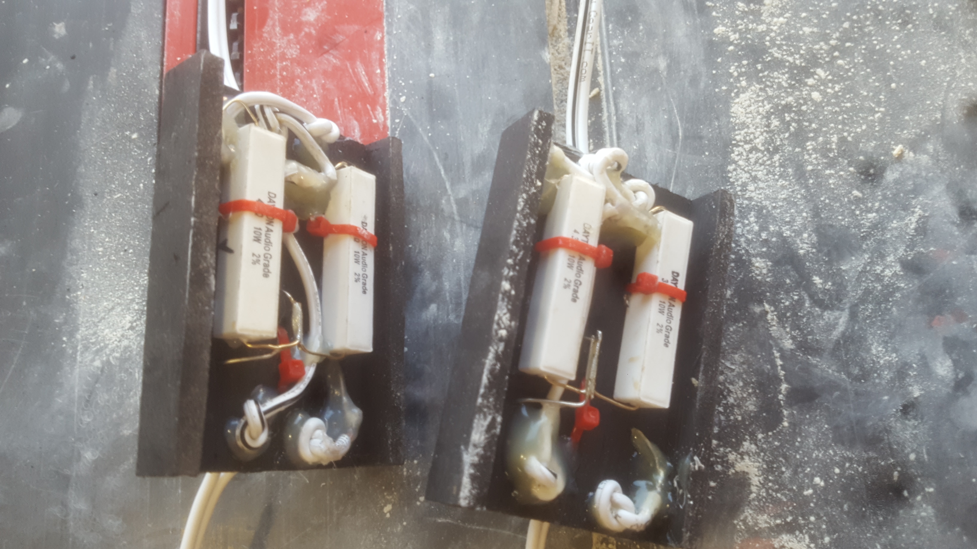

Here's what I did for my shorty 2x6 SLA Pro's, used both sides of ¼" ply on stand-offs
Here's what I did for my Wedgehorn 6 build, assembled on a popsicle stick

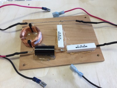

Here's Bruce's SLA crossover, which is almost exactly like the plans show
(Note to general reader: There's a slight wiring error in this photo, do not use as a circuit wiring reference)

Seth wrote: Sat May 01, 2021 11:21 am
Oh my gosh....that wiring error will haunt me for all my days......
