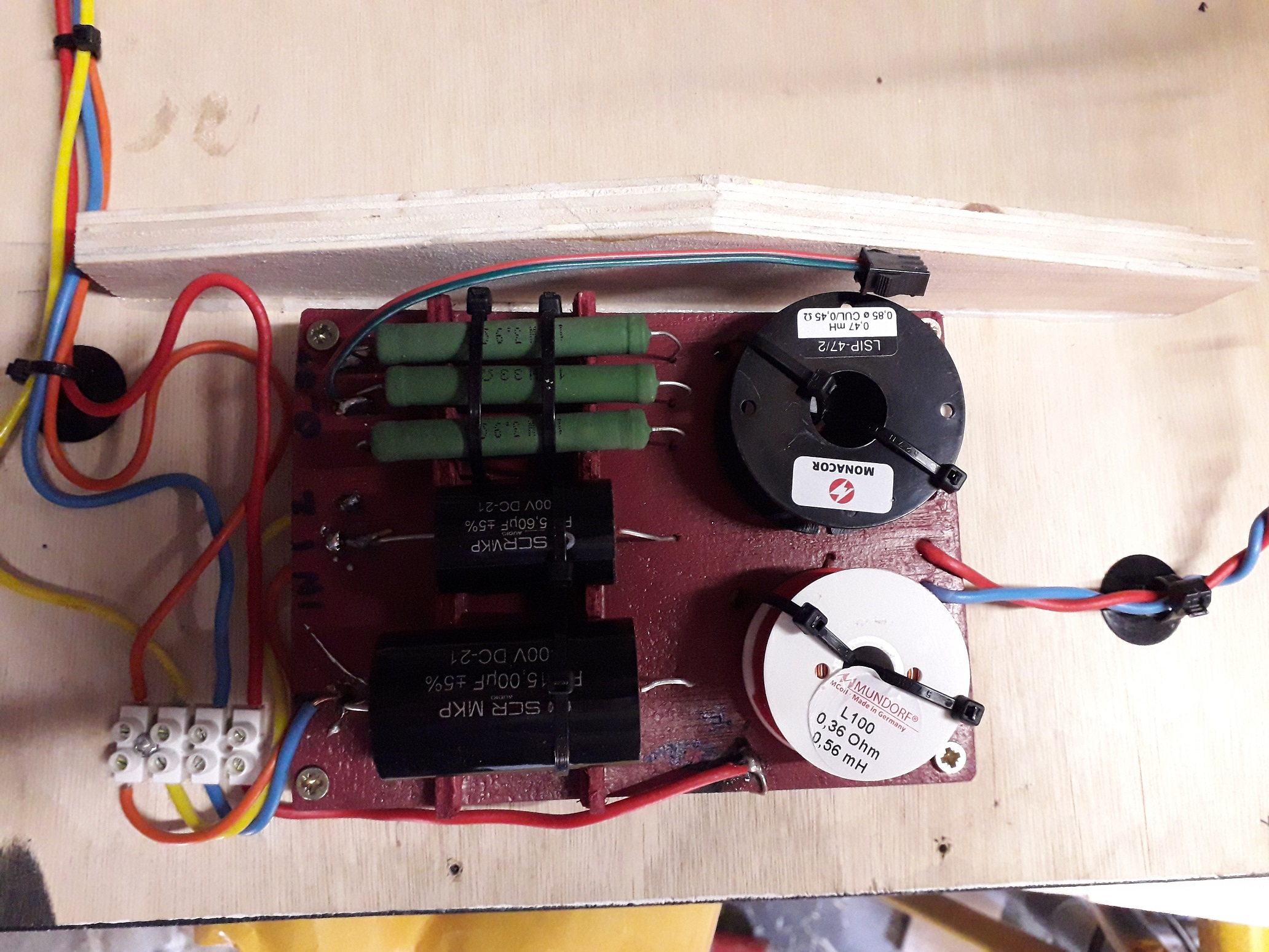

Some electrical circuit test (I build it with a 3 way switch : 1 no tweeter, 1 low tweeter (4 ohm resistance in serial on the high pass filter input), 1 full tweeter (direct input on the high pass filter)
I use mastic (sifka 1FC to seal the speakons)

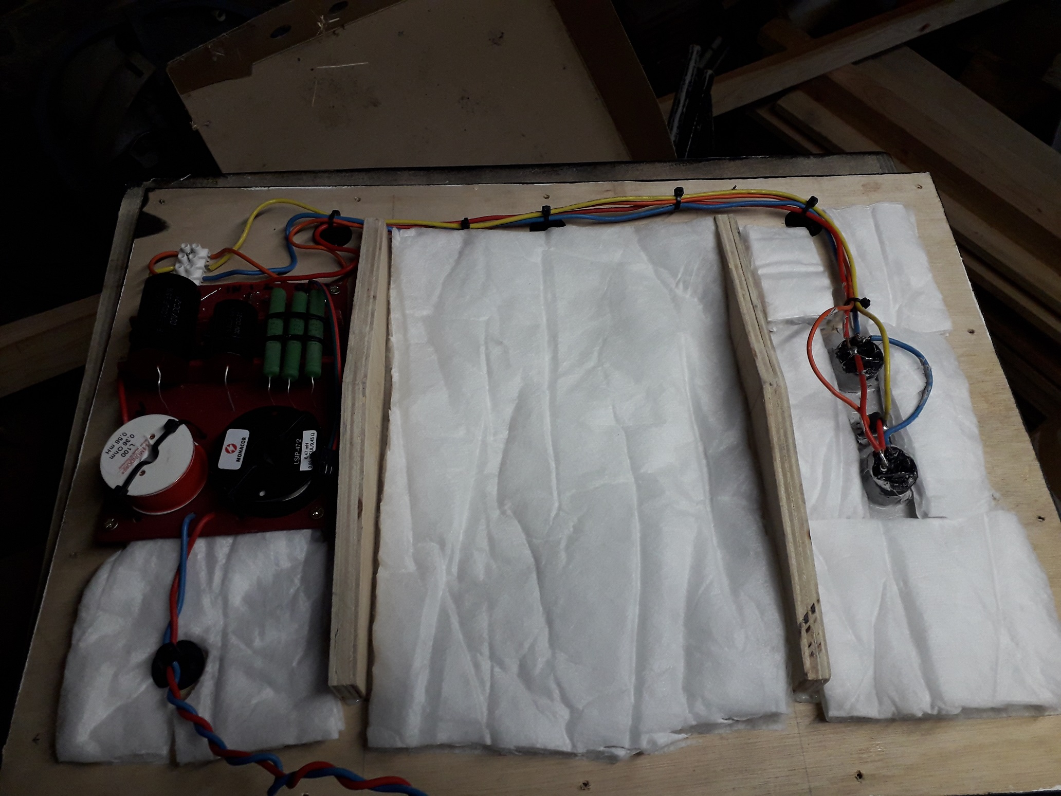

Focus on the circuit (low pass and high pass)

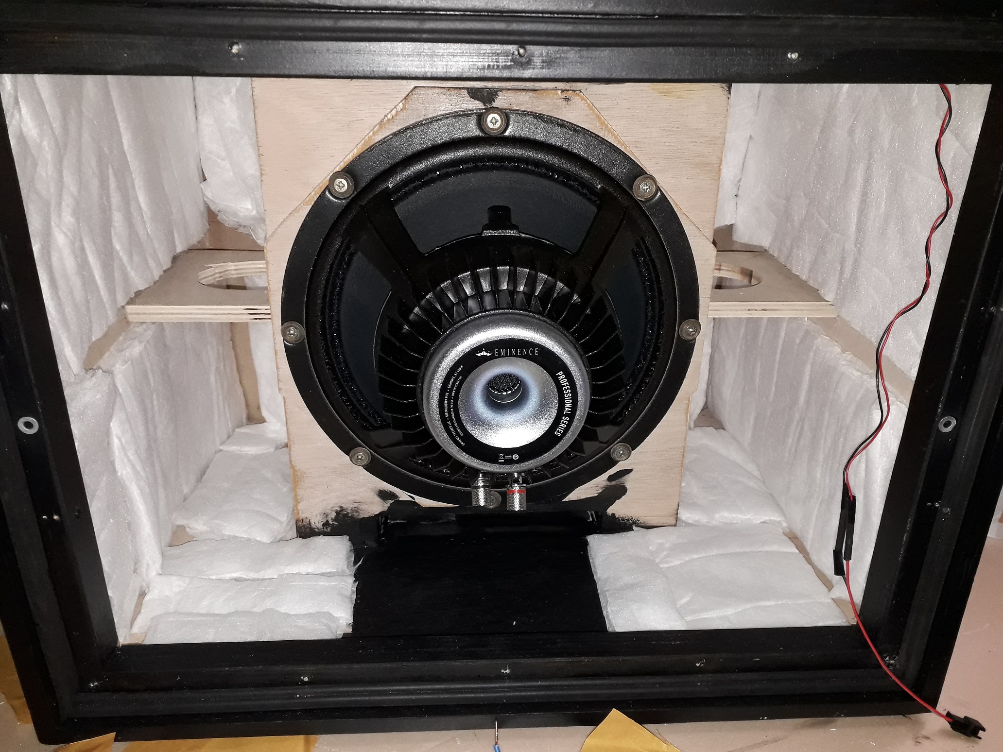

Final rear panel with insulation

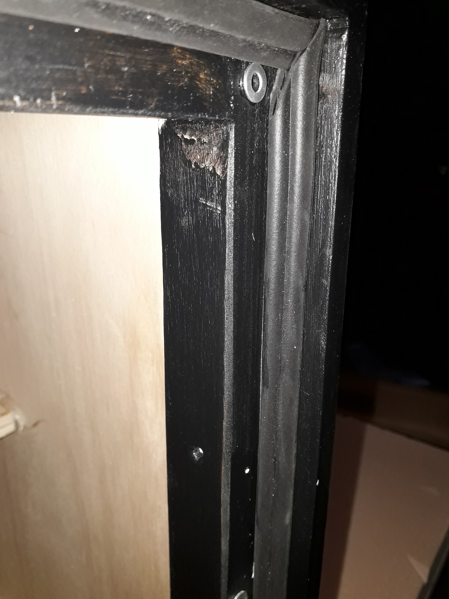

I also glue washers to avoid to stamp to seal screwing the panel on the main case
Picture of the main case with insulation (you can see the connector to connect the circuit to the tweeters)

Here the scheme of what I have done (it is what I understand from the explanations :" . If the array sounds overly bright place the 4 ohm resistor between the jack connection and the 5.6uF capacitor, which reduces sensitivity by 2dB"
In fact the switch is a 3 way one. First position full Tweeter (4ohm resistor is shunted) ; midle position all tweeters off ; second position tweeter -2dB.
The difference between the 3 positions can be really heard (with normal music, I cannot see any diffrence playing bass even slapping on the D string)

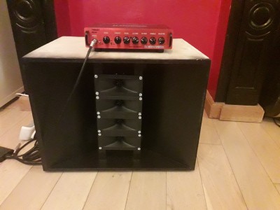

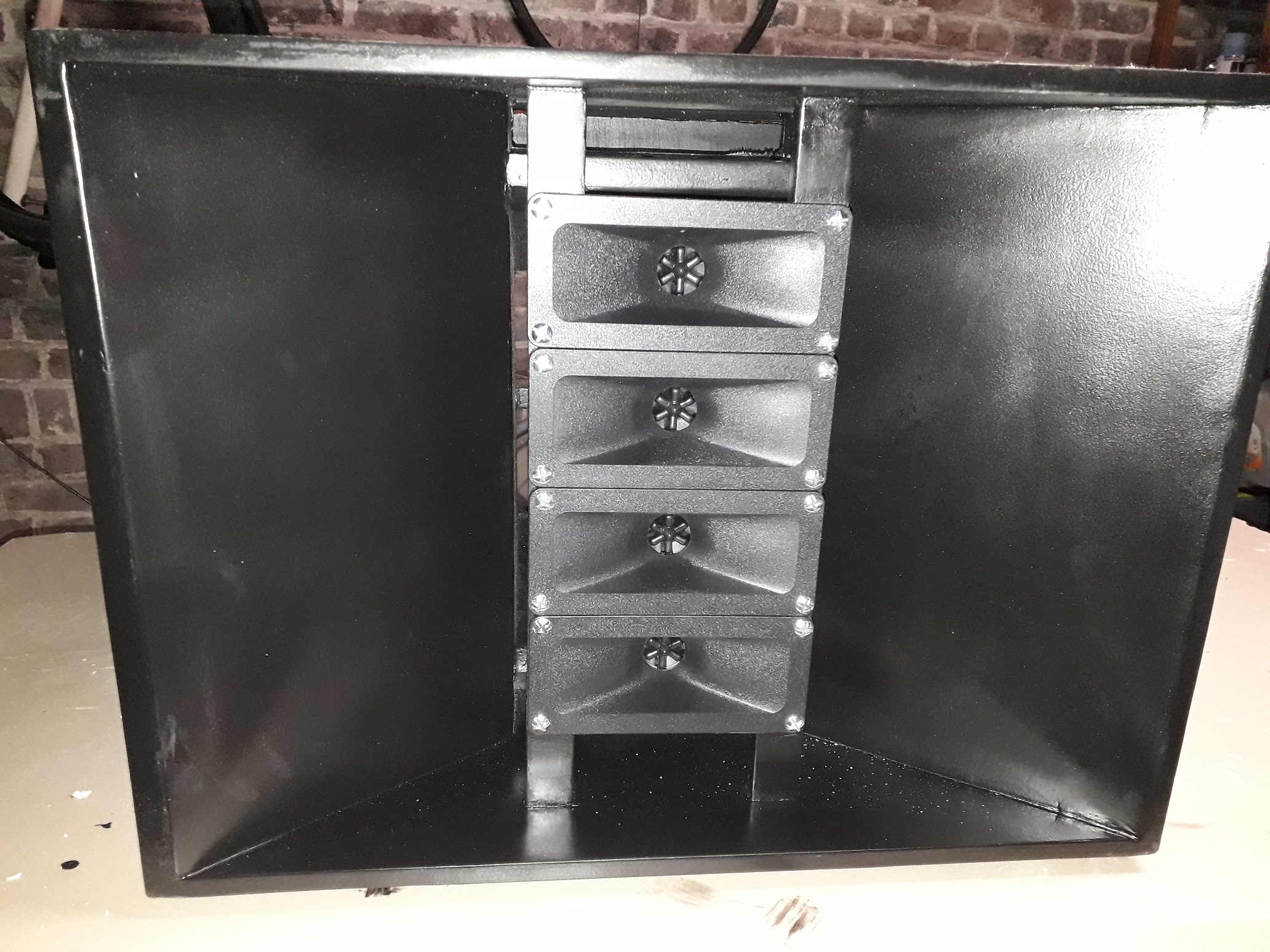

I finalize the jack
As said before I use marpple wood sheet then I had corners and handle
https://nsm09.casimages.com/img/2021/11 ... 651298.jpg
https://nsm09.casimages.com/img/2021/11 ... 651302.jpg
https://nsm09.casimages.com/img/2021/11 ... 651301.jpg
Regarding the sound. I was very surprised. The sound is very neutral it gives you back the sound of the source (if the source is bad or unbalanced the jack will give it to you as it is) . First I thought "there is no bass" but when I adjust the balance to the low and push the volume it seems to have no limit. So I am really happy of it now !
