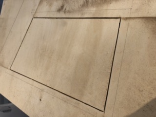

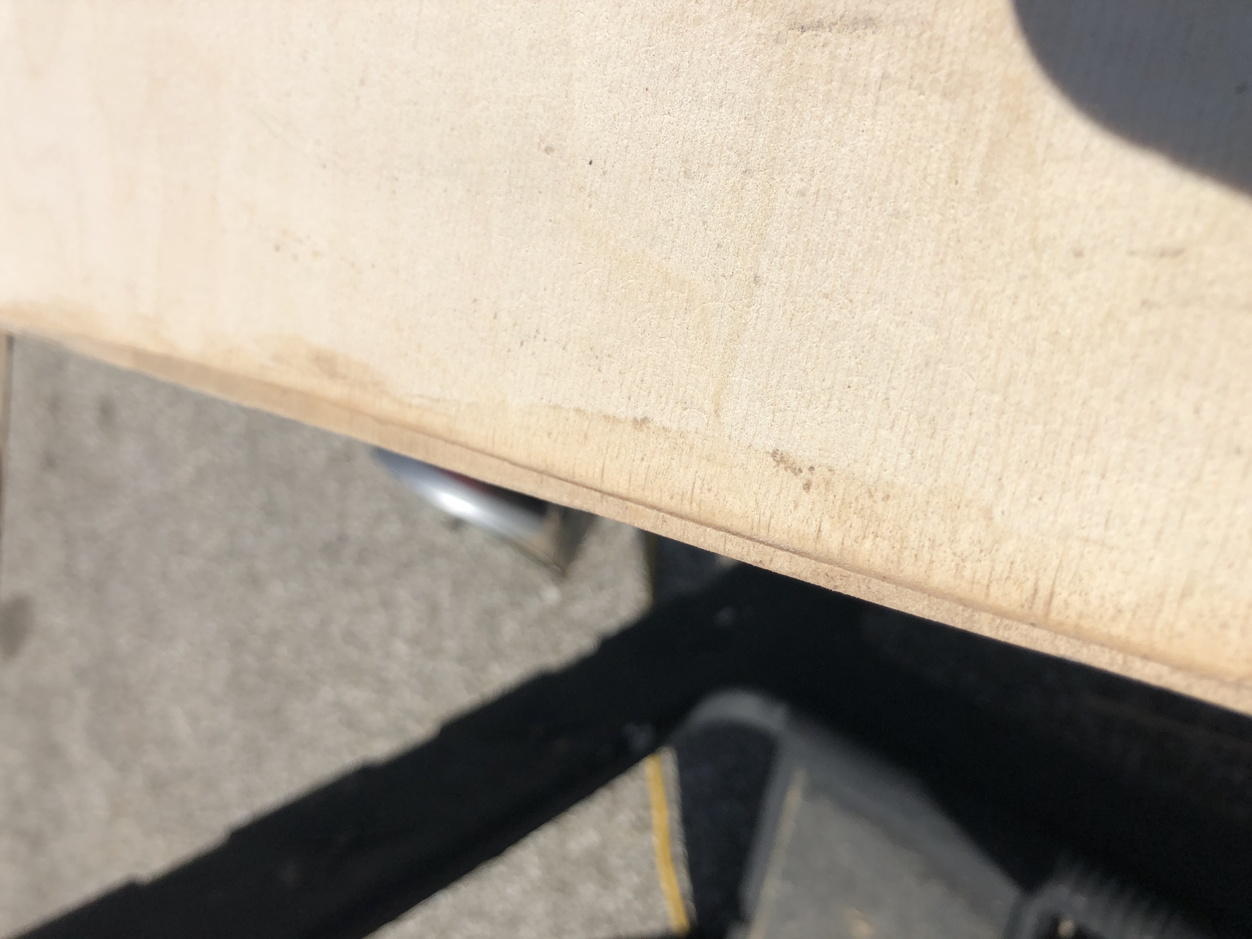

Well crud Rich, Bill. Good advice a little too late. Oh well, access holes are cut on the initial sides. I remembered hating that step first time around - no different to start this time. Clamped down my jig and went to do the first cut, and of course it decided to wander on me. Probably due to my cheesy circular saw that doesn't have a super sturdy frame, as well as doing the plunge to full depth to start. Got my bearings and the rest of the cuts went fine. I'd only drop the blade a bit at a time and make repeated passes. Much better. Brand new 150t blade was already burning the wood. Baltic is pretty stout stuff. One thing I did different this time was to drill tiny holes through at the corners, then trace the outline on the outside, since the undersides of the cuts can be a little jagged. Worked fine. I knew that warbly first cut would drive me nuts down the road, so I dug up a strip of 1/2" from the scrap pile and glued it to the side. Will go back and trim that cut again so it looks straight, as well as straighten up the matching edge on the access panel. Annoyed enough with myself to call it a day...

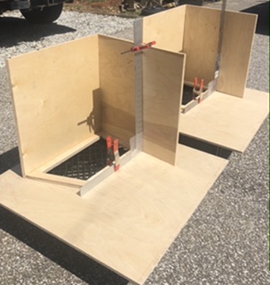

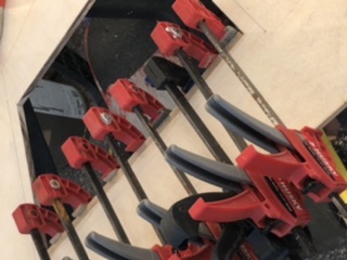

Couple photos...

Should be good enough that a little filler and duratex can camouflage my oops fairly well.

I don't see the "oops".
- Posts: 8664
Re: Things that go boom
Oh wait, now I do....
himhimself
- Posts: 645
Well, if it took two looks for you Bruce, I'm considering it a success.
Got the flanges installed today. Was going to do the one-piece version, but that sure wastes a bunch of wood. Since I have tons of 6-ply 5/16" baltic (~8" wide pieces, 2-4' long), I ripped 1 1/4" strips, then did a two-layer flange, alternating which sides were the long ones. All glued up, basically gives me a 12-layer 5/8" flange which should be really sturdy. And will give me alignment help when the first inner panels go on.
That will completely vanish with a little filler and sandpaper.

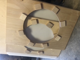

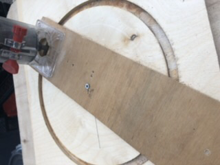

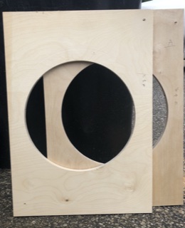

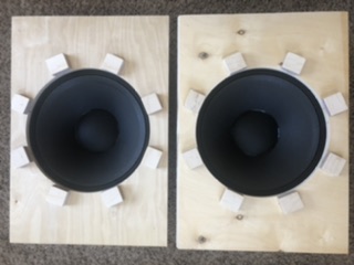

Slowly moving forward. Made this cheesy hole cutting jig ages ago for some random project. Figured I would make a nice one or buy one at some point, yet here I am still making perfect circles with the original. Both driver holes cut out - 10 15/16 for the 3012lf’s.

Driver screw retention blocks glued up last night. Will try to test fit the drivers and maybe start panel assembly today.

Hmm, photo didn’t attach to previous post...
