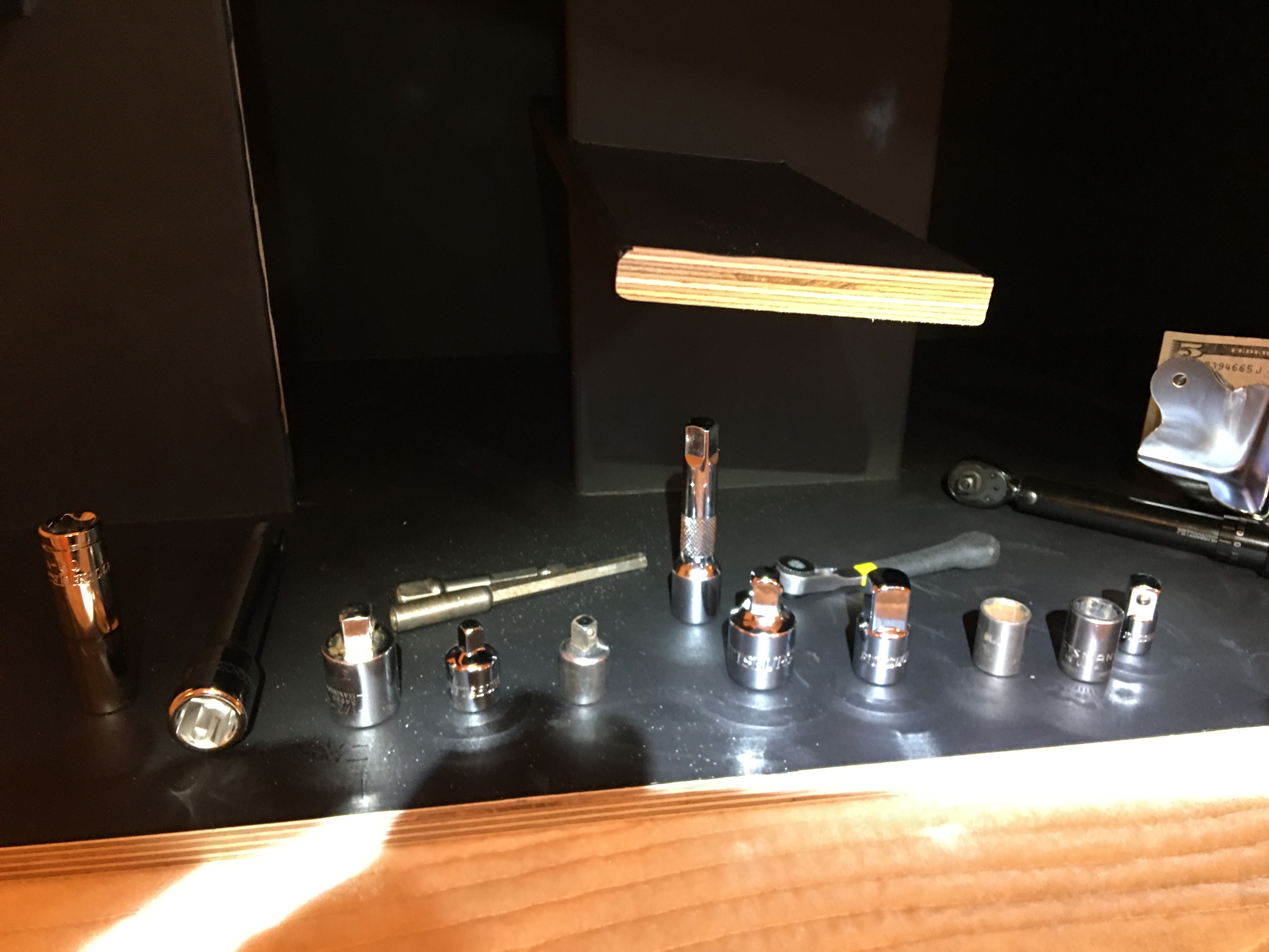

Good thing I have a arsenal of socket adapters

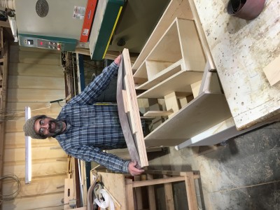

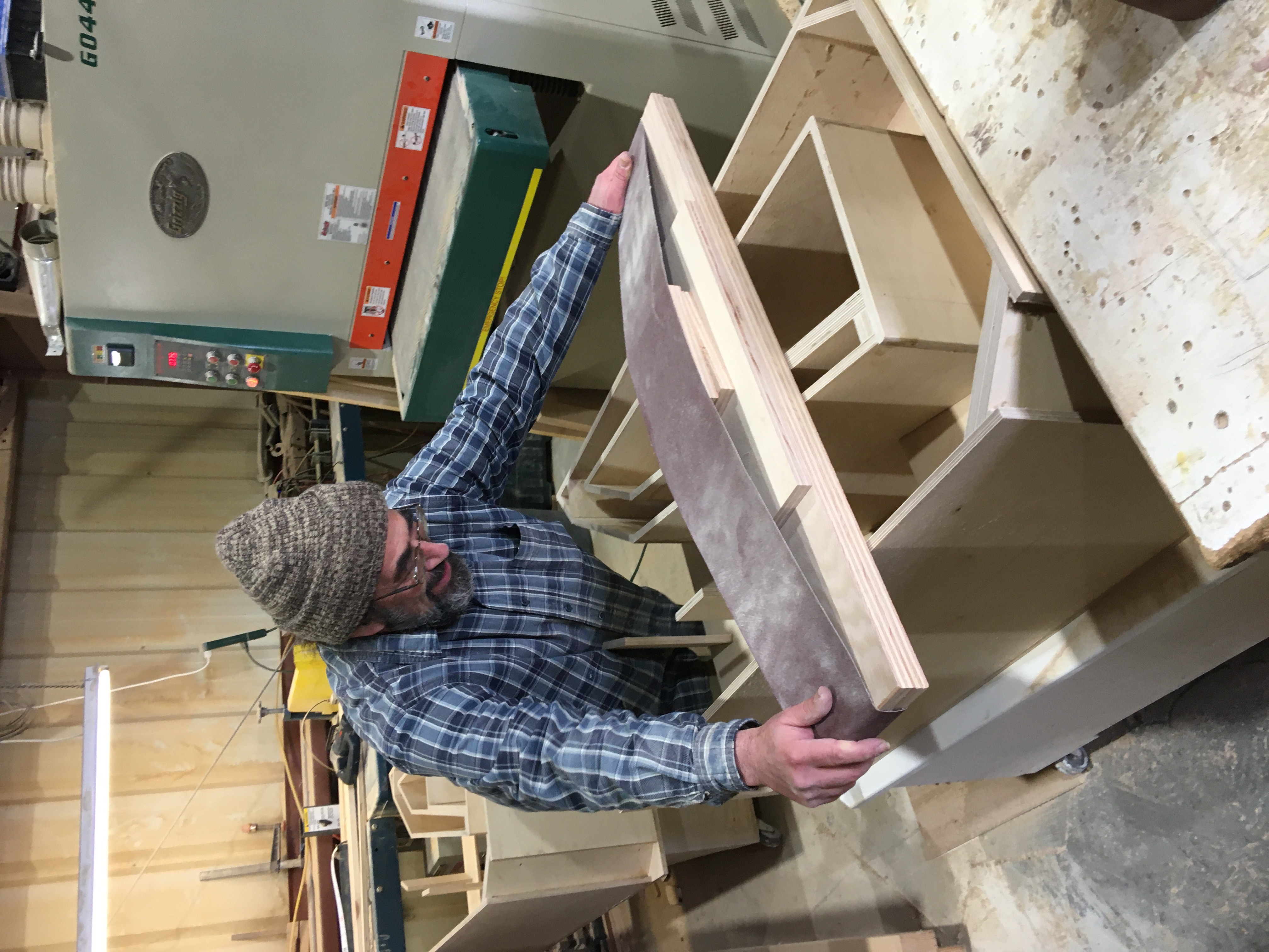

Rob planing the panels to a perfect flat
