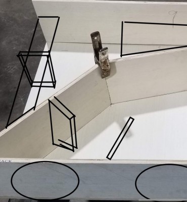

As to the brace location yeah we made some changes for aesthetics and they might have bit us in the butt a little as you point out.
I was worried after looking at the pictures this morning that the space in that corner between 1 and 7 is too far unsupported, even though the compass showed other wise. A simple solution is a dead man behind 7 perpendicular to the face so it backs up resonance of panel 7 and supports the sides better.
Pardon the crappy paint cad, I don't have any CAD programs on this PC.
He really wants to get going on the Jack 112 Lite though.

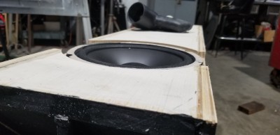

Re: Dual 8" Truck Tuba
You'll be making noise in no time! Looking really good Carter
May wanna sand the edge of that mouth cross brace down to wood before gluing the other side on. Give the PL some wood to bond to.
Good eye Seth I can't get anything by you HAHA.
That brace has masking tape on it covered by the paint. Luckily my son caught that we hadn't removed the tape before gluing and peeled it off.

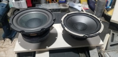

More pics.
Ill have to sit down and write a review with the old
RadioShack woofers, I am really impressed...

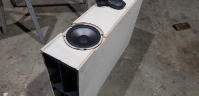

Dang - dang - orangutan... that came out really nice!
I like how you cut that recess in there, where it meets the edge. Nice-n-clean. Great solution. Fantastic custom look that adds to the curb appeal, a lot!
By all means, do tell. How does it sound? How about compared to to that other one you had the pair of drivers in? What are you powering it with? Video?
My crappy break time review...

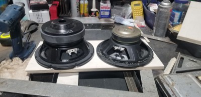

It is LOUD. You saw the pix of the woofers, they are not the correct drivers period so I am not basing my thoughts of the cabinet on the drivers more evaluating the drivers from this Tuba cab to the bass reflex cab they were in.
In the reflex cab they had close to zero output, I never understood it but they were very quit. No visible excursion really. When my son found them still in the 10" PVC pipe tube cylinder they where mounted in he wanted to play them. So we hooked them up to the same amp they are on on now, a old Realistic 100w PA amp in my shop. He quickly agreed they sucked and weren't worth messing with, back on the shelf they went.
In the Tuba, they are loud. MY shop has two BR-1 bookshelf's from PE and a cheap ported 12" HT sub with a gutted plate amp running on the same Realistic 100w PA amp. This 7.5" wide truck tuba with the single 8" "ultimate" woofer outruns them by a large margin and is easily double the output of the 12".
Playing Texas Country on it you really can't get much over 5-10 watts on the analog meter before it is outrunning the tops.
Playing sweeps it rattles most all sheet metal items in the 30'x40' shop, roof tin, very large Snap On tool box, metal shelves etc.
The new subs are supposed to arrive tomorrow from Newark but I am apprehensive about putting two in there.
I think I will go ahead and cut the second hole like the first but cut a corresponding plywood plug to seal the hole, then if this box ends up in another application it will be ready for the second driver .

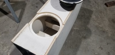

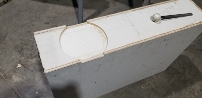

And thanks! The cab isn't finished by a long shot, still need to flush trim then round over (should have flushed it first).Seth wrote: ↑Sun Dec 20, 2020 3:10 pm Dang - dang - orangutan... that came out really nice!I like how you cut that recess in there, where it meets the edge. Nice-n-clean. Great solution. Fantastic custom look that adds to the curb appeal, a lot!
We were itching to hear some progress so we knocked a hole in it real quick. IF you try this method do the flush cutting first because the differences in panel heights made it really tricky to get the router depth set correctly to make a smooth trim through the PL+ and the outer ply.
I had to fudge around with the depth and be really careful but we got it smooth enough for the weatherstripping to seal.
I am thinking another piece of ply cut similarly and some expanded metal will make a bullet proof grill. We will see.

Drivers arrived early, Brown Santa is killing it!

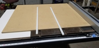

I got started on the saw sled, it was meant to be because looking in my UHMW stock I found a 7"x48"x3/8" piece. It was super easy to run it through the table saw and get the runners needed. a piece of 1/2" MDF will be the base and some 2x4 oak runners from a pallet will be the front and rear fences. The runners still have to be harvested from the pallet, nails removed and straightened for fence duty. I am pretty excited about it though. I might glue up some 3/4" plywood for the fences though if the pallet runners don't work out.
I look at your woofer pics and I think "hefty, hefty hefty, wimpy, wimpy, wimpy" LOL

I did finish the table saw sled and it is awesome!
I really don't know how I ever tried to use the saw with out it for cross cutting.
