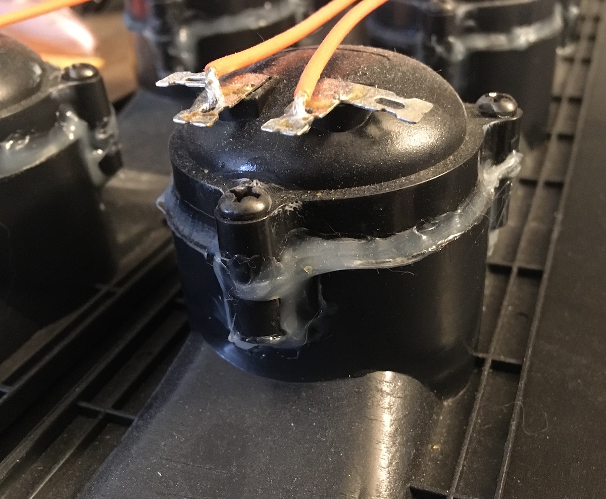

Bruce, FWIW I used this sealant from Home Depot to seal up the rear chambers of my tweeter assemblies. Most general-purpose silicone types don't bond well to ABS.

Radian wrote: Sat Nov 21, 2020 2:28 pm Bruce, FWIW I used this sealant from Home Depot to seal up the rear chambers of my tweeter assemblies. Most general-purpose silicone types don't bond well to ABS.
I've never sealed around edges like that..... what's the reason for doing that?

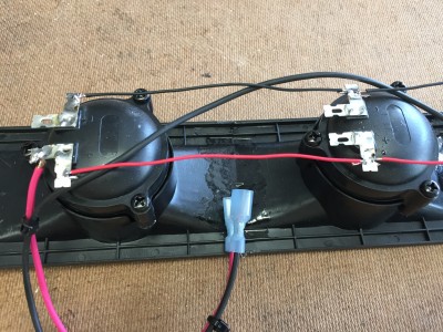

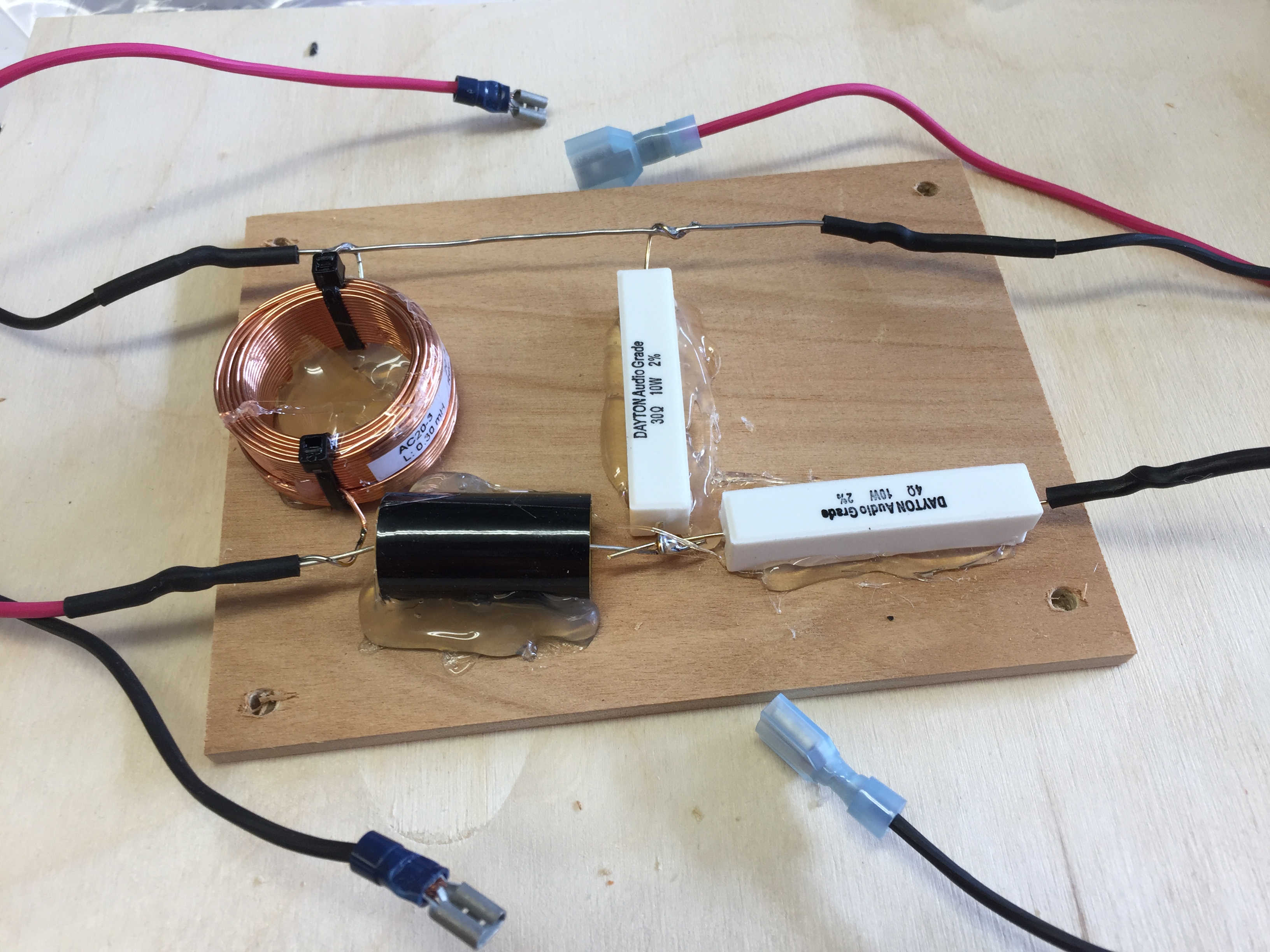

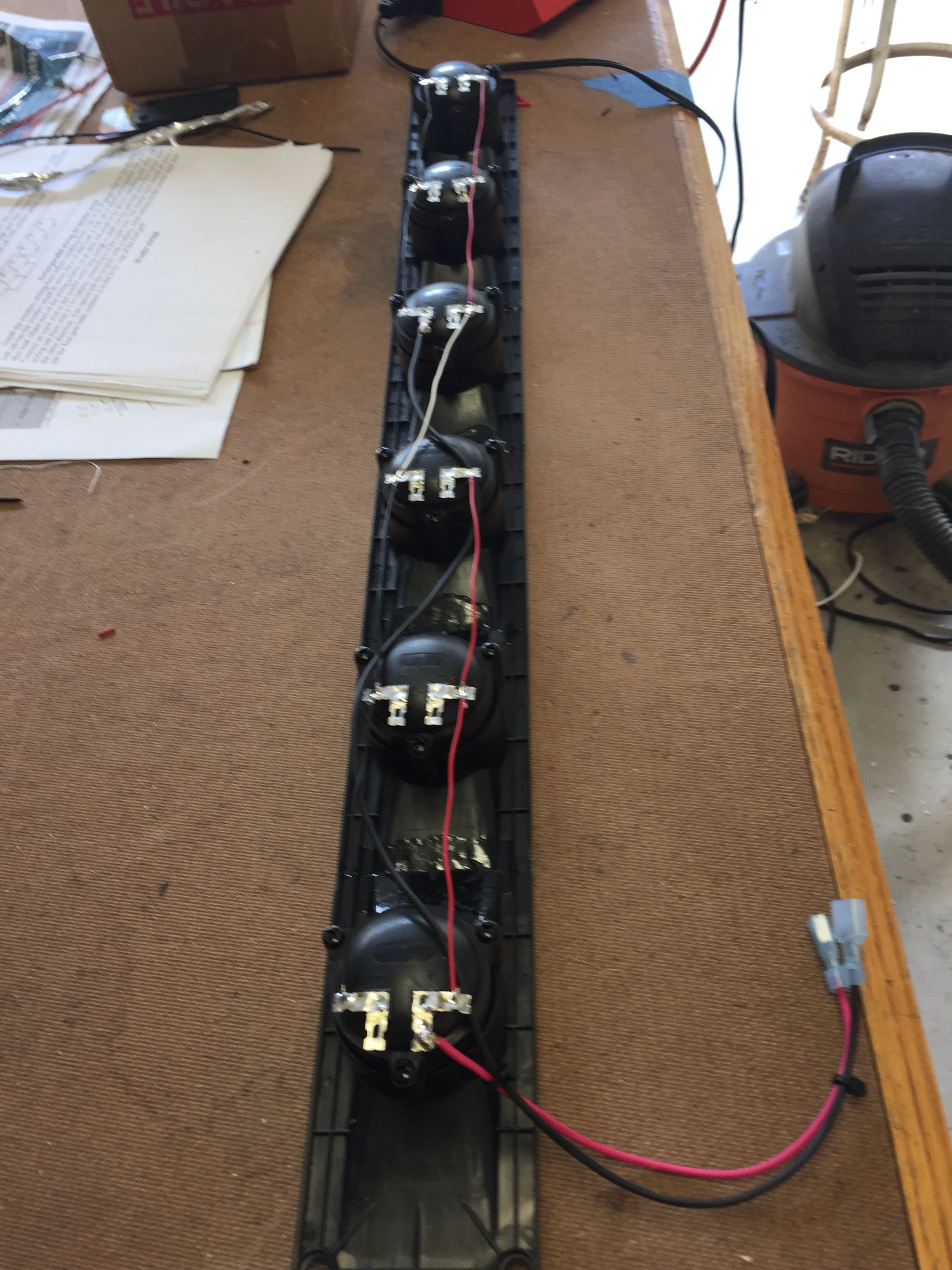

Got some wiring out of the way.....
I don't worry much about aesthetics when it comes to crossover that are hidden. Lots of hot glue, but not zip ties as this will sit on the bottom panel....should be fine.
Wired up the tweeter array.
Nothing left to do until I get a final yes or no on whether I can use the Dayton amp....well, and wait for the drivers to come in - and who knows when that will be. I had no idea that driver was so popular.

Bruce Weldy wrote: Sun Nov 22, 2020 9:48 am I've never sealed around edges like that..... what's the reason for doing that?
Peace of mind. To avoid the chance of any air leaking past the fitment between the phase plugs and horn lenses.
