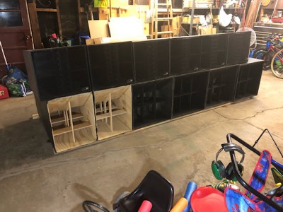

Whatcha think fellas, how much can we shrink this 😄

J_Dunavin wrote: Sun Jul 26, 2020 11:18 pm Whatcha think fellas, how much can we shrink this 😄
That's pretty bad ass :metal:
Another question you may consider is; how can we grow your audience to necessitate all that awesomeness? !!
