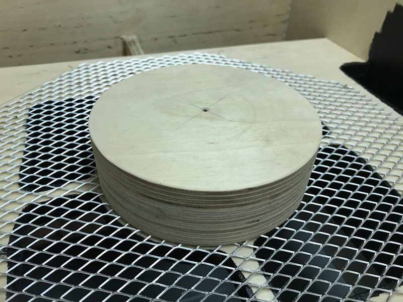

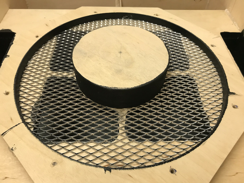

Is it safe to just glue the phase plug.or do I screw it to the baffle to be sure?
Posts: 8678
Re: New Jack 112 build
#27 Post by Bruce Weldy »
Rickyvt wrote: Sat Jul 11, 2020 10:41 am Is it safe to just glue the phase plug.or do I screw it to the baffle to be sure?
I screwed it on just so I wouldn't have to futz with lining it up with the glue slipping all over the place. That lines it up correctly while the glues dries and you can just leave the screws in since they can be seen.
Rickyvt
Posts: 144
Joined: Tue Jun 19, 2012 5:11 am
Location: Antwerp, Belgium
#28 Post by Rickyvt »
Glued three 5” discs together first, painted the sides and glued it to the baffle. I’ll use one screw in the center to be sure but I got a feeling it is not really necessary. Haven’t tried it but I think I can lift the cab by the phase plug. Speaking of which, never investigated the reason for a phase plug. It seems that a lot of (commercial) cabs don’t have one...
