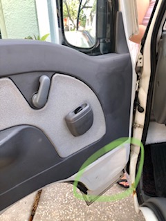

Here is what I will be dealing with. This car needs a serious detail. So between that and the overkill car audio project that should keep me busy for the covid-19 doldrums. I'll just leave the factory 4x6s alone.
I al looking at the lower door area, which concave into a triangular shape. It's bare sheet metal. Haven't taken off door panels to see what's going on but the doors seem reasonably solid. With the WRX, taming the plastic throughout the car was the biggest challenge. I am thinking a plywood baffle and a hole, unless I can find a pod or something that fits.

PRV is Brazilian, pretty good stuff. Those midbasses look good, but I wouldn't take them higher than 3.5kHz, above that dispersion would be too narrow. High priced drivers make no sense. You're in a car, not Carnegie Hall.
