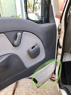

Stick them in the doors. Doors work like lossy sealed boxes, so low Q drivers don't work as well as higher Q drivers. Q between 0.5 and 1.0 will give the best results. Low Fs comes at the cost of sensitivity, so there 60-120Hz is best.

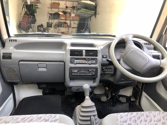

Here is what I will be dealing with. This car needs a serious detail. So between that and the overkill car audio project that should keep me busy for the covid-19 doldrums. I'll just leave the factory 4x6s alone.
I al looking at the lower door area, which concave into a triangular shape. It's bare sheet metal. Haven't taken off door panels to see what's going on but the doors seem reasonably solid. With the WRX, taming the plastic throughout the car was the biggest challenge. I am thinking a plywood baffle and a hole, unless I can find a pod or something that fits.

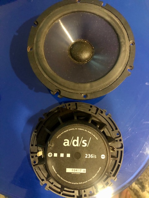

o.k. The UM8 is ordered. I found some 6.5" that have been sitting on shelf for at least 10 years.
Anyone remember a/d/s? I'll try these first since they are there.

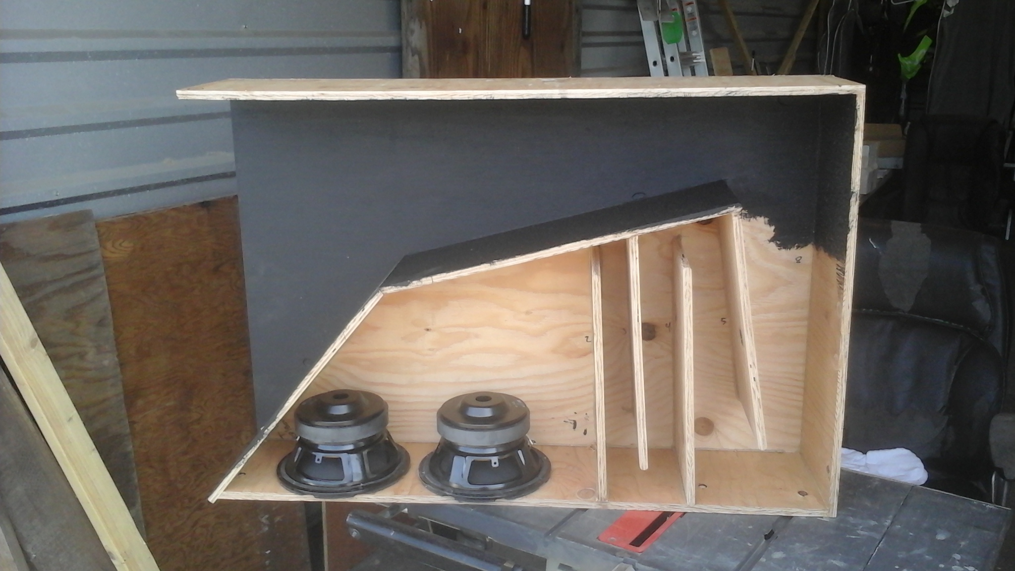

Bill, what would the minimum width need to be to load a TruckTuba with 2 MCM 8's? I'm building mine 8.5" wide, 7.5" panels. It looks like I can easily fit 2, side-by-side, surface mounted in panel 1. I've been sitting on 4 spare drivers since 2009 and It'd be great to put them to use instead of collecting (more) dust.

That width will work.

Make sure there's enough bracing in the driver compartment to handle the pressure from two drivers.

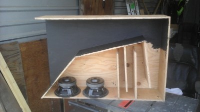

Figured I'd add to this thread too. I did add extra bracing per Bills instruction... I added a 6/9 brace, 7/9 brace, cross mouth brace, and gusseted between the drivers with a strip of ply about 3" wide, anchoring the middle of panel 1 into the sides.
Here it is completed.
