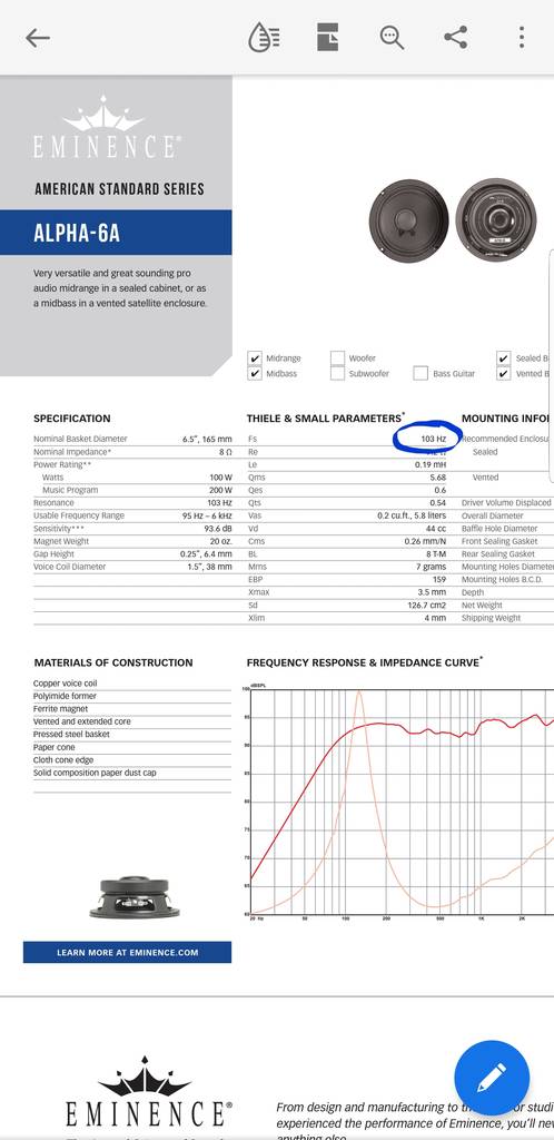

In the SLA Pro plans it says the recommended driver is the Eminence Alpha-6 with an Fs of 118 hz. But none of the Alpha-6's available have that Fs. The Alpha-6A has an Fs of 103 but the rest of the parameters are the same. Is this a typo or is there another driver I'm missing? The drivers I saw were the Alpha-6A, Alpha-6C, and Alphalite-6.

My Eminence data sheet for the Alpha 6A has Fs listed as 118Hz. If the current spec sheet says 103Hz they've changed it, for the better.

Latest Alpha-6A spec sheet says 103 Hz. Good for us. And at $54.99 I think they're reasonably priced.

I was wondering, if the resonant freq of the Alpha-6A is 15 Hz lower than it used to be, does it have any effect on box tuning or port size?
Posts: 29054
Re: Found a typo
It doesn't. It was tuned to 95Hz already, so the lower Fs isn't a problem.
