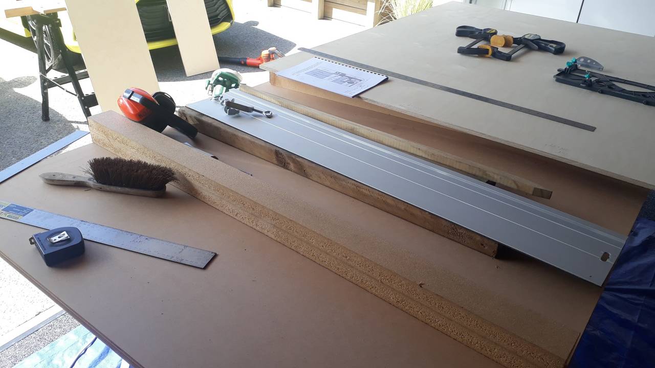

Re: NEW BUILD - Omni 15 Tall Boy in New Zealnd
Hi TallEvan,
3)
Trimming it on a table saw.. Whew..
Yep. I don't have a table saw; just a 7 1/4 skill saw & aluminium sled. So I'm conscious of me fingers tips!!
As the four mouth parts are less than a 90o angle, clamping a sled for the final trim cuts will be a problematic to resolve.
Trust Bill when he says not to take off too much at a time.
Start with a long sdge, and visualise how much you are taking off, including your saw kerf. Watch your fingers.
Then do the opposite side. Will do.
At this point, with two sides left to trim I found it useful to rest the trimmed edges on a piece of scrap, so when you trim the third edge the whole thing doesn't tilt over into the spinning blade.
I like your idea of providing more support arouns the internal side of the cuts.
Thanks

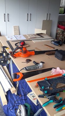

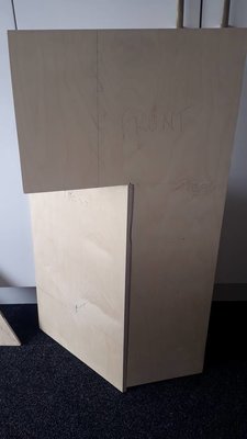

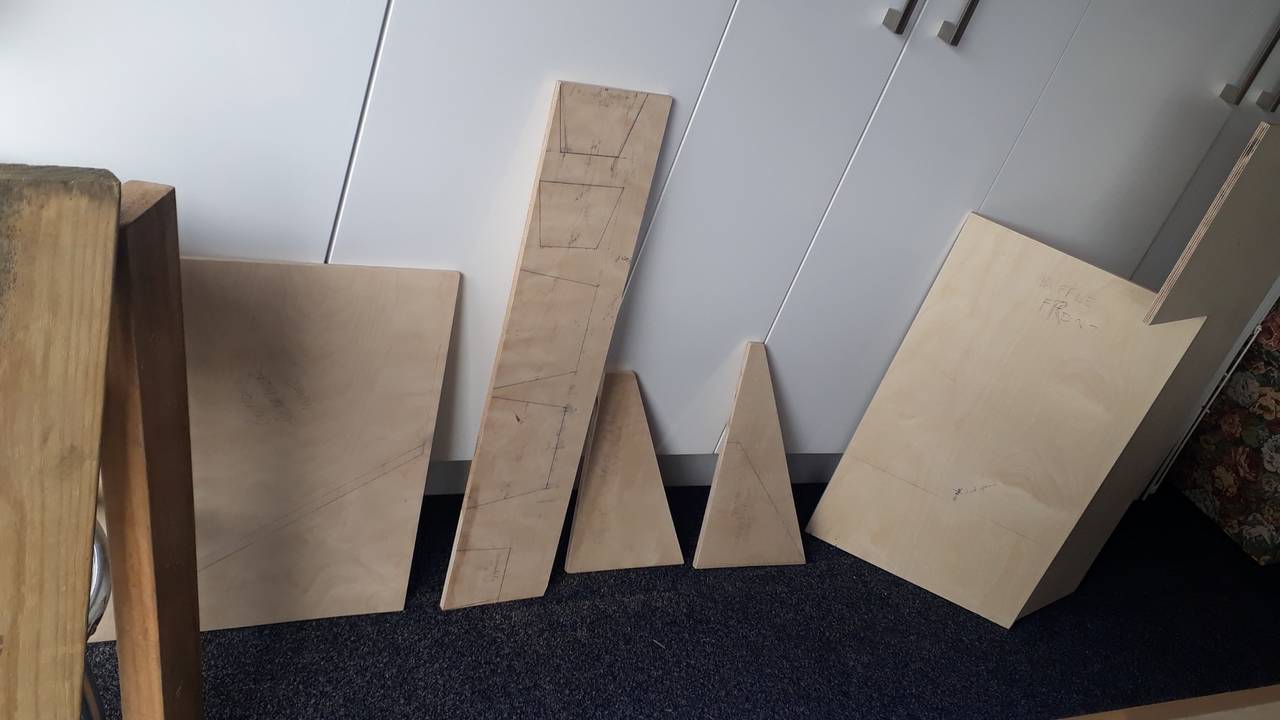

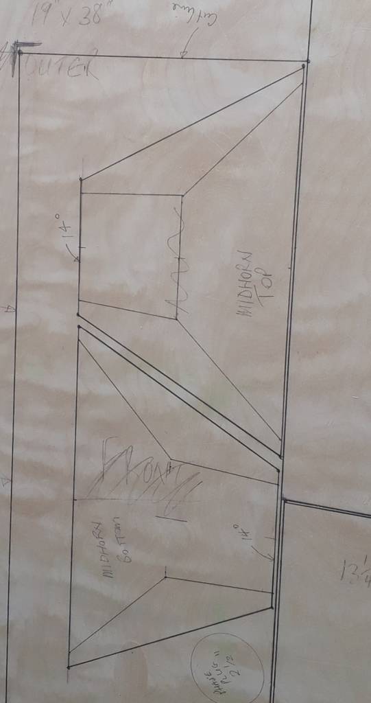

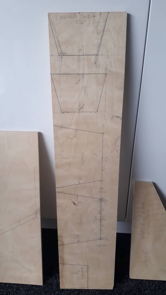

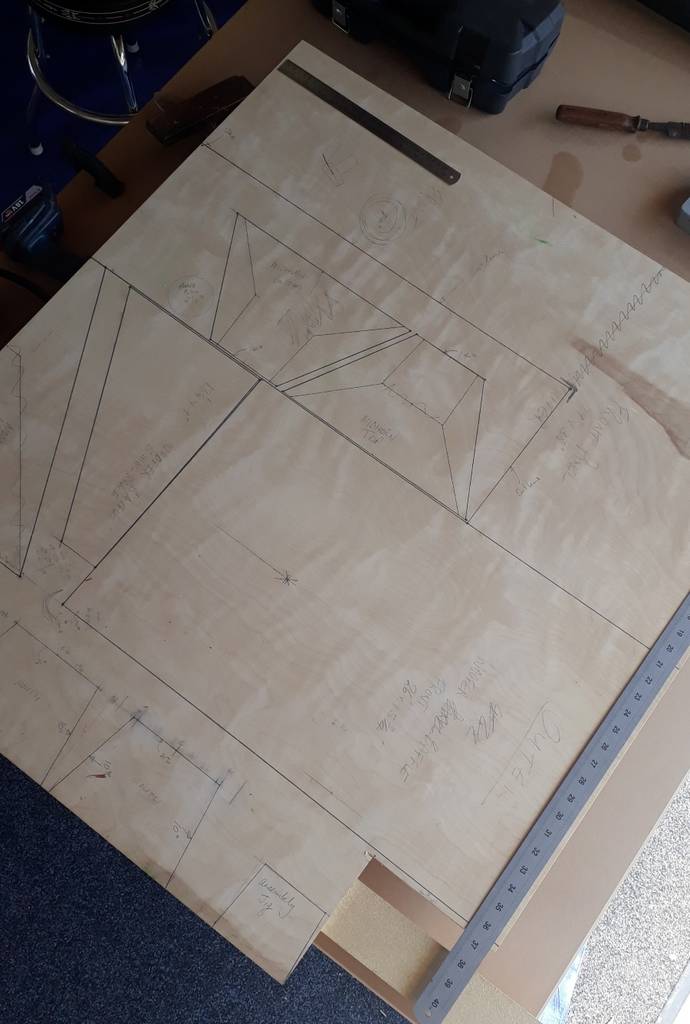

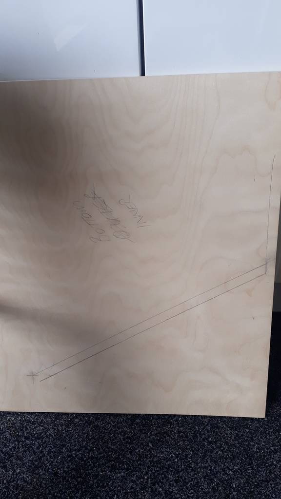

Photo's Re: NEW BUILD - Omni 15 Tall Boy in New Zealand
Afternoon All,
First attempt at adding some sample photo's.
Will add more as I progress.
Cheers
Cheers

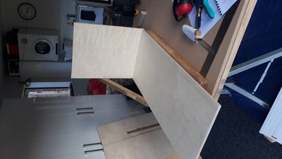

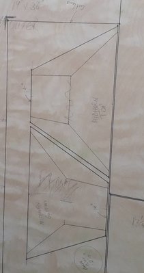

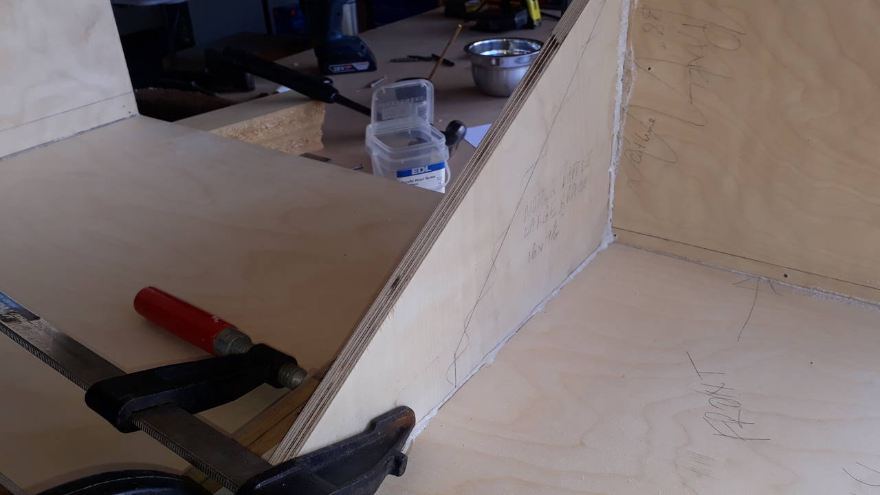

more pics this arvo....
Cutting will proceed only after I get that which I have already cut glued up....wish me luck.
Cheers
Cheers

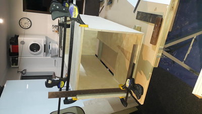

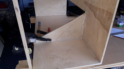

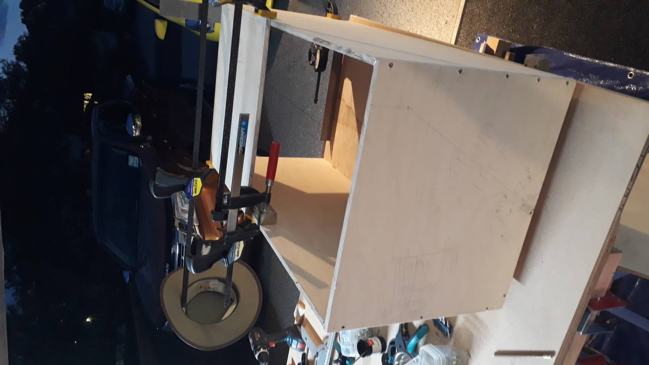

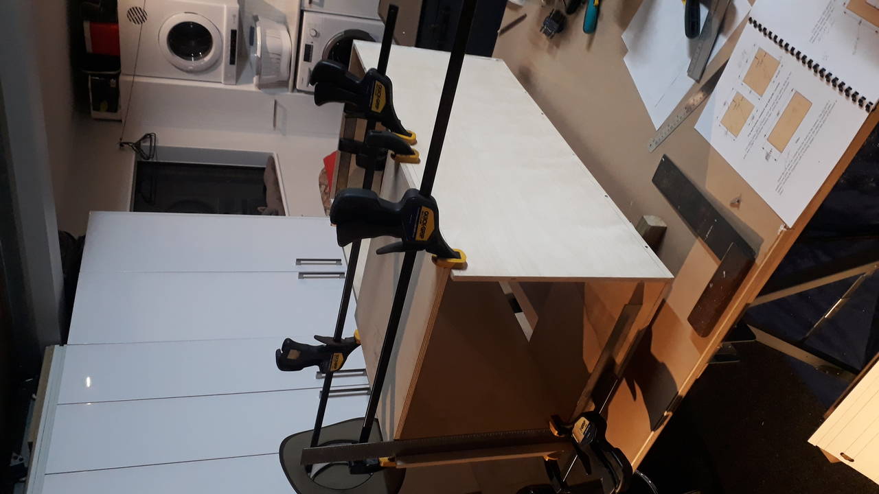

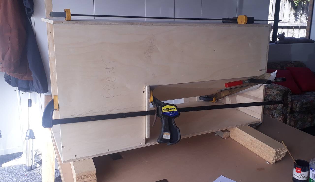

Sunday 12.05.2020 Update - NEW BUILD - Omni 15 Tall Boy in New Zealnd
Morning All,
Well, yesterday was my first gluing day; all went well with only the usual minor panics and concerns as I progressed.
No matter how much I read the plans & thought I had intelligently planned for each step I was about to attempt, each stage really only fully revealed itself as I proceeded to act. Funny that!
Sometimes I've found your hands control your brains and resolve questions; rather than the other way around?? Or perhaps, it's our subconscious saying to us "David, don't be a silly prick, do it this way!!" Wierd that.
Anyways, new pics being going up below
Question - do you need to remove the holding screws after the glue has set when routing for a quarter round effect??
Cheers All
By the way, Happy Easter everyone and you and your families keep safe out there.
Cheers All
Aarrrhhhh all pics in Landscape. Apols, need to remember that one.....
If the screw is anywhere near the edge, then yes - remove it. Otherwise, you'll be buying new router bits. I always removed all of the screws from my builds......with the smaller cabs (non-subs) I typically use only brads.
To add to Bruce's comment; yes, remove all exterior screws after glue is dry or use a few screws to line up the panel then brad nail it. Then you can remove the screws for a "fastener free" build. I use cheap round-over bits when I gotta cut through brads. What glue are you using?

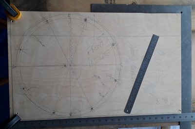

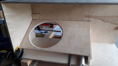

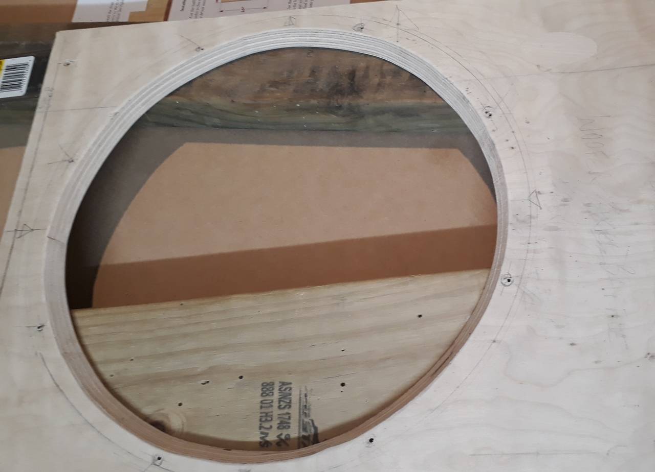

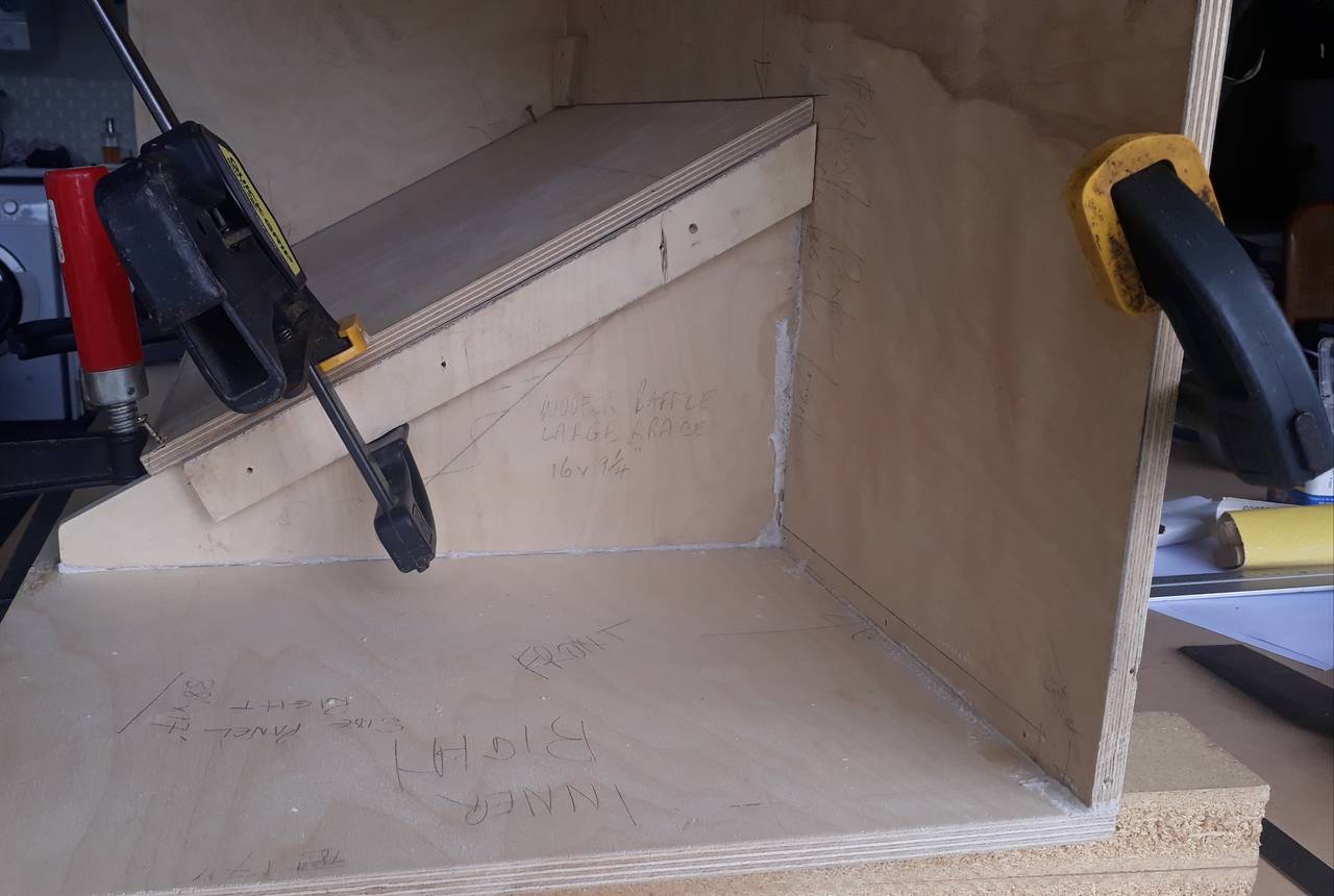

UPDATE 3 Re: NEW BUILD - Omni 15 Tall Boy in New Zealnd
Afternoon All,
1. no screwings to be left in the build - noted;
2. Glue is Gorilla Grip expanding construction adhesive - 1 hour cure; got four tubes. Substrate needs wetting prior. Sticks like s..t to clay. I'm putting lots into each joint; ensures that it squeezes out both sides and fills every gap;
3. About to cut the speaker hole. I haven't got any hurricane / T nuts etc. yet coz all our D.I.Y. / Bunnings / home depot type businesses are shut under our compulsory country-wide / business closure regulations (except for essential services};
4. I'll remove my K3015LF from its current cabinet, measure up and trust it all goes OK.
Thinking about it, I may do a straight 90 degree cut rather than the relief angling inwards, for safety. That means I could use heavy screws, as I've used in the past, to tighten things up.
5. Primary baffle brace now installed as per pics.
Cheers All
Cheers All

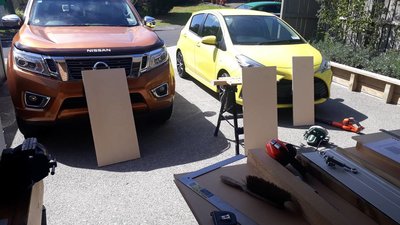

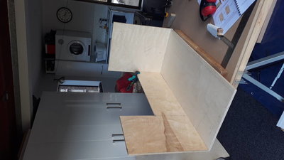

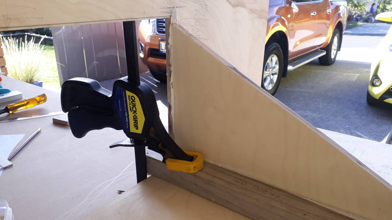

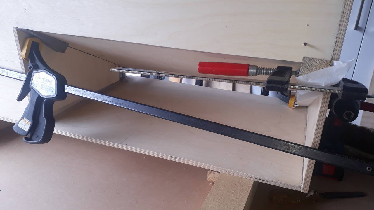

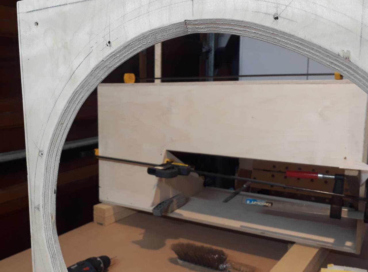

UPDATE 4: NEW BUILD - Omni 15 Tall Boy in New Zealand
Gidday All BFMer's,
Rainy and blustery down here today.
Luckily it's coming from the South West (behind us) so I can keep my garage door open & continue working.
Yesterday was a big day.
Learnings -
1. small errors at the initial cutting stage become magnified at the trial fitting in their final position;
2. this means I have a quarter inch gap where my speaker baffle meets the front panel; between the top of the primary brace & the baffle itself. In effect, I had trimmed the long side too hard and came up short;
3. took me quite a while & various levels of profanity to achieve a work-around fix. There was lots of finagleling to get the front angled edge of the baffle perfectly aligned with its corresponding front panel angle. The pictures tell the story;
4. Baltic ply (even though very expensive) is lovely to work with;
5. I've chosen to go with a 45 degree angled cut on the baffle. Was quite undecided on that until I realised I had no way of getting the recommended bolts and nuts (because of lock-down), couldn't find my heavy wood screws so, am going with quarter inch gutter bolts with both upper & lower spring washers and sharp edged flat washers for bite. Remind me to take a pic of this set up if you want to see it;
6. pic below of my K3015LF looking beautiful assuming its test position;
Cheers everyone.
Learnings -
Cheers everyone.

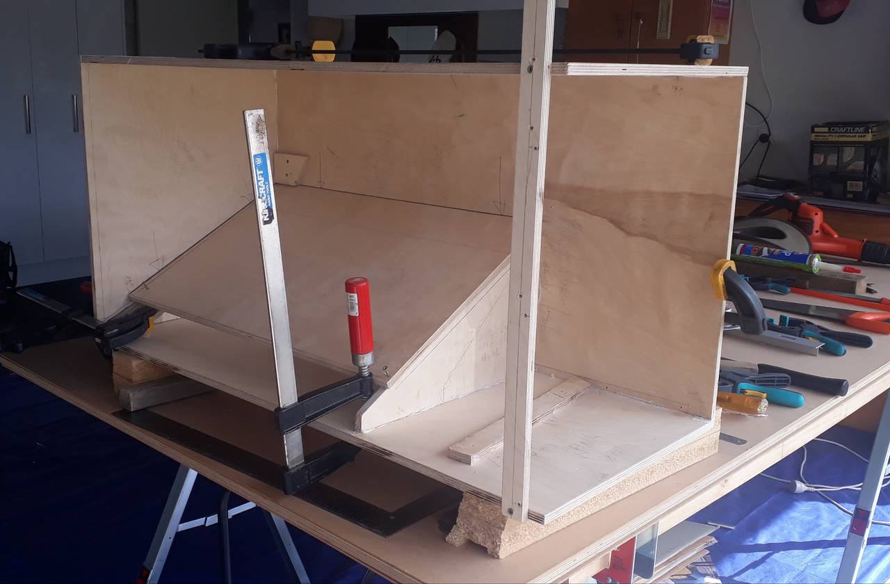

UPDAE FIVE - more pics NEW BUILD - Omni 15 Tall Boy in New Zealnd
More pics
