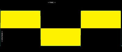

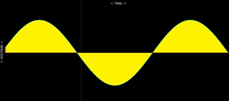

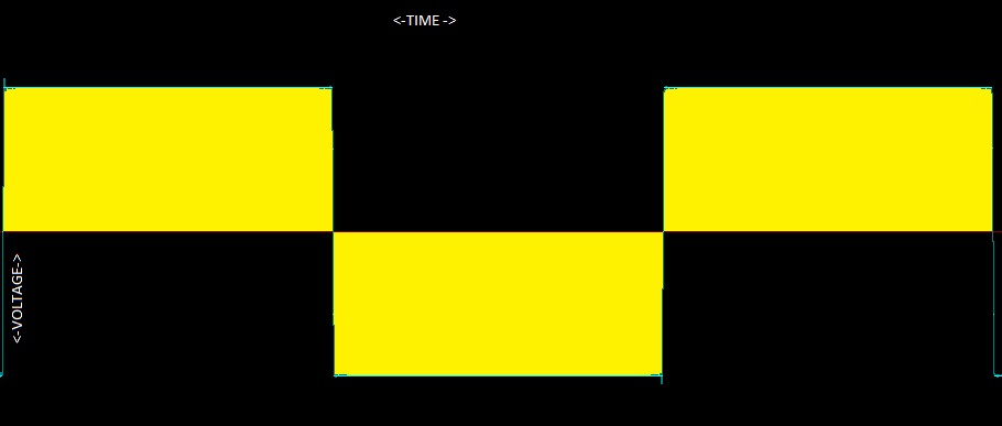

Thermal damage comes from heat. Heat is generated by current, measured in watts. This is why drivers are advertised with a power rating in watts rather than volts.
The excursion limit comes as much from the cabinet as it does from the driver. Excursion is directly correlated to voltage. This is why the same driver can have different excursion limits in different cabinets, and why the voltage limit of some drivers in some cabs doesn't work out to be the same as the thermal limit. For instance, IIRC, the 3012LF is limited to 50v, or 312W (using the DCR of the driver to calculate) in some of the BF cabs, despite having an RMS power rating of 450W. IN that cabinet, At 50V, consuming 312w, the driver reaches its xmax, where in another cabinet, it might not reach xmax until well beyond the RMS power rating.
The thing that is hard for most people to understand is that when you're dealing with the numbers, we have to use Ohm's law to convert between voltage and current, but Ohm's law really only applies to DC circuits and steady state AC circuits When you're dealing with music program content, you have to think deeper about what Ohm's law means. If you calculate the power from voltage with Ohm's law, you are getting getting a result that applies to a sine wave, and on a graph, this result is the area under the curve of the sine wave, as illustrated below.
That's what power in an audio signal is - the area under the waveform. Ohm's law only applies to the voltage at the When you then amplify and clip this signal, you are squaring off the waveform, which means more power. Its easy to see on a graph that the yellow area is larger in the square wave of the same amplitude (voltage).
Bear in mind that on these charts the vertical position of the point on the waveform is correlated to the voltage going to the speaker, and therefore the movement of the speaker. This also speaks to what may have happened to the speaker in question. Because a clipped signal is causing the speaker to move repeatedly and far more quickly from one extreme to the other than a sine or unclipped program signal of equivalent voltage it can cause mechanical stress and tear the cone even if the thermal limits are not technically exceeded. That said, it's extreme damage for something like this, but not impossible.
