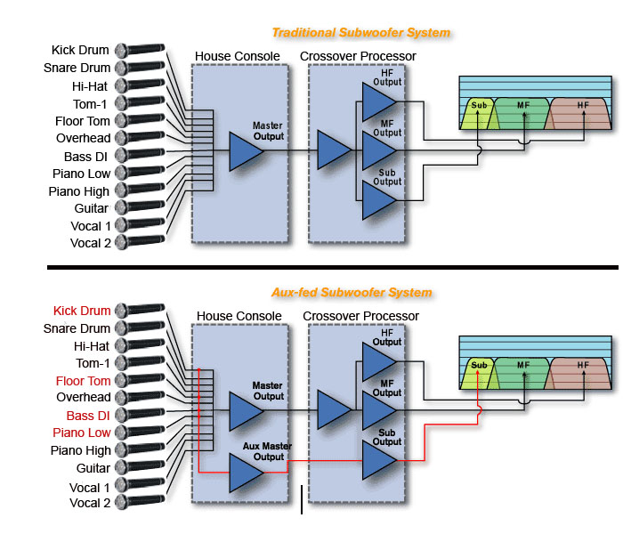

Apart from the above that was mentioned, one thing I do is run aux fed subs. My main mixer outs go to my driverack and only go to my tops. Any channel I want in the subs I set up an aux out and that goes to a third input on my driverack (dbx360) and that then goes to my subs. That allows me to pick and choose which channels gets sub support - usually kick, bass, keys, floor tom and break music. Where this differs from a normal highpass is that a mixers highpass is usually 12 db/octave where by aux fed subs the slope is infinite, if I don't put a channel in the sub aux, nothing from that channel will every make it to the subs. The other way, even if you highpass every channel, with 14 open mics on stage, you will be getting bass from stagewash into the subs as a highpass is a slope, not a cliff.
This also allows me to adjust how much of that channel to feed the subs, if a bass has too much low end I can dial back that channel in the sub aux out rather than use an eq on that channel. I can also adjust the subs overall output from the mixer rather than from the driverack which is useful when you are playing in different venues with different setups.

Your posts are nearly always excellent CO. This one too. While not exactly along the train of thought I was on, you did touch on and re-open some thoughts I've had on Aux Fed Subs. I'll roll them around in the attic for a day or twoCoronaOperator wrote: ↑Sun Sep 08, 2019 3:27 am Apart from the above that was mentioned, one thing I do is run aux fed subs. My main mixer outs go to my driverack and only go to my tops. Any channel I want in the subs I set up an aux out and that goes to a third input on my driverack (dbx360) and that then goes to my subs. That allows me to pick and choose which channels gets sub support - usually kick, bass, keys, floor tom and break music. Where this differs from a normal highpass is that a mixers highpass is usually 12 db/octave where by aux fed subs the slope is infinite, if I don't put a channel in the sub aux, nothing from that channel will every make it to the subs. The other way, even if you highpass every channel, with 14 open mics on stage, you will be getting bass from stagewash into the subs as a highpass is a slope, not a cliff.
